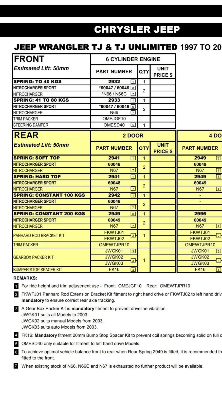

Thanks everyone. I decided to compromise and go with 933 front/942 rear springs. I went back and forth on the 934/949 springs, but think they will be overkill for my intended build. I am hoping it sits fairly level with this setup.
