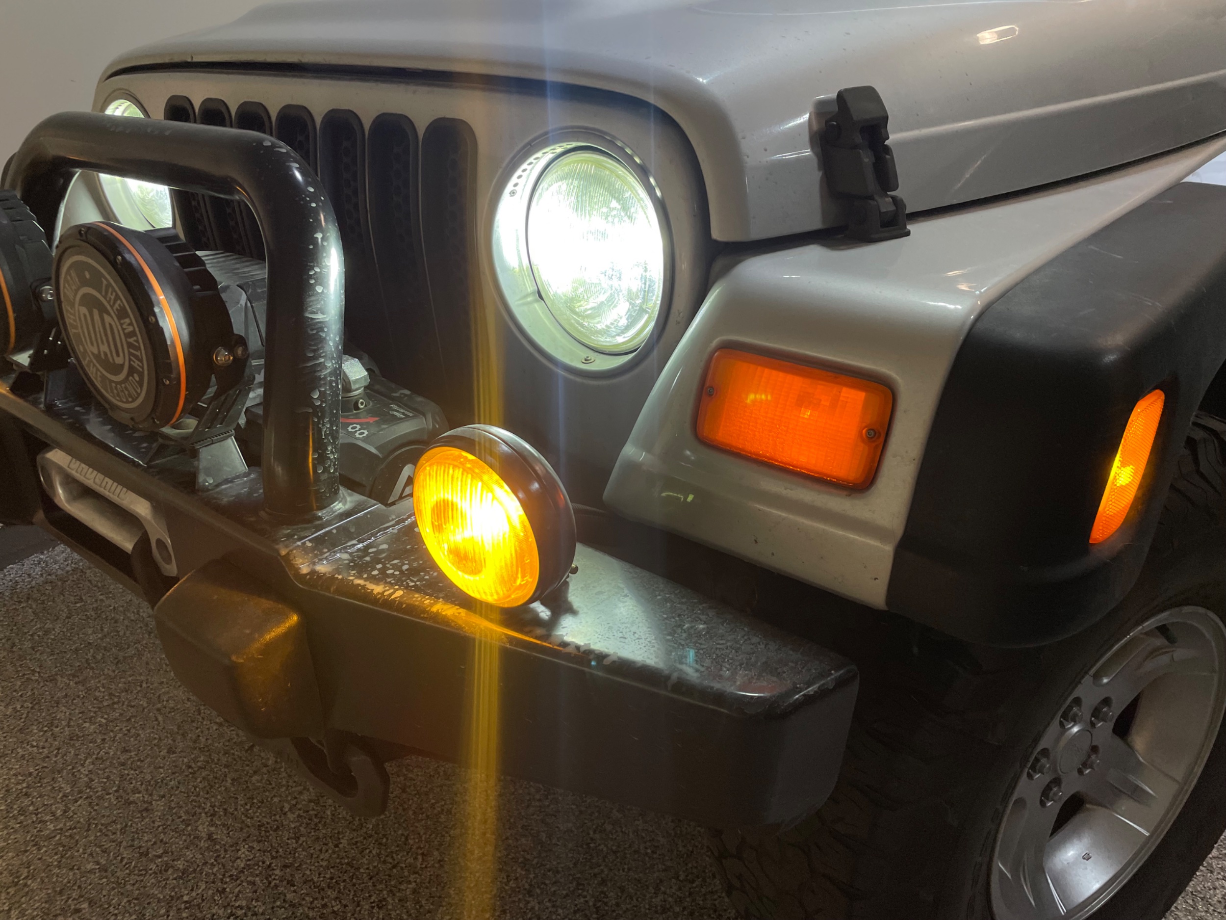

I run E code glass headlamp with LEDs - Auxbeam makes one that does a good job replacing the halogen bulb H4. When you get into higher power LED they begin to throw a little heat…. Not something I would count on in a good blizzard so I keep the standard halogens in my hella fog lights.
That setup looks nice together
