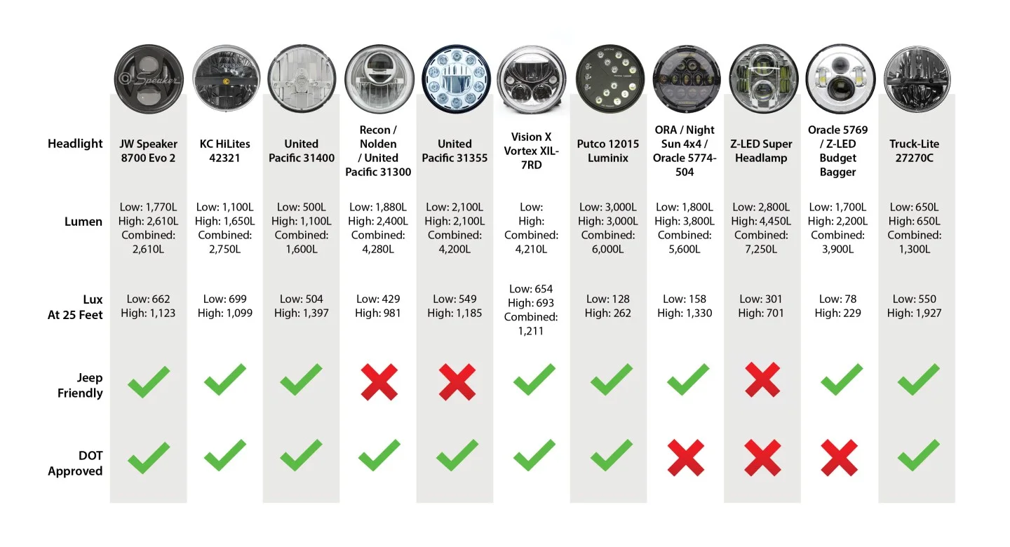

Here's a rating comparison of some of the more popular LED lights for the Jeep Wrangler TJ:

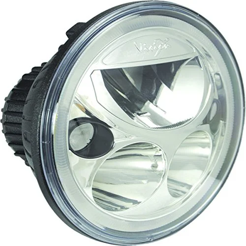

Don't be put off by the outlandish price of these headlights. I switched from my Truck-Lite (27270C) LED Headlights to these things, and I am absolutely blown away by how nice of a headlight this is. If you're one of those people who considers yourself a lighting snob (that's how I am), I assure you that these headlights are the one you want. These things are the cream of the crop. Both the way they look and the way they perform is outstanding. They are made in South Korea and include a lifetime warranty (how many other manufacturers can say that?). The quality of these things is apparent not only by looking at the packaging they come in, but also inspecting the headlights up close. The Vision X Vortex outperforms all the other LED headlights on the market, and looks outstanding while doing it. They offer a halo LED ring, as well as the ability to run both your high beams and low beams at the same time (with the optional Hi4 harness). These headlights easily win my top pick, and if you have the money, then you honestly should consider picking up a set. As far as I am concerned, there is no better light out there than the Vision X Vortex. My Truck Lites were amazing, but these outperform even my Truck Lites! These headlights will work on both JKs and TJs, as they come with adapters for both!​
If you'd like to see my review of the Vortex Vision X headlights, you can find it here: My review of the Vortex Vision X LED Headlights

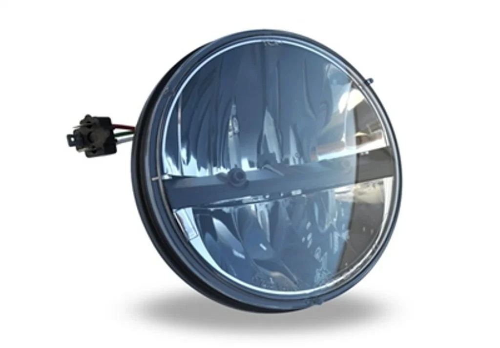

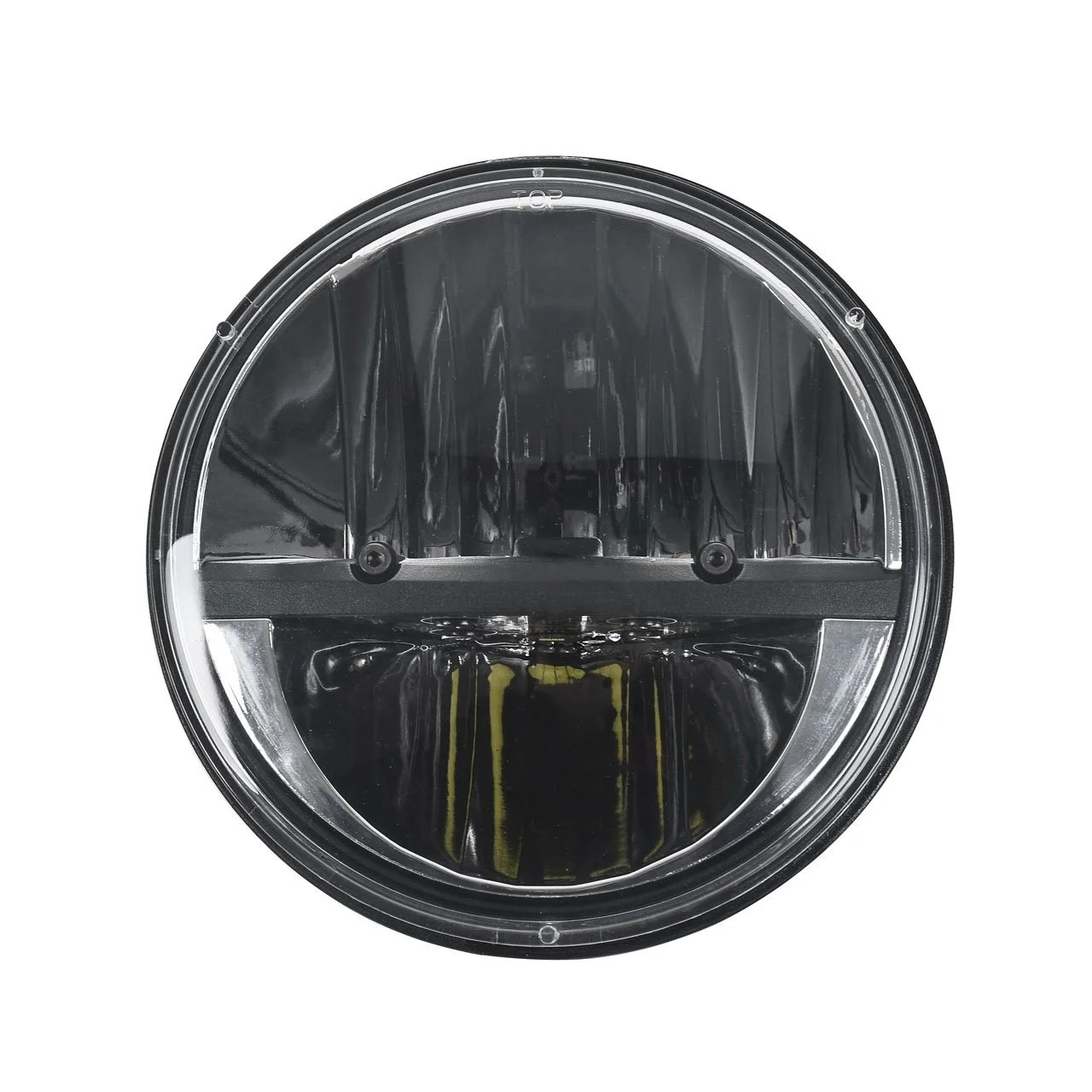

Ask around among any Truck-Lite owners (myself included) and 99% of them will have nothing but praise for these headlamps. It's absolutely shocking how good the light output is on these things. I went from stock sealed beam headlights to these things, and it was like shock and awe the first time I drove at night with them. Even on completely unlit roads, these things illuminate so far ahead of you that it's almost like you're driving in the day time. Don't assume that just because these don't have the sophisticated appearance of a light like the JW Speakers, that they aren't as good. Quite the opposite actually! The reflector housing in these things provides a very defined light output. There's a lot of other LED manufacturers out there, but in my opinion Truck-Lite was the first to the market with these things. They're used by the U.S. Army on many of their vehicles throughout deployment in Iraq and Afghanistan. They also make a heated version of the Truck Lites as well (for those of you who live in extremely cold climates). These would be my second choice.

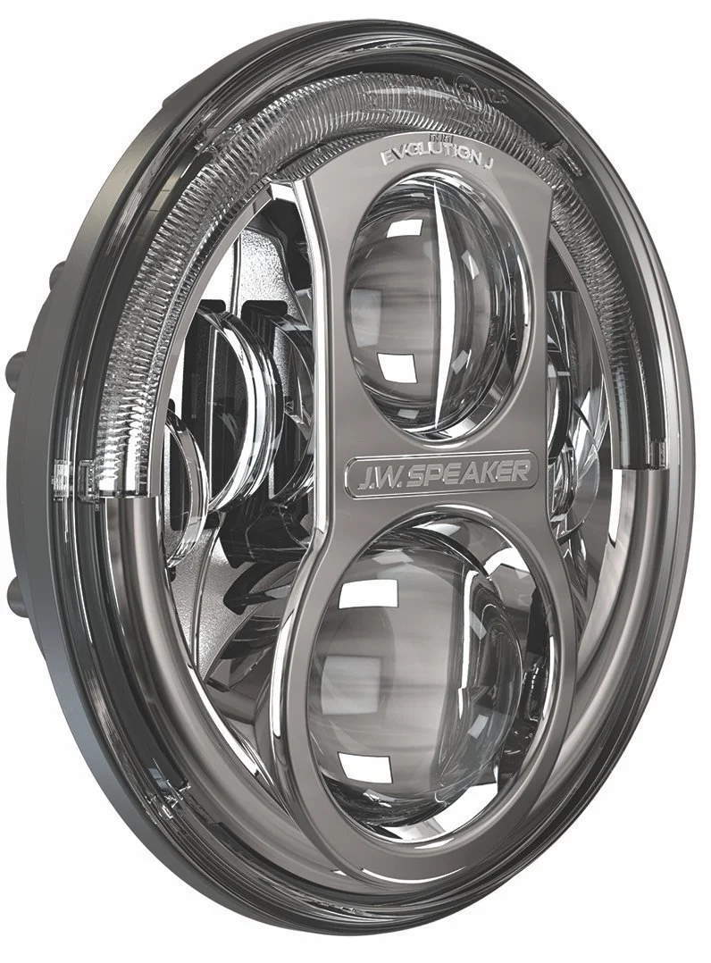

These JW Speakers have a proven history of being one of the brightest available headlights out there for our TJs. Thee headlights are run by a lot of Wrangler owners, and therefore they have a proven track record with the quality to back it up. Available in black and chrome. They're not cheap, but the light output and quality easily make them worth the price. These would be my third choice.​

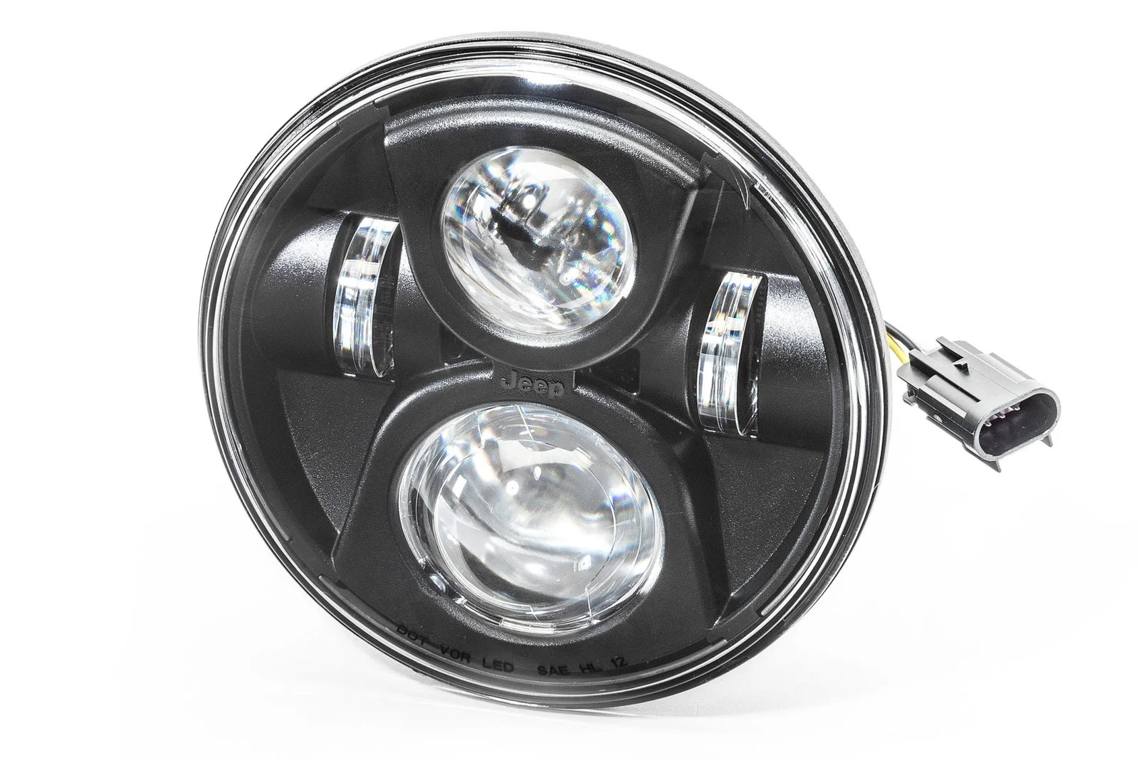

Factory Mopar LED Lights (stock on 2014-2016 JKs)​
These are the factory OE LED headlights that come as an option on the 2014-2016 Jeep Wrangler JKs. They're around $800 for the option (when you ordered your JK brand new), and from what I can tell they are identical to JW Speakers, but they have the "Jeep" logo imprinted on them, which is pretty awesome. They are a 100% plug-and-play headlight for our TJs. Since these headlights are designed for JKs, to make it a plug and play situation, you'll need some H4 to H13 adapters.​

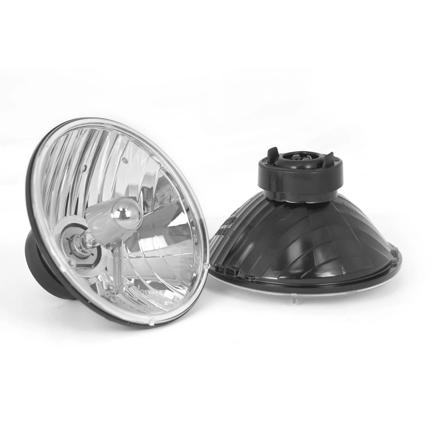

Halogen Setups
Since the stock headlights are sealed-beam, you can forget going out and buying a pair of better headlight bulbs. In order to do that, you'll first need to convert to a set of 7" H4 headlights (which are non-sealed beam). With these headlights you'll be able to replace just the headlight bulb itself (not the entire assembly) and you'll also reap the benefits of much better light output versus stock. Now I don't know why anyone would bother with halogen lights considering how much brighter (and less wattage) LED lights are. However, everyone has different taste, and if you insist on running halogen headlights, you'd be a fool to consider anything other than the following halogen headlights for your Jeep Wrangler TJ.

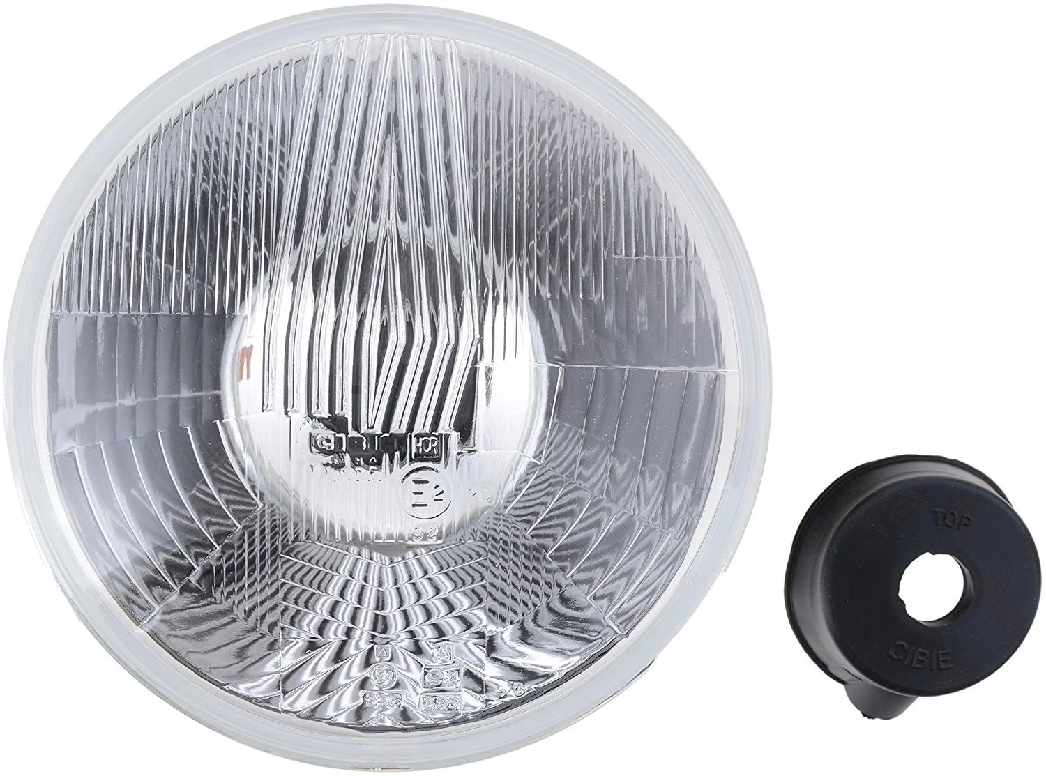

These would be my top choice for halogen replacement upgrade hosings. There have been many comparisons of the Cibie 2" versus the Hella 7" but the Cibie always seems to edge the Hella out in regards to light output just a bit.​

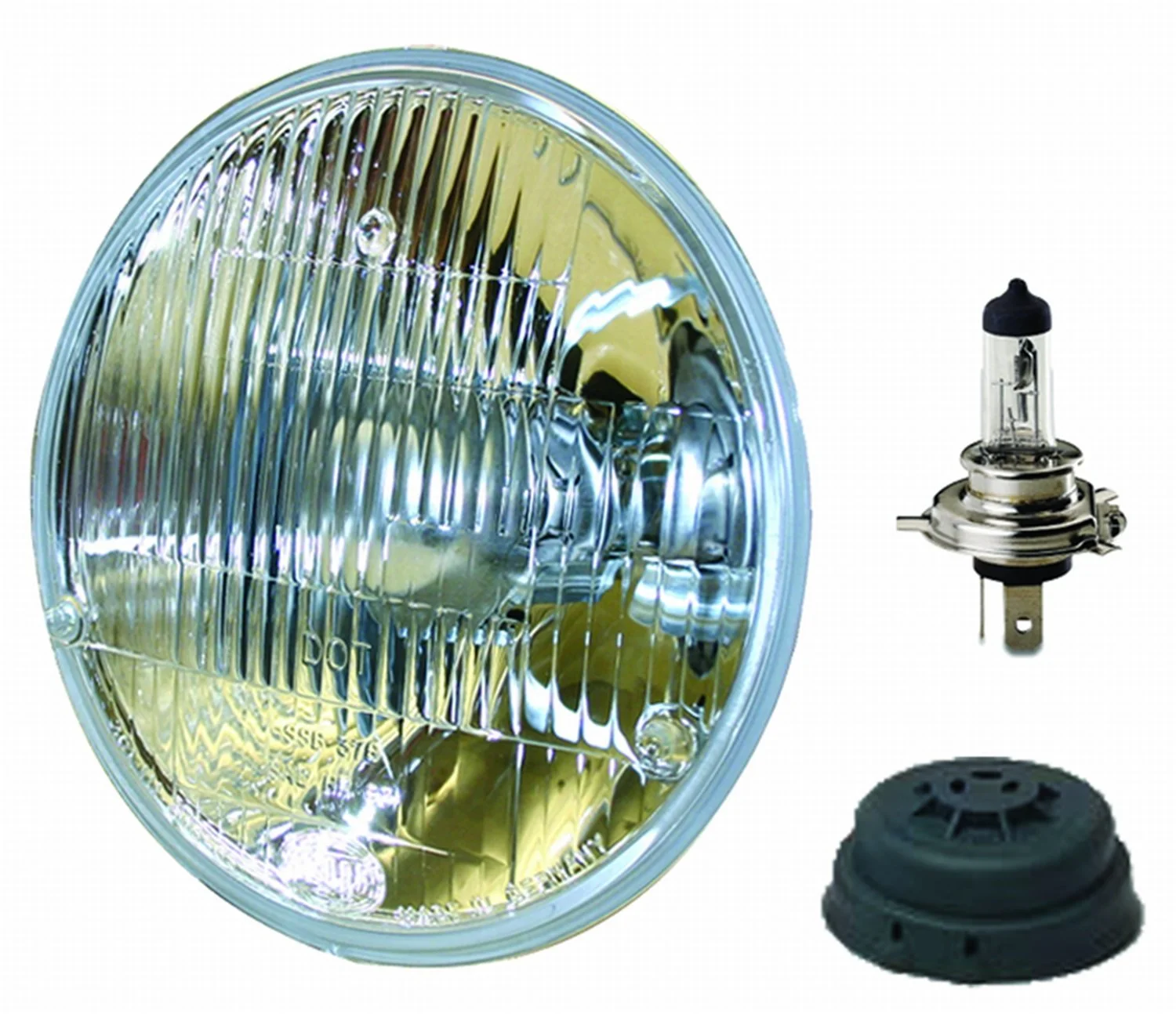

A close second to the Cibie, these 7" halogen headlight upgrades are a solid choice for improved light output over stock.​
I can't comment on these personally, but the people who are running them really seam to like them, so I'd put them right up there with the Cibie and Hella H4 lights.​
The whole 'crystal' look is just that, a look. To some people it looks really good, to others it doesn't. However, this is another viable option for a halogen headlight upgrade.​

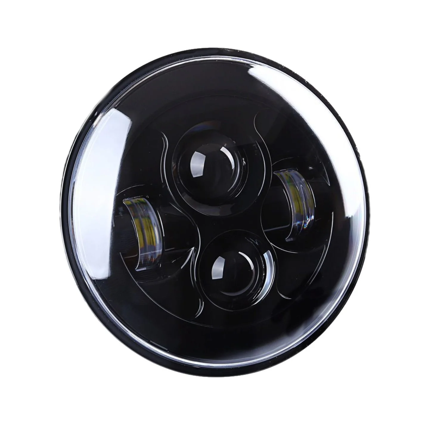

I'd like to add an important note. Some of you guys may have noticed that there's a ton of headlights like this floating around out there:
https://www.amazon.com/dp/B01M9AQR7R/?tag=wranglerorg-20
You may ask yourself why there's so many supposed 'manufacturers' such as Lantsun, Nightsun, etc., all making the same headlight. Well, it's because they all come from China and they're all shipped to the US and re-branded as whatever they want to call them. They are ALL the EXACT SAME HEADLIGHT, just marketed as a different brand. Don't be a fool and pay an arm and a leg just because one of them comes from a name brand like Nightsun. They're all built in the same factory in China.
I'm just pointing this out because the market is flooded with LED headlights and it can be hard to understand what is what.

Cibie 7" H4 Headlights
Hella 7" Vision Plus H4 Headlights

Truck-Lite 7" LED Headlights
Ask around among any Truck-Lite owners (myself included) and 99% of them will have nothing but praise for these headlamps. It's absolutely shocking how good the light output is on these things. I went from stock sealed beam headlights to these things, and it was like shock and awe the first time I drove at night with them. Even on completely unlit roads, these things illuminate so far ahead of you that it's almost like you're driving in the day time. There's a lot of other LED manufacturers out there, but in my opinion Truck-Lite was the first to the market with these things.
JW Speaker 8700 Evolution 2 7" LED Headlights
They really look weird at first, but the look grows on you. I wanted these things for a long time, but I couldn't justify nearly $300 per headlamp (that's absurd!). Anyways, I finally found a site that had a comparison of the JW Speaker headlamps next to the Truck-Lite headlamps. The funny thing is that it was pretty much a draw in regards to which one had better light output. I mean they were almost identical in terms of light output! That being said, while I do think these are cool, I can't see why you'd fork out $600 for a set of headlamps when you could get the Truck-Lites for $330 for a set.

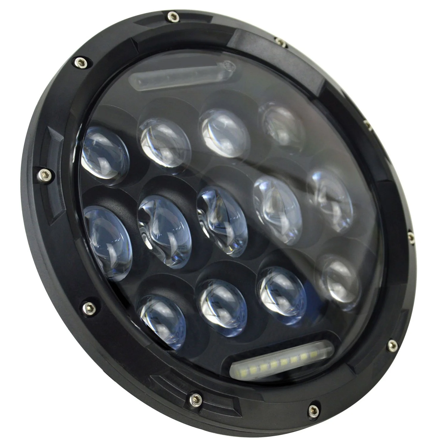

Lantsun 7" LED Headlights
At first I was unsure about the look of these lights. They look a bit odd initially, but after seeing them on a Wrangler in person I actually really grew to like the look. They're quite a bit cheaper than the Truck-Lites, and from what I've been reading the light output is pretty much identical to the Truck-Lites. So, at this point I would say for me personally it simply comes down to what look you prefer more. If I was going to do it all over again I probably would have bought these over my Truck-Lites, only because I really like the look of these!

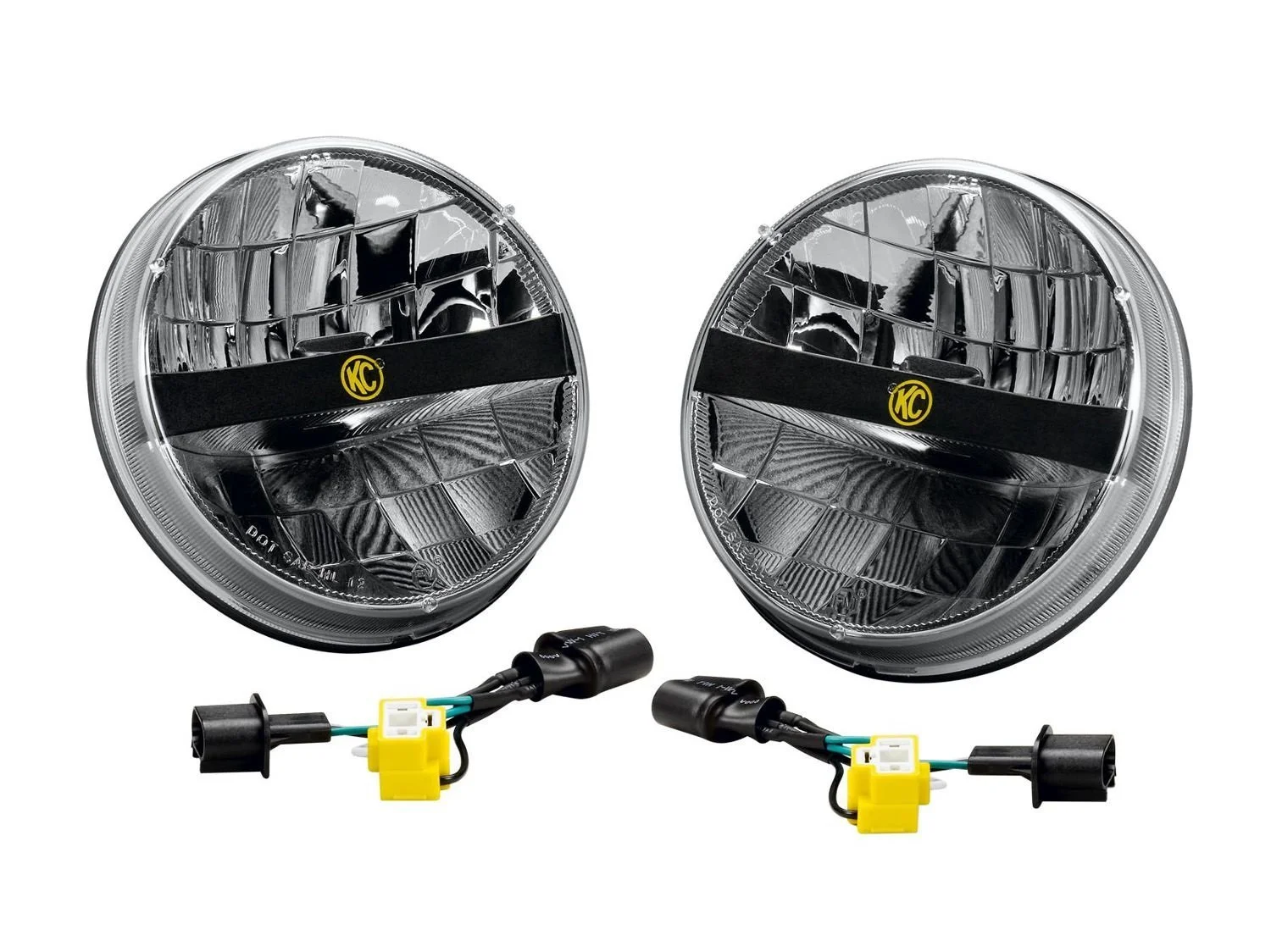

KC Hi-Lites 7" LED Headlights
These things are pretty new, but from what I hear the light output is on par with the other 7" LED headlights. KC Hi-Lites is a reputable brand, so I wouldn't hesitate to buy them if I was in the market.

Ok, I have a stupid question. I'm looking to buy the Cibie 7" Headlights for my 2002 Wrangler and wanted to know if I get the ones with the parking brake or not. Thanks.
Parking brake? Do you mean parking lights? If so, I would get the ones with the parking lights personally.
Thanks, I believe it was a misprint in the description, but I repeated it. One more question, do I need any extra parts or wiring to install the Cibie lights?
You shouldn't need anything except whatever bulbs you want. And I believe you only need the ceramic adapters like I mentioned if you go to a higher watt bulb than the standard 55/60. Not positive though.
