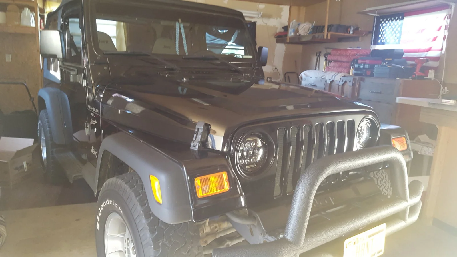

Thanks @Chris, very helpful advice as usual. I went for a night ride and I will say I was shocked at the vast difference. This was something I should have done LONG ago! I adjusted the headlights and they perform beautifully. Now to tackle the high beams within the next couple days. Thanks for rhe write up Chris, as always it is much appreciated. I'm still contemplating wiring them up for use as daytime running lamps as well, but that will be a project for another day.

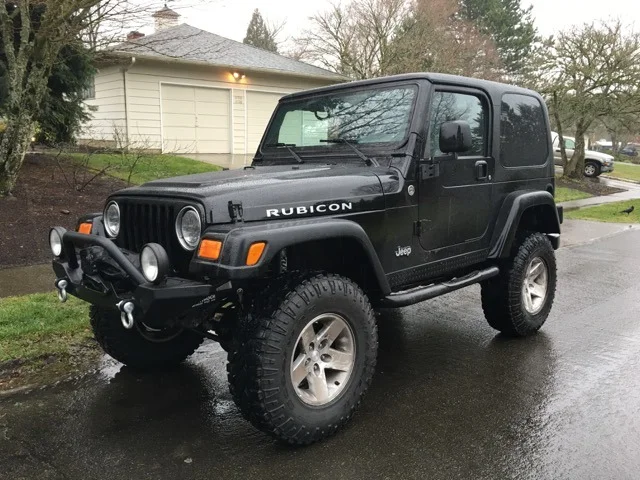

Sorry this isn't the best angle, but here's a photo of the Truck Lites on my TJ Rubicon. They look close enough to stock!
