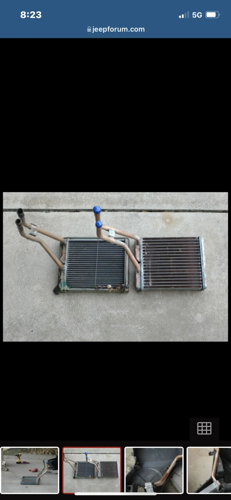

I thought they all had turbulators but the plastic ones were too fat and slowed the flow,they also come lose and end up in the water pump
Reactions: tr21triton
I don't know but I'm pretty sure that is not the only reason they suck.
My 2002 will burn your feet,but we might be trying to make some newer jk core or something oem work in a tj in the future
Yep,found these pics you’re right,LOTS more passages on oem!
