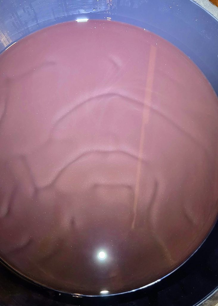

That sounds an awful lot like the noises my case made, but in my situation the root cause was obvious once I drained the transfer case fluid.
Videos:
What came out:
Replacing every bearing in it because the PO of the case used way, way too much RTV when they put in the SYE.
