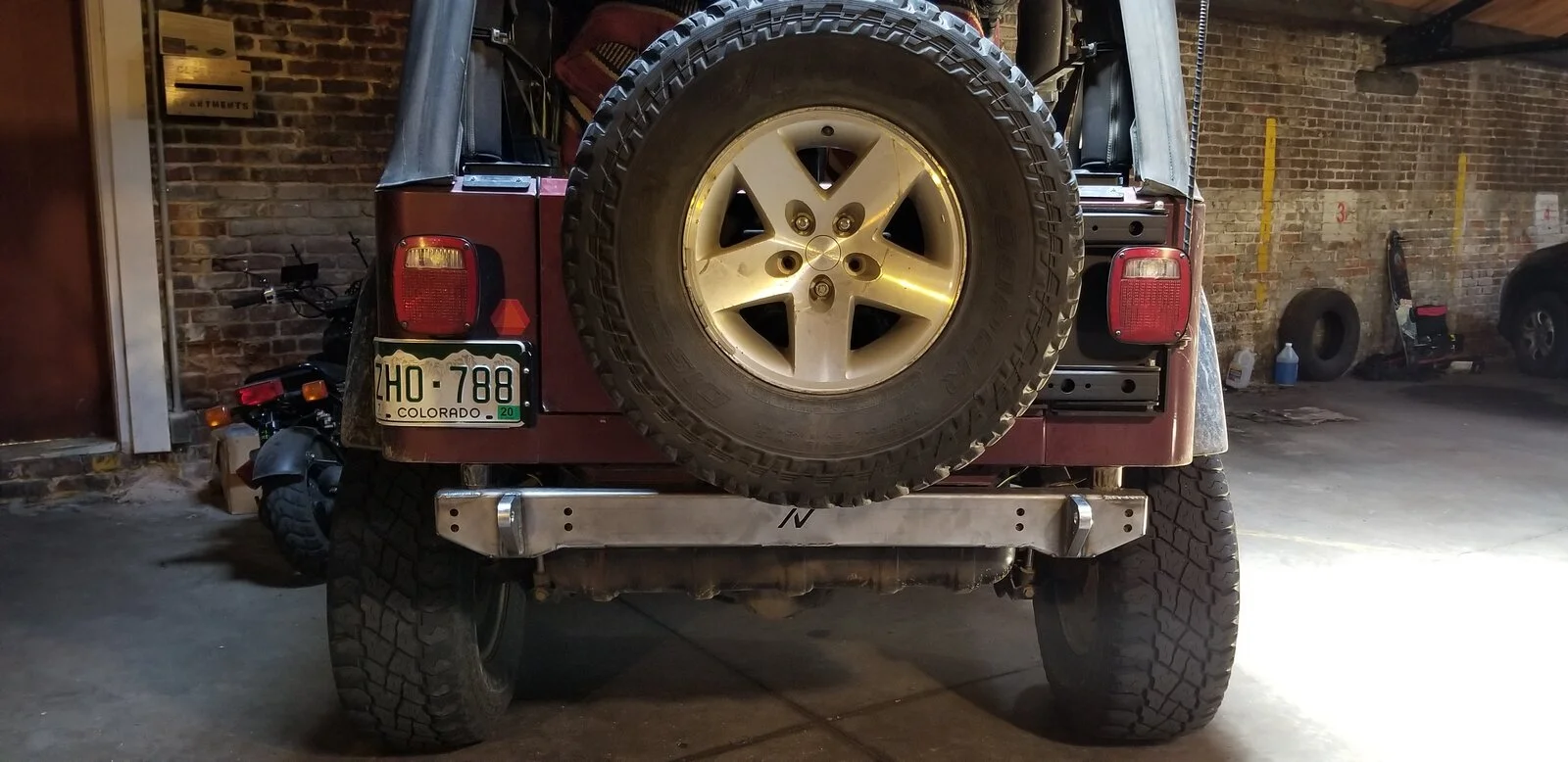

I'm a little bit worried about catching a small tree or something now that my giant bumper will be gone. Not so worried about rocks.
As far as clearance...my reasoning here is that both bumpers I sold were damage free...with the exception of the lower lips. I KNOW I'm dragging them over the little itty bitty rocks we have here. So, I'm getting rid of the catch points...to see where my next catch point is. Hopefully not the tub corners...
I kinda like the idea of an aluminum re-enforcement.

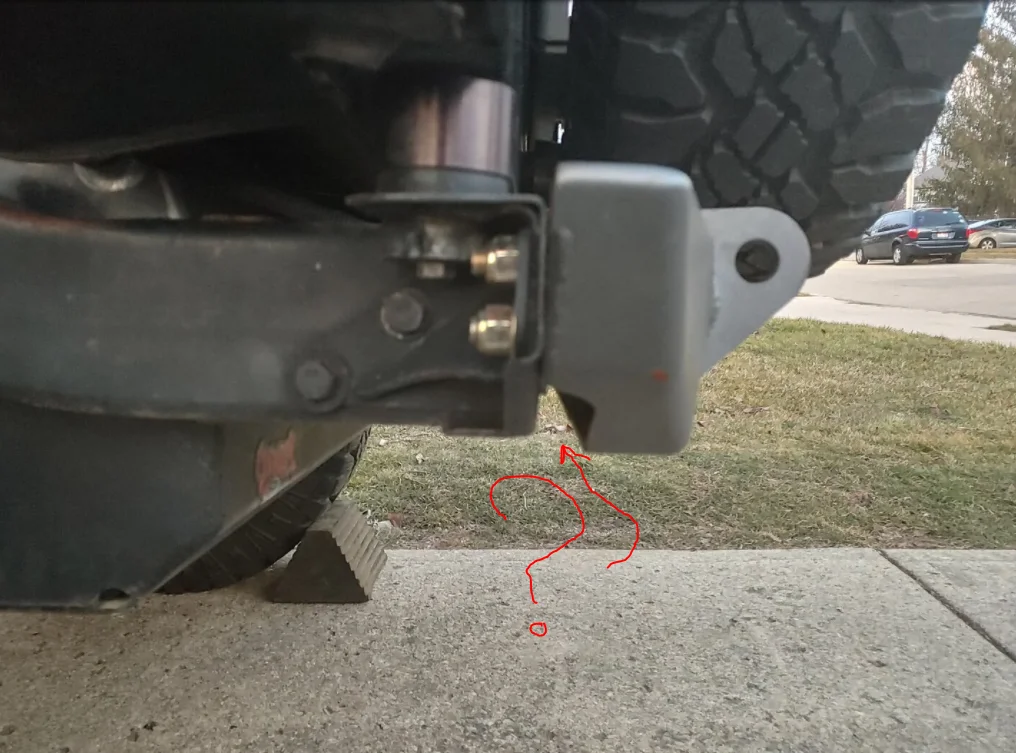

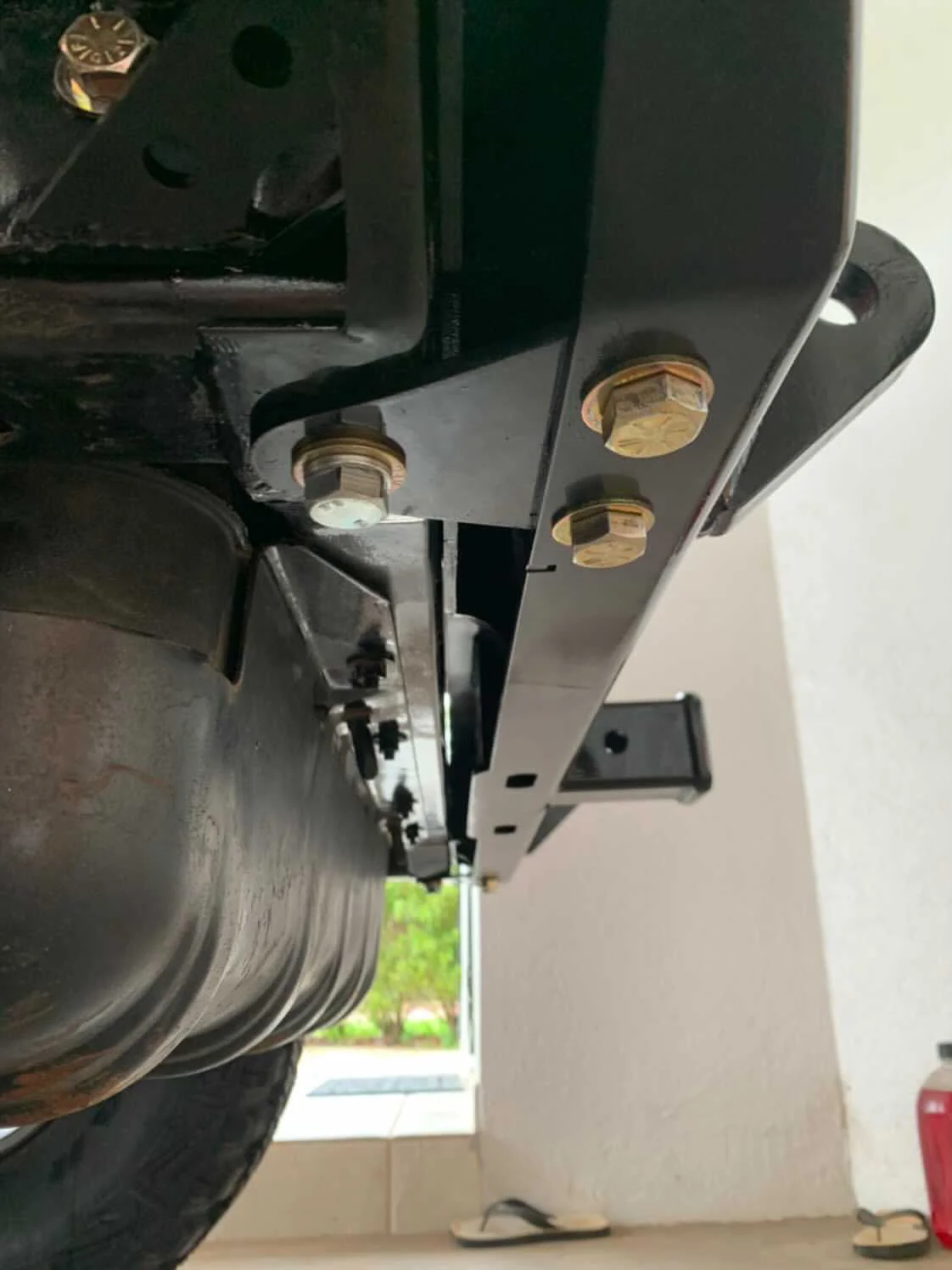

You say this because of how mounting points are set up flush with back side of bumper such that it sticks out from cross member still leaving it potentially vulnerable rather than tucking cross member inside bumper? I looked to ensure ends were closed before buying but didn’t even think of that aspect.
Pretty much. I also don't like that they didn't pick up the lower bolt hole in the frame.

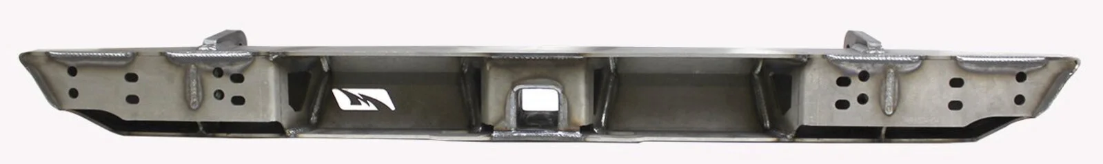

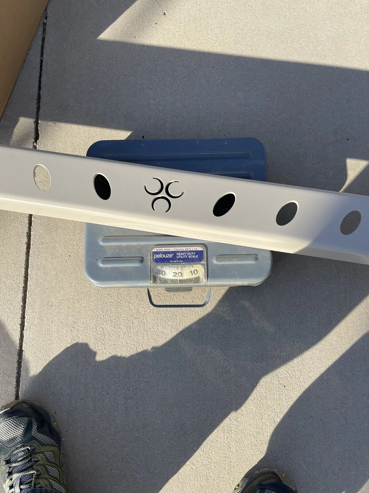

Decided to go Barnes as a base and add the extra "Stuff" that I want, like a receiver, wrapping the ends, I might taper it up to protect the underside of the tub, etc. FWIW, I had some discussion back and forth with them...they claim the bumper only weighs 15 pounds! I'll add more, but still...coming from a 66 pound bumper, that is a good diet!

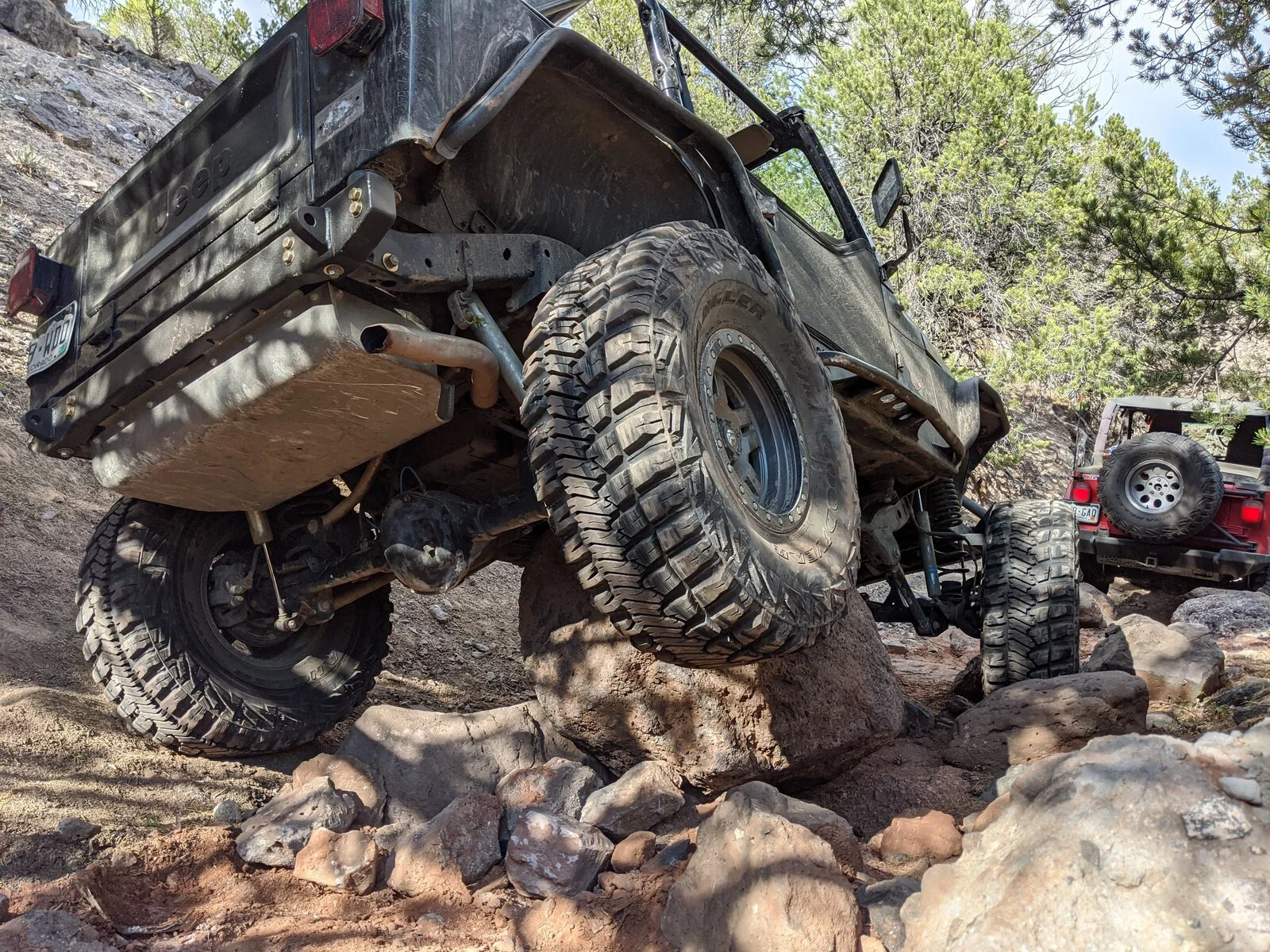

Don't mind the rest of the junk attached to the bumper...along with poor driving skills.....passenger side corner damaged prior to this picture.....Jesus.....my Jeep is a disaster:rolleyes:
Wait, are you telling us the solid metal fender flares didn't magically disperse the energy of the impact and save the tub from disastrous damage? :eek: /s
These plates protrude out from the crossmember the thickeness of the material. All others that mount the traditional way will hang at least 5" out from the body. It really only matters if it matters. Scratches and gouges will tell you what is going on.
There are plenty of scratches/gouges under the bumper to let me know it's in the way.
