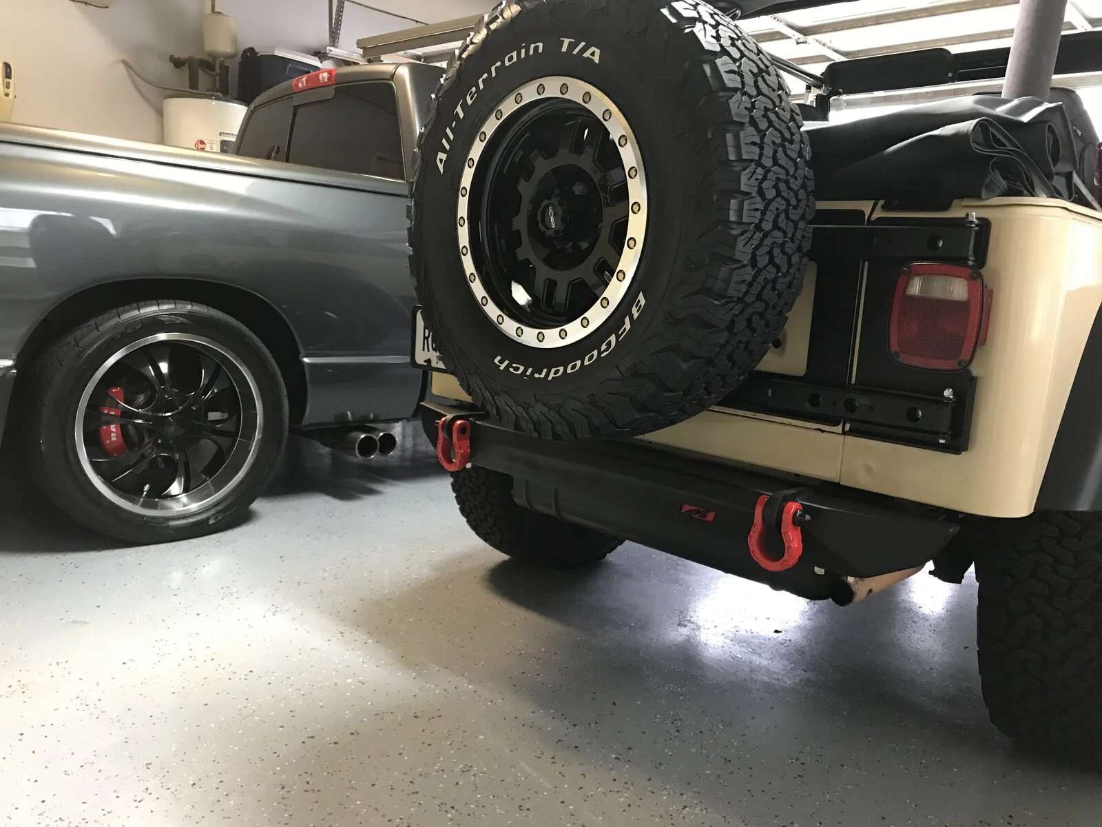

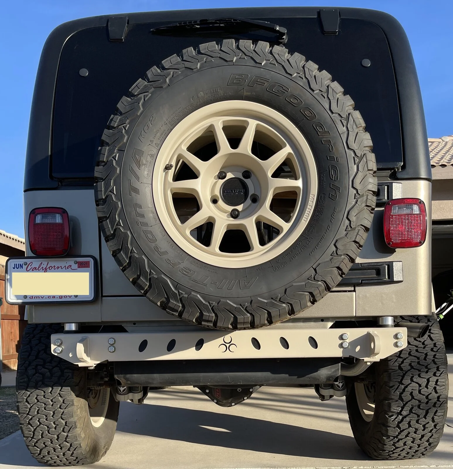

Nemesis is about as minimal as you can get. I also was a little concerned about the lack of corner protection.

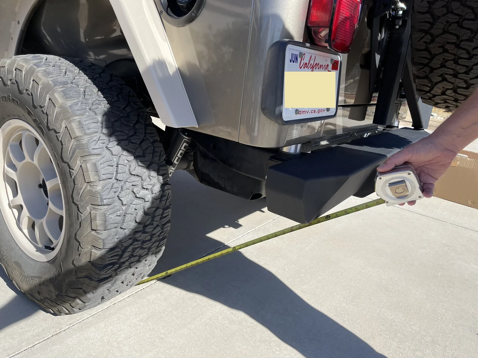

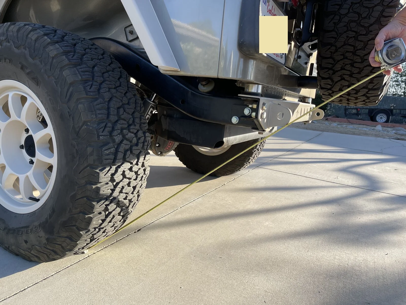

I wanted the Recess hitch, corner protection, and tire carrier. So the Bestop Bumper fits all those needs. It is literally the same clearance from the ground. But the Bestop Bumper sticks out about 4-5" further from the rear of the vehicle. I tried to get a rough departure angle.
Reactions: Irun and Alex01
Do you still have the nemesis? I have a bumper more like the bestop. I drag it all the time.

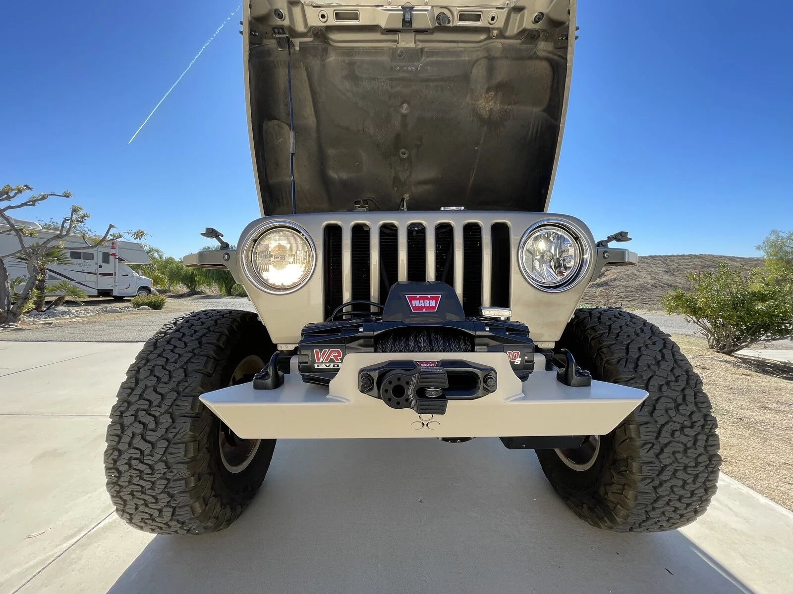

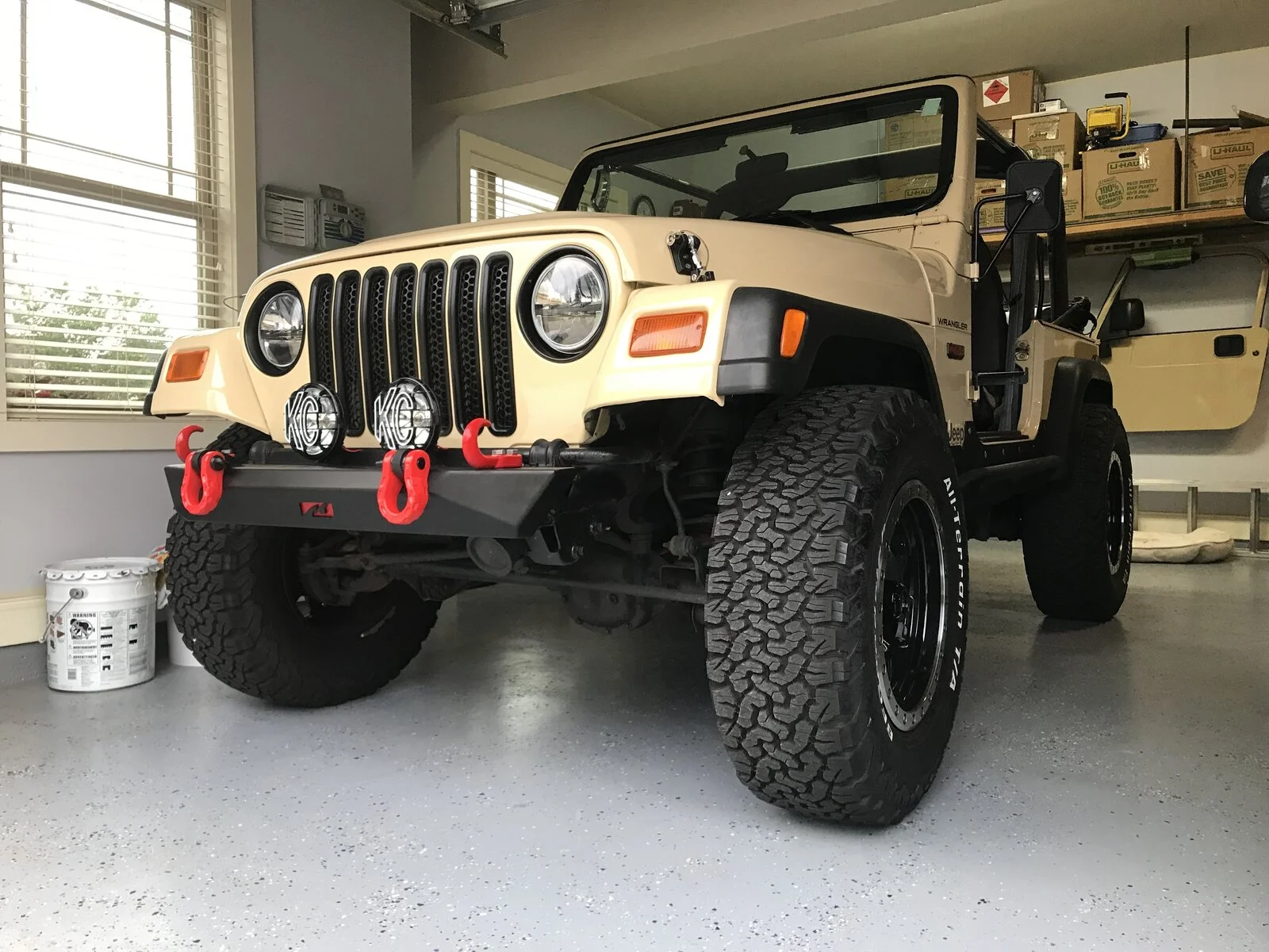

I'm changing my bumpers this winter, to go along with my Tub refresh. I bought a Motobilt Stubby steel bumper to go on front. For the rear, I'm thinking a HD cross-member style. So far, I've found them from

Why not match the Motobilt?
Quality doesn't get any better than this!
