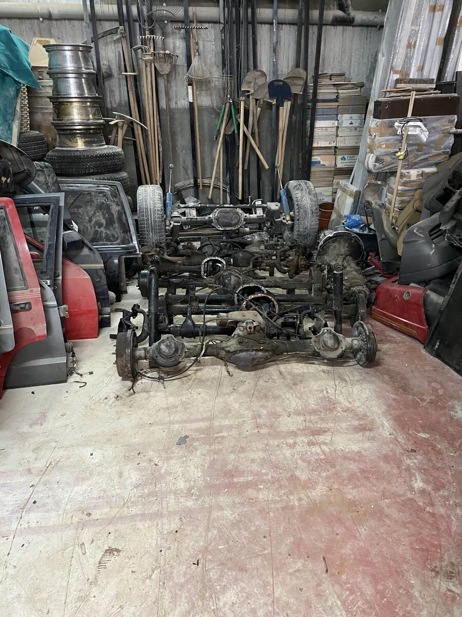

What?! It is a XJ Dana 44.
You can use it in a TJ. Measure the wheel mounting surface.
To use it in a TJ all you have to do is cut the leaf spring and shock mounts off the axle, grind the axle tubes smooth, and then weld on TJ brackets.
The Dana 30 behind the Dana 44 is a leaf sprung YJ high pinion 30. While it is high pinion, its not desirable for a TJ swap.
The axle behind the YJ Dana 30 looks like a Dodge 44 or 60 balljoint, and center axle disconnect. Not very desirable for a swap either.

I am not looking to swap any more axles. So, the other axles are maybe going for selling. (I have 10-11 axles, that I dont know what to do with them, haha photo below)
