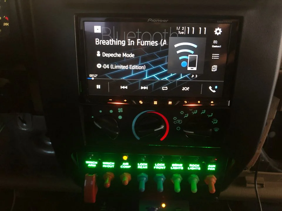

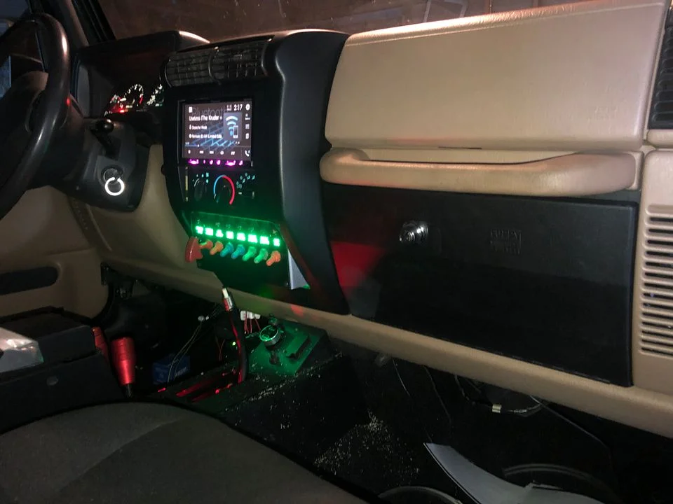

I like the pioneer DD decks. I have them in a few vehicles, one has GPS too. All have BU cams.

Now, back to business. For what it is worth, alpine decks are hard to see in full sun, pioneer decks need to be dimmed when running at night.
The pioneer decks have plenty of add ones too. Since I have went with “just” pioneer, my objective opinion is skewed. So consider that too as I rave in about pioneer decks.

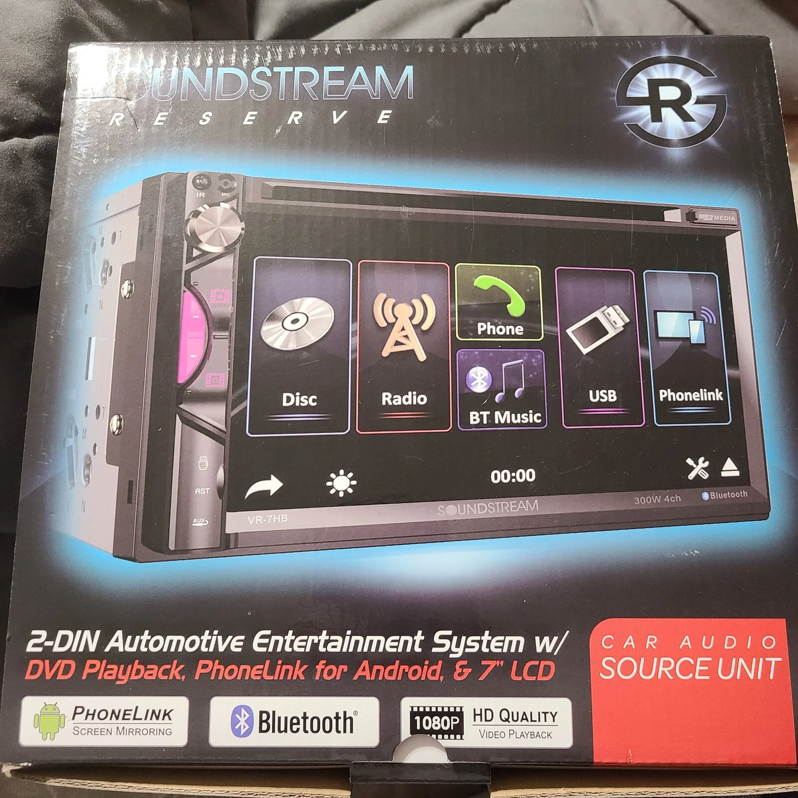

Ended up going with this DS-18 that was on sale locally. Hopefully I won't be disappointed. My only real concern is the screen being bright enough to see with the top off.

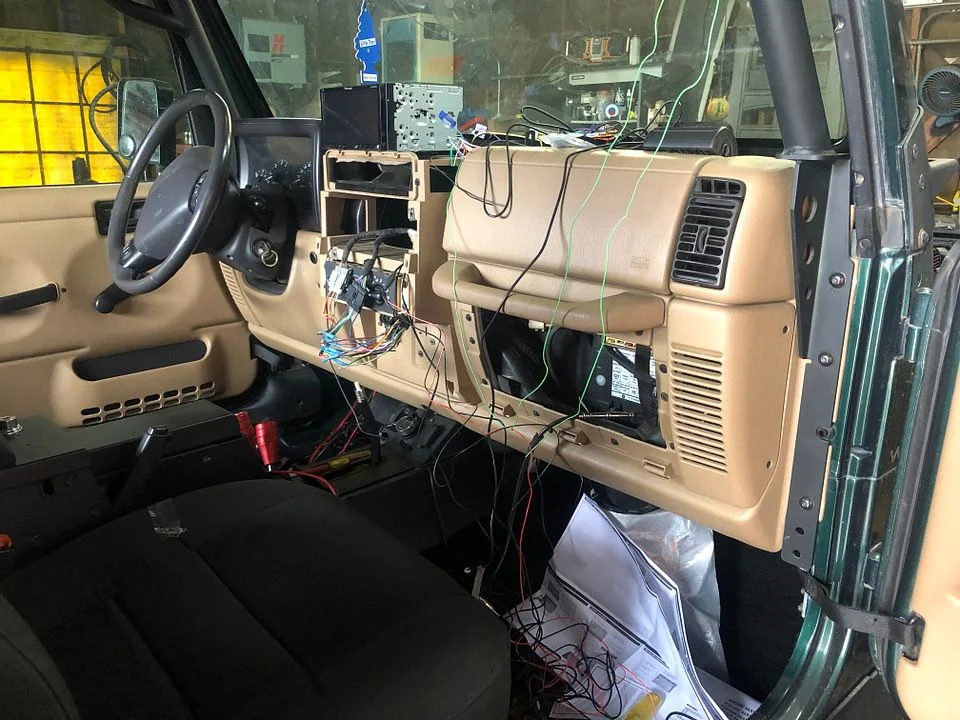

I just added a double din to mine. It has ports for both front and rear cameras. I did a video to show mounting and wiring of Double Din Stereo operated forward and rear cameras on a 2006 Jeep Wrangler . Took it offroad this weekend and I love the cameras. The Apple Carplay is awesome too. Used maps to track the trip. It was nice to know distances to waypoints.
Note1: the hole I drilled by the hinge is 1/4" - too small for the RCA connector to fit through so I clipped the wire and reconnected it after I passed the wires through the hole. I probably could have drilled a big enough hole for the connectors to fit through and still be hidden by the trim, but I just used the smaller hole.
Note2: I bought two backup cameras. I really needed one backup and one front camera because a backup camera reverses the image to be the same as looking in a mirror. A front camera does not reverse the image. I replaced my front camera with one made for the front.

I ended up returning the double din unit after reading numerous horrible reviews. Apparently it likes to change volume by itself when you hit a bump which is a no go for a jeep and it truly hates water.
I ended up going with a marine grade Kenwood and couldn't be happier. Install was a breeze and I'm putting the money I saved into new speakers and an amp. All marine grade.

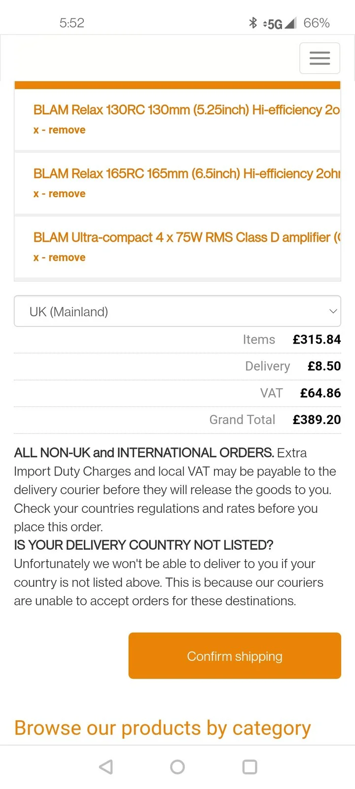

How come you are stuck on marine grade equipment, do you drive topless in the rain a lot? There are a lot more options of you do not need marine grade, like the Kicker C or D series. Even the BLAM relax are a great option as they are a 2ohm - 3ohm speaker with a great sound. They will play loud, clear and correctly with a decent amp.
I have ordered from this place before as well as a few members. This is the BLAM three pack, 4 channel amp with 5.25" and 6.5" speakers.
