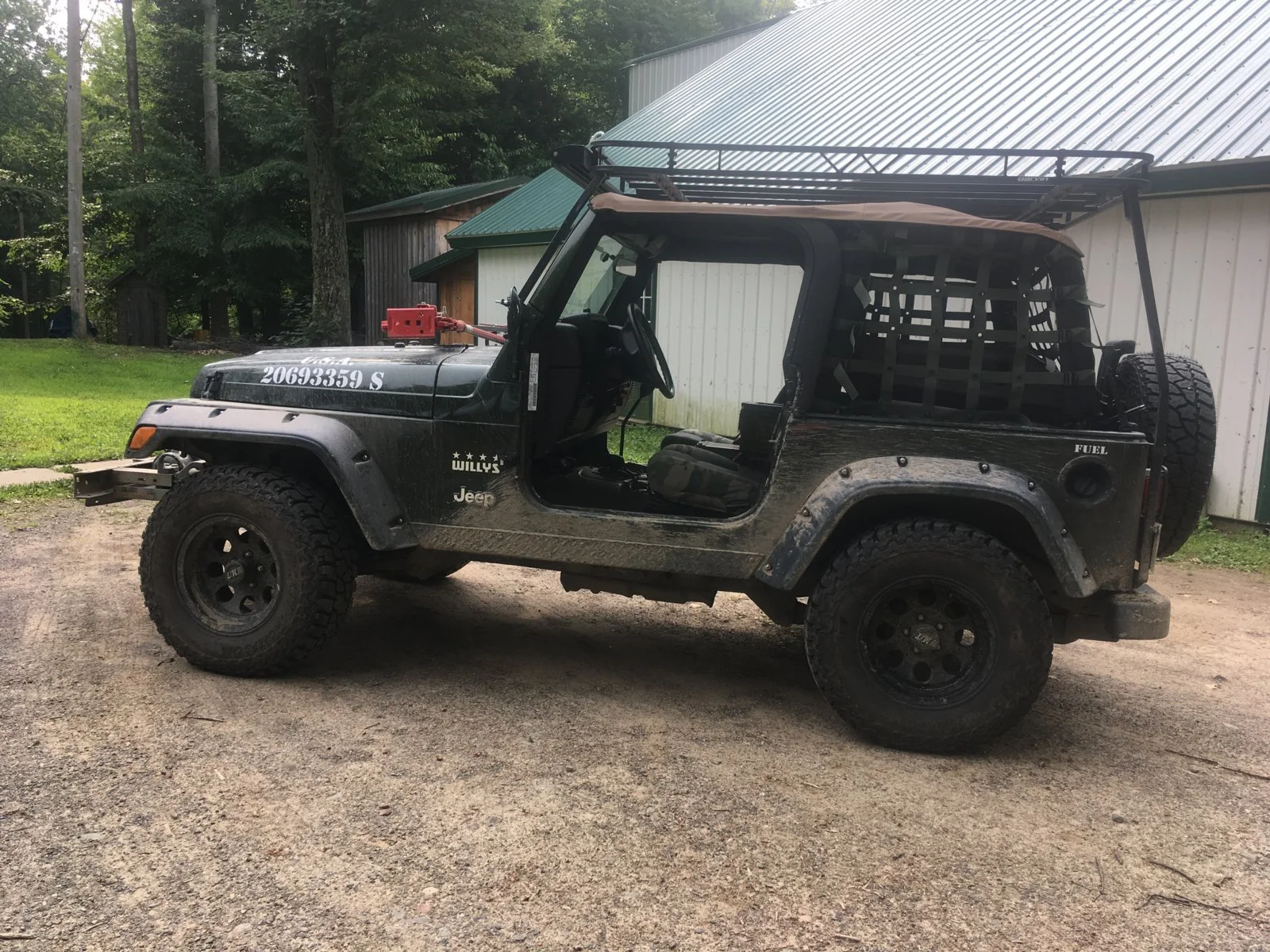

Thanks for the help and I'll post some pics as the build progresses but for now here's a pic of our current setup after a off-road trip in New Hampshire last month. Oh and the pocket flares are going in favor of some flat fenders as soon as I get around to building them.
