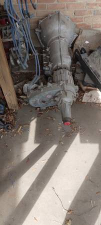

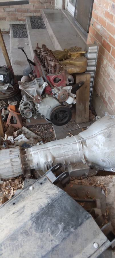

Found a guy selling a transmission & t-case off a "94 jeep." As far as I can tell the only autos used in TJ/YJ/XJ/ZJ were the 30RH/A904, 32RH/A999, AW4, and 4(2|5|6)R(L)E, and this is none of those. Just in case he meant "84" it doesn't look like a TH400 either. I also don't recognize the transfer case & note the lack of extension housing, but I wouldn't say t-case identification is my superpower.
