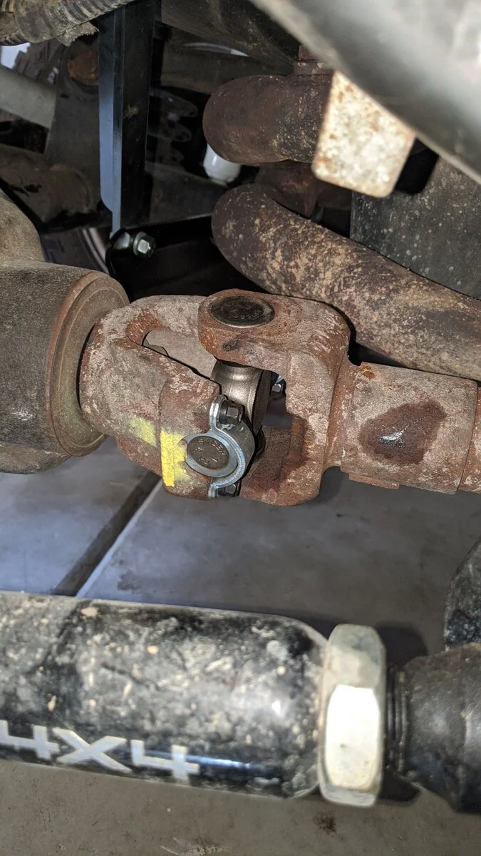

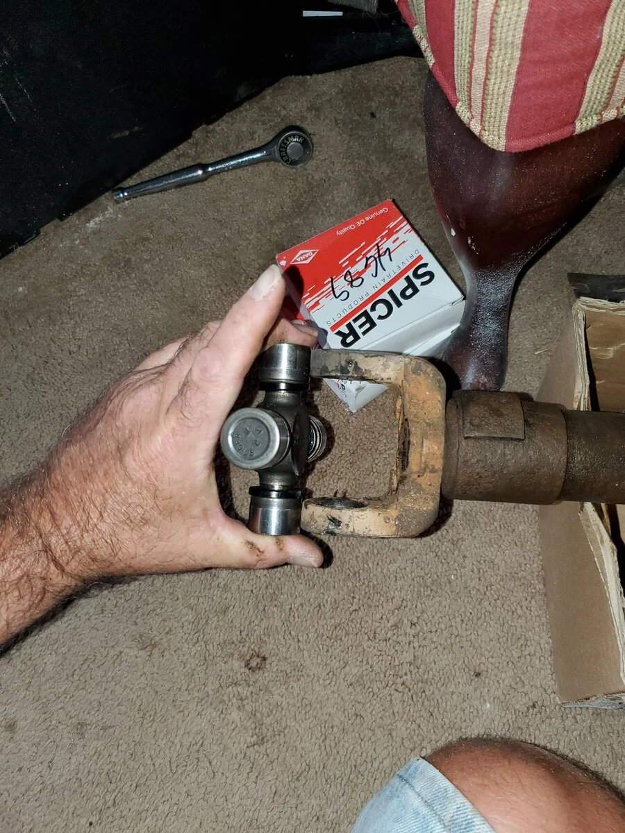

Brian Alcorn TJ Enthusiast Original poster Joined Apr 29, 2019 Messages 396 Location 27025 Jul 9, 2020 #1 ok so what gives .. 04 Rubicon front shaft diff end 5-793X .. old u joint had plastic holding it in .. this one has no way of retaining it as its sticks out past the flange on both sides like the old one ... how does it fit?
jjvw AI Moderator Staff Member Supporting Member Ride of the Month Winner Joined Feb 17, 2018 Messages 31,023 Location Colorado, USA Jul 9, 2020 #2 Rotate it 90 degrees. Inside the box should be a pair of retainer clips the fit in the grooves on the caps.

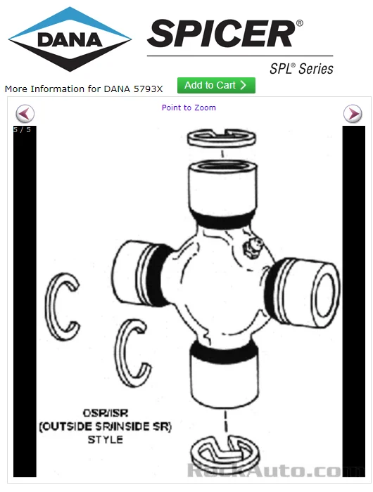

AMS417 "The Ayatollah of rock and rolla" Supporting Member Joined Apr 13, 2020 Messages 2,294 Location Springfield MO Jul 9, 2020 #4 Looks like two ears run outer clips, and two run inner clips according to the diagram.
AMS417 "The Ayatollah of rock and rolla" Supporting Member Joined Apr 13, 2020 Messages 2,294 Location Springfield MO Jul 9, 2020 #5 Ah, diff end uses straps...missed that part.
jjvw AI Moderator Staff Member Supporting Member Ride of the Month Winner Joined Feb 17, 2018 Messages 31,023 Location Colorado, USA Jul 9, 2020 #6 AMS417 said: Looks like two ears run outer clips, and two run inner clips according to the diagram. View attachment 175611 Click to expand... Only inners. There is a tab on the diff yoke that holds the caps in place. Reactions: Schwifty Rich and AMS417
