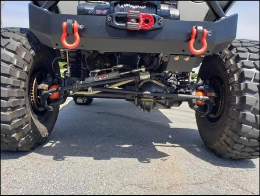

How many things are wrong in this picture?
Now that you've contemplated a bit, what logic was used to build something with that much money thrown at it and get every single aspect of it that matters wrong?
IDK. Giterdone logic? 2much$2Kare logic? Thankfully/regrettably some people FUBAR things and others can learn from their mistakes. Either way, I have this nagging urge to go out and check my SAI😉
What’s up with the TB? It disappears behind the drag link and doesn’t reappear? Can’t tell if it’s tied into the frame. Tires look like they’d interfere with the bumper if he turned much more.
EDIT: that steering box skid is tied in to a tab that comes off the bumper, which is cheese.

This is a TJ Unlimited with a hemi swap and the tires are 39" red labels on a Dynatrac PR 60 front.
Passenger brake line routing looks like it might get hung up on something easily. The steering box skid looks like it wasn't bolted into the right holes. the drag link clamp is a) on the the adjuster and b) should be rolled back so that it is behind the drag link and not on top. Maybe it's the angle of the photo, but it looks like the antirock links would be more vertical if mounted on the other side of the sway bar brackets. Looks like it needs a bit more bumpstop unless they did a whole lot of body clearancing for those 39's.

No, it is a for sale ad that was picked up and discussed due to the 55,000 dollar price. Then the builder got involved and was telling everyone how awesome it is or words to that effect. It is basically a flaming pile of mechanical poo but the reason for the post here was the "that is a great build" commentary in the original post from everyone but me. I was fairly astounded that so few could tell it was a piece of shit.
Essentially the forest is on fire and you're pointing out which trees need to be trimmed to look a bit more foresty.

Cant turn the front wheels while the brakes are engaged. No pics needed for explanation. It's all in this thread
Edit: pic is in the OP
Where else is it going to be tied into?

It literally looks like it’s tied into the drag link behind the coupling. No idea. Can’t tell. All I know is it’s MC
