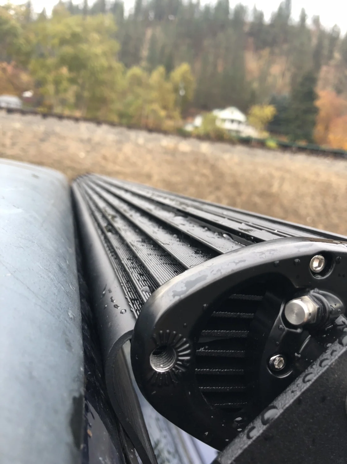

Here is my $3.19 fix for the harmonic resonance issue as the door molding didn’t cure mine.
Vinyl baseboard molding from your local hardware store. Since this photo I have trimmed 1” off but depending on your rig more or less may be needed.
