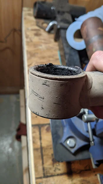

Okay this might be a dumb question but I just got this press and have hardly used it. What is the trick to pressing out a bushing race/sleeve, when the flange-side flares out as far as the housing it's in? Since I can't put it against the arbor plates for the press. Am I supposed to clamp down the arm real tight so it doesn't "pivot" as the housing end floats and I press the sleeve out?

Those are fun. The only way I've ever been able to get those type of bushings out is with a cutoff wheel in a Dremel, a hammer and chisel, a pliers, and whatever else I could use to peel them out. The only thing I used the press for was to press the rubber out so that I could peel the steel housing out. It's a slow process. I'm hoping someone smarter comes along to show us an easier way!

I've never done any like that on a Jeep, but have removed something similar previously on another vehicle. I used a hacksaw (no power tools available) to cut the sleeves through in order to remove them, similar to what you did.
Dang okay. Was worried that was gonna be the way. Thanks guys
Was kinda hoping I could get it out without mangling it to get measurements off of it... But I can probably still get what I need before/after removal

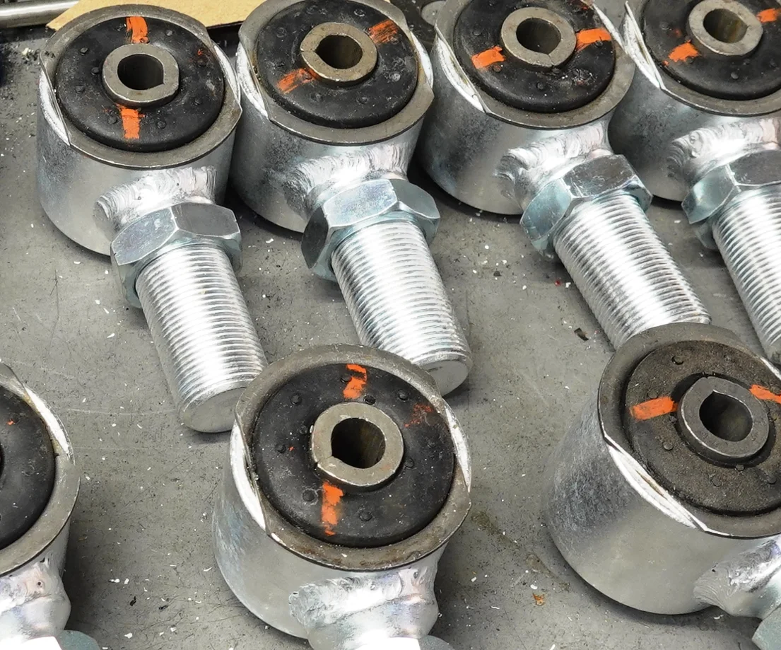

This is how you do it so you can set the two sides of the barrel on plates, piece of tube the same as the OD of the bushing and press away. I know these are a maintenance item, so I flat spotted them ahead of time.
