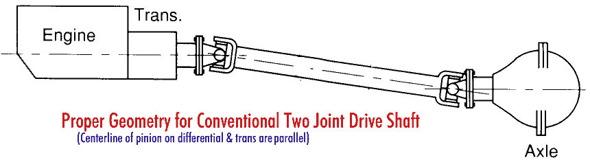

If you were to watch a "U" joint move through an angle (the operating angle) from an end view . You would see that the joint in the driven shaft has to move through an ellipse. Because the joint has to move through each of the quadrants of this elliptical path in a fixed amount of time, the velocity or surface speed of the driven shaft increases & decreases 2 times per. revolution.
With a conventional two joint drive shaft, if your second "U" joint has an equal or intersecting angle , The second "U" joint will be decelerating at the same time and at very near the same rate that the first "U" joint is accelerating, resulting in a smooth power flow through to your pinion.
Now I hope you noticed I stated "very near" when describing this cancellation of non-uniform velocities. this is because the rates of acceleration and deceleration, minimum and maximum velocity , are NOT reciprocal numbers. Min./Max. velocities are a function of the cosine of the operating angle. If for example; to make the numbers easy, the cosine of the angle were .90 and the velocity on the driving shaft were 100 F.P.S. the min. velocity would be 90 F.P.S. and the max velocity would be 111 F.P.S. It is for this reason that on your drivel shaft there is an upper limit to how steep you can run a drive shaft. Even with equal or intersecting angles.
So, How steep can you run a drive shaft? Again , this is entirely up to you. However, most manufacturers recommend a maximum of 7 degrees. I personally believe they are conservative (they have to be). I also think they base their recommendations on the math for the largest semi-sized driveline and call it good for every thing else (which it would be). Doing the math for an automotive sized driveline , using a 4" swing diameter and assuming the transfer case out-put and pinion shafts are parallel, the actual cosine for an angle of 15 degrees. I calculate the result of the net difference in linear distance traveled through the arc of each of the "U" joints' path , to be roughly .0014" per occurrence . I believe there are enough clearances in the universal joint , the slip yoke & spline stub along with a torsional modulus of elasticity in the tubing and other components to accommodate this. Beyond this point the the power train components must themselves flex and distort to allow for this extra motion. This repetitive and continuous flexing will fatigue these components and cause premature failure.

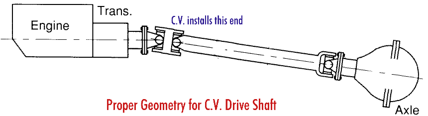

Many people mistakenly believe that a double cardan or C.V. type drive shaft will allow for greater operating angles than a conventional 2 joint or single cardan drive shaft. This is not true. Some types of C.V.'s will actually incur a binding interference at less of an angle than a standard two joint drive line, again depending on the individual components used. Additionally the C.V. itself is longer than more conventional components and will create a greater operating angle on the driveline, especially on very short shafts.
The real benefit to a C. V. (double cardan) drive shaft is smoother operation at higher operating angles and longer life. The C.V. assembly works by intersecting the joint angles at the center pivot point and delivering a smooth rotational power flow or surface velocity through the drive line. Therefore, with this type of driveline it is important to roll the differential upward so that you have minimal joint operating angle at the differential end. As any substantial joint angle would cause the pinion to try to speed up & slow down two times per revolution. Causing what is known as a torsional vibration. (Torsional vibrations will also be created in a 2 joint driveline that has unequal angles at each of the "U" joints). Rolling the differential upward will lessen the total operating angle at each end of the driveshaft. Now at the transfer case end of the driveshaft you have two joints equally dividing the total angle . This will double the life of the joints at this end, additionally you will be back up to full rated life for the joint at the differential end. I also believe a C.V. is stronger than a conventional driveline when turning through the same angle. This would be the result of transmitting the torque in a plane more perpendicular to centerline of the driveshaft.
One word of caution though , make sure the pinion tail bearing still receives adequate oil . An over-fill may be required, overfilling the differential may cause a problem with foaming of the differential fluid. Adding about a cup of a Dextron type II automatic transmission fluid to your gear oil will lower the surface tension of the oil and should help control the foaming. Additionally while this rolling of the differential is easily done with the rear, front ends create a different problem. Because, unless you are willing to cut the differential housing away from the tubes and reweld, anything you do to correct for driveline angles up front will adversely effect the steering geometry of your vehicle. Most people do just what is done in the factory every day. That is , make some kind of a compromise, get things as right as possible for the high speed rear shaft and live with less than ideal performance from the generally lower speed less used front shaft.
