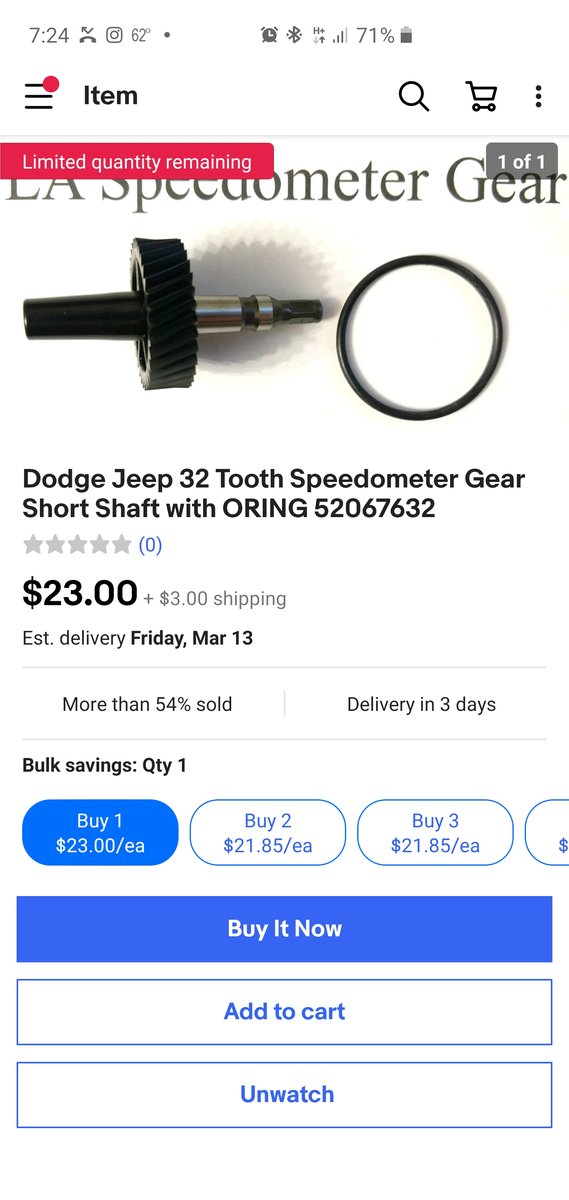

Is this the correct speedo gear "shaft size" for a 2000 Sahara NV3350? The reason I ask is they have a short or long shaft. I have 33 bfgs which are actually 32.5s so I'm gonna do a 32 tooth.
When putting my 32 tooth gear back in the transfercase. I line it up with the 32-45?? part of the housing and the speedo dosent work. If I put it on the 31-28?? part of the housing. It works. Will it hurt anything if i leave it on 31-28 even though it's a 32 tooth?
