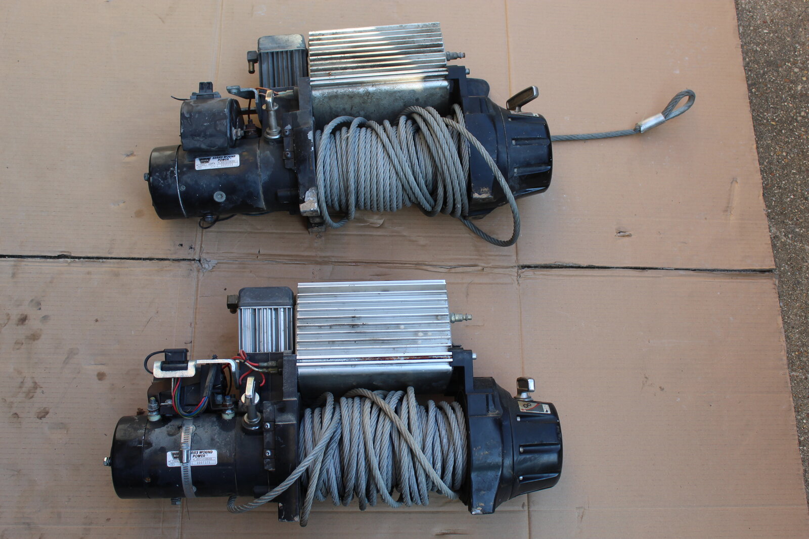

I see you have two PowerPlants there, but without their covers. You can run them like that, but you do have to keep the compressor head and intercooler because they're integral to the structure of the winch.

Great, Thanks. Yeah, I picked these up at the local Sheriff's auction. I am still trying to determine if the solenoids are functional. I notice that these two winches have different solenoids (if you look close at the photo, it should be apparent). Next question: Should these solenoids be bad, is there a way for me to use some of those "old Ford start solenoids" to rig up a way to power in and power out the cable? May have to start a new thread. Thanks
The Warn contactor upgrades for PowerPlants are still available, so that might be an option. If you can get a different solenoid to work, definitely make a new thread for that!
I think I saw an electrical bench test procedure for the PowerPlant somewhere, but I can't seem to find it. Maybe it was for another Warn winch. That might be useful if you run across it.
