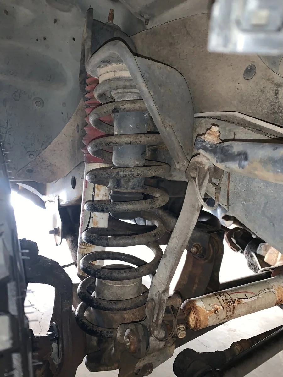

@jjvw is this considered a fixed yoke?
That's a standard slip yoke. A SYE replaces the t-case tail section and drive shaft with a CV driveshaft, and then you'd need at least rear upper adjustable control arms to get the pinion angle correct.
It looks like you have some weird fixed lower control arms. I'd probably replace those with factory style units.
Reactions: Michaelp3257
Definitely not that kind. People do put a yoke on the back of the 241 and gain about 3/8" of drive shaft length. That would certainly help my situation. But the story is that doing so can create harmonic vibration. I'm not opening that door when I addressed the problem with a strap. Keep in mind that we are talking about 5"+ of down with the last 3/4-1" still available through flex on a 4" spring lift and highly raised skid. I'm not losing useful travel unless start jumping the Jeep.
Honestly, I suspect more people have a similar problem, but don't realize it.
