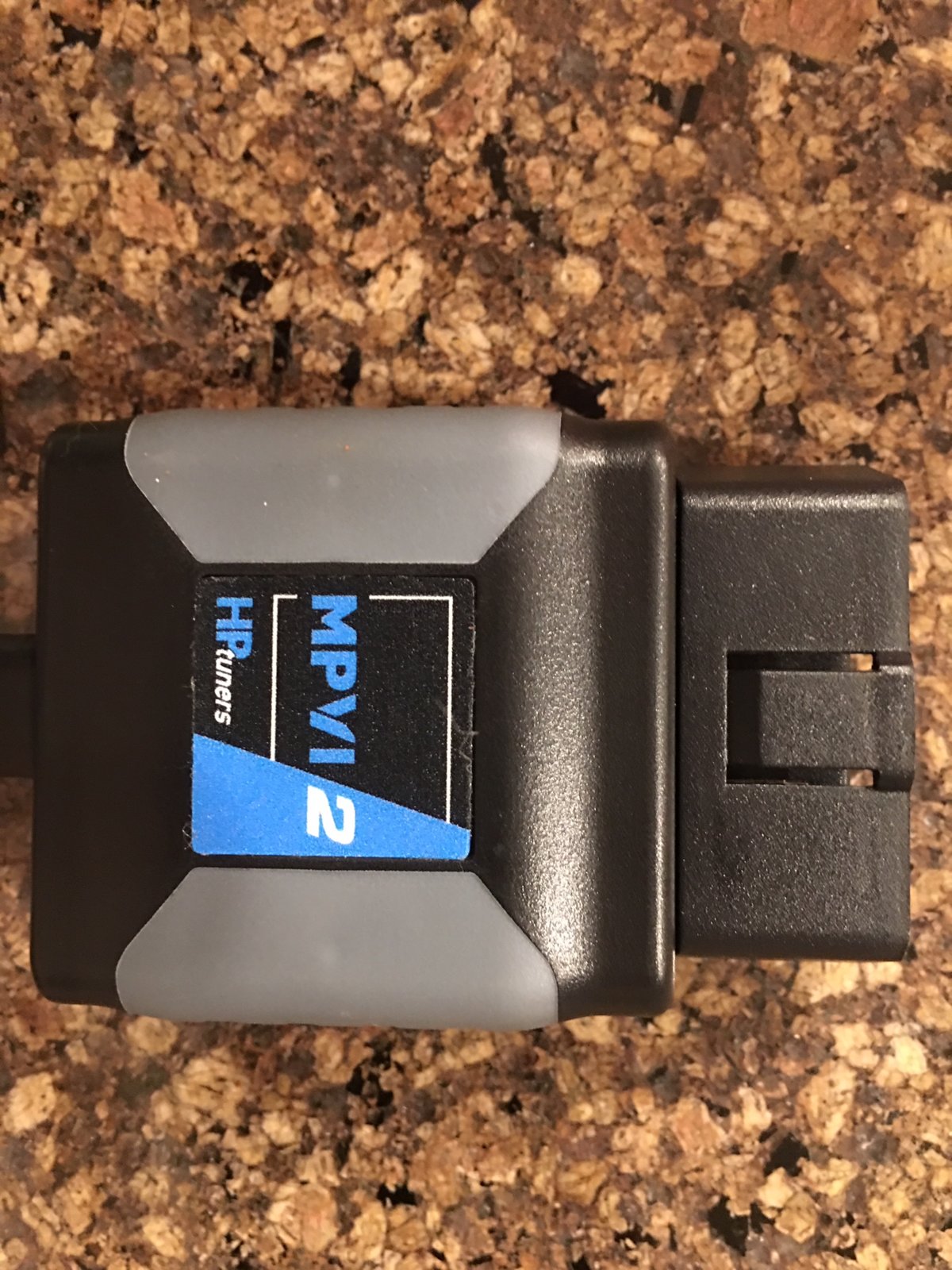

First off, you need the MPVI2, which will set you back $299. In addition, you need two "universal credits", which will run you $100. This allows you to purchase one license, which locks the serial number on the MPVI2 to your VIN number, and insures that you can't use it on any other PCM, unless you spend another $100 and purchase more credits.
Here's the MPVI2 unit that plugs into your OBDII port and connects to your computer via USB:

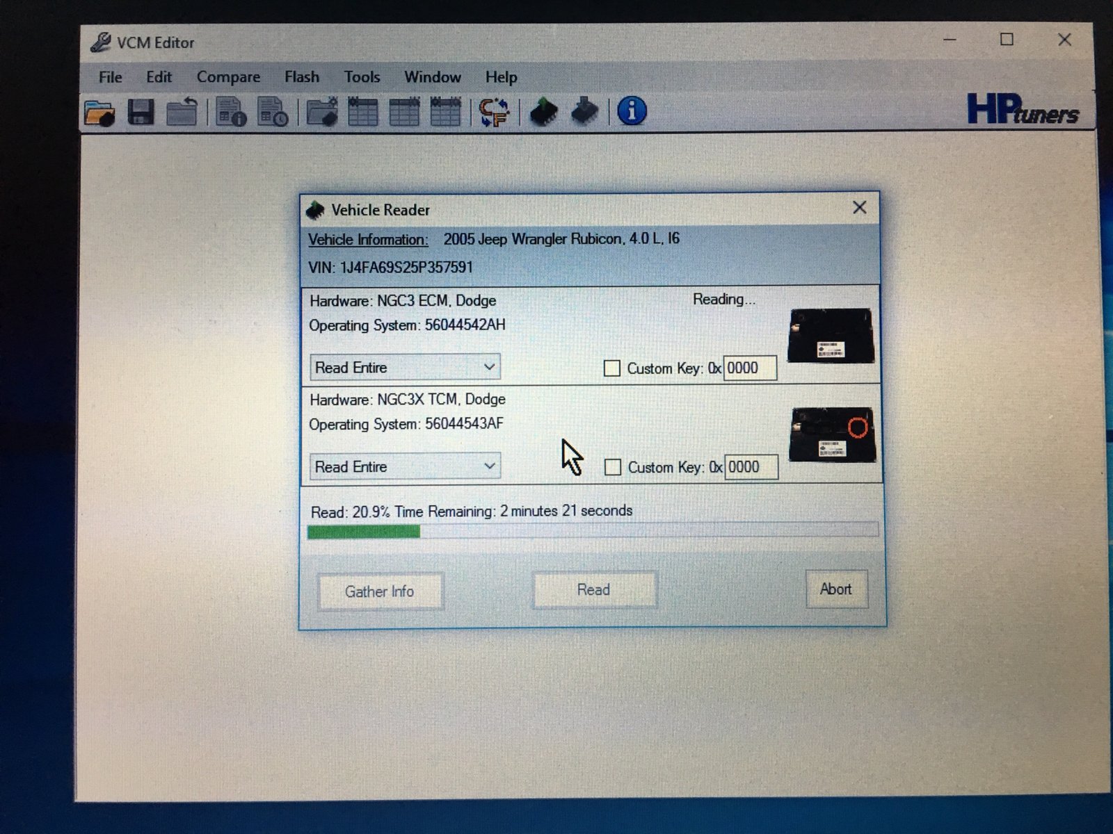

After connecting it and opening the VCM Editor program, you'll need to connect to your PCM. You do this with the key turned to the on position, but the vehicle NOT running.
You can see that once connected, it recognizes the vehicle, VIN, and both the ECM and TCM (which combined we refer to as the PCM):

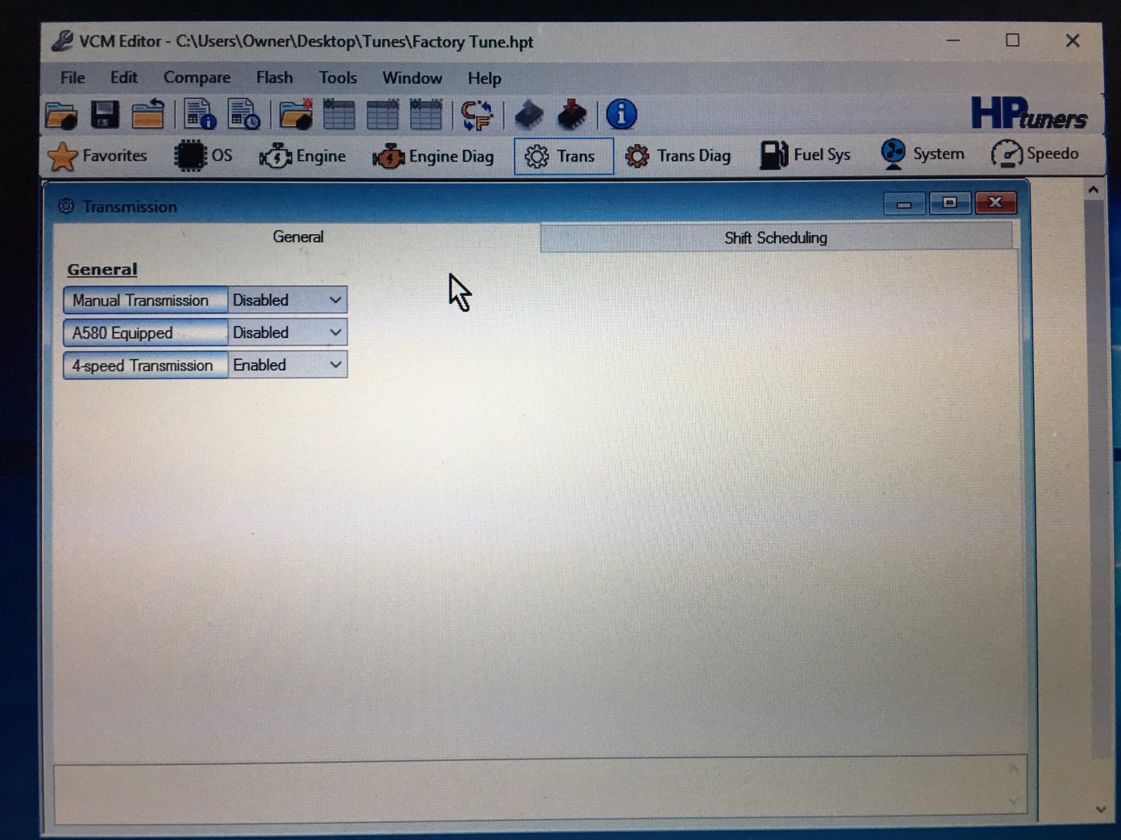

Once you're in, have a look around. Under Transmission > General, you can see the option to enable or disable the automatic transmission. So how would this be beneficial? Well, let's say you bought a PCM from a TJ that had a manual transmission, but you needed it to work with your automatic transmission equipped TJ. Easy peasy! Just select "Enable" from the drop down, and flash the PCM, and you're good to go.

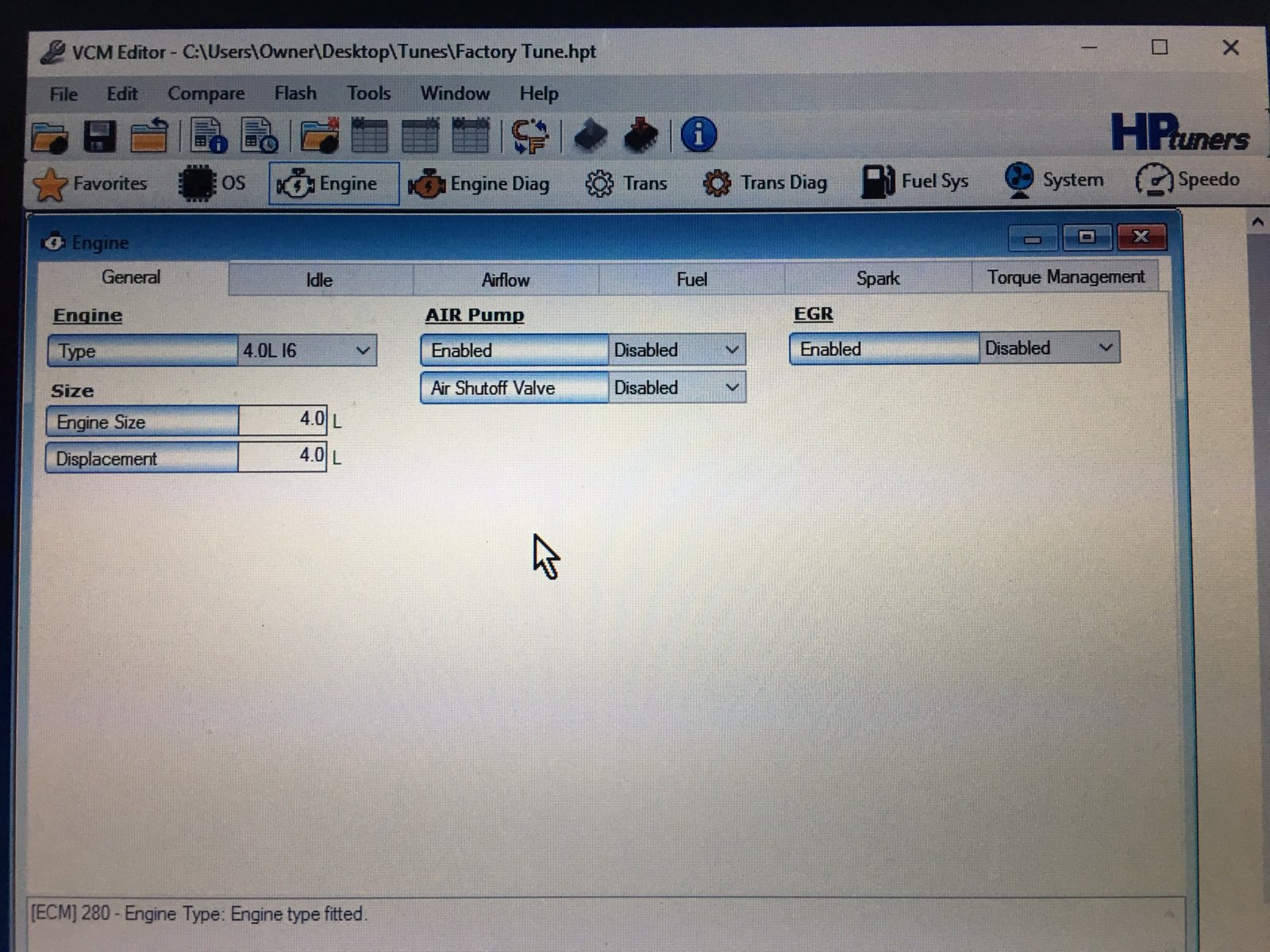

Here's a shot of some of the options under the "Engine" tab:

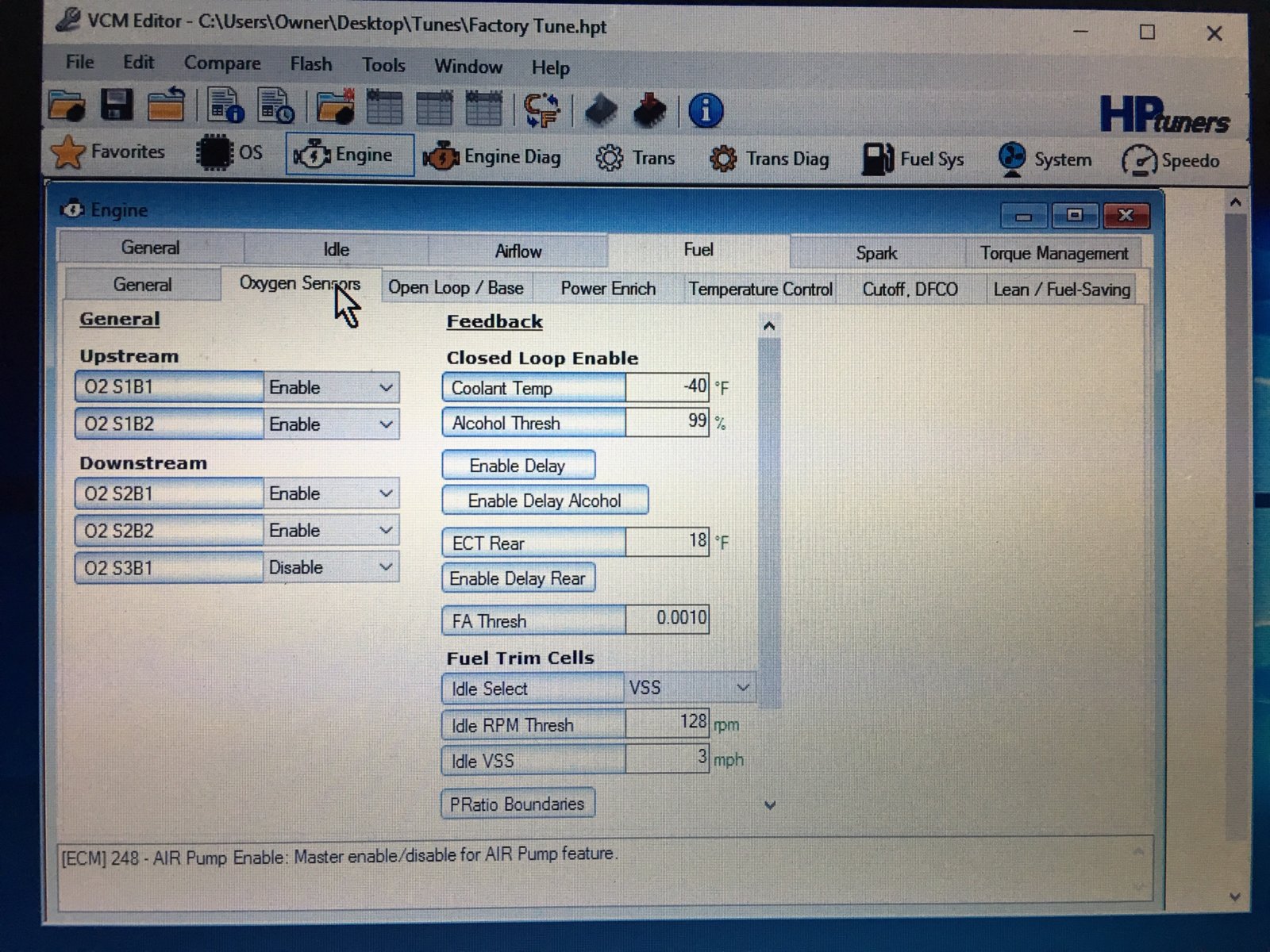

If you navigate to Engine > Oxygen Sensors, you'll see the screen where I was able to disable the post-cat O2 sensors:

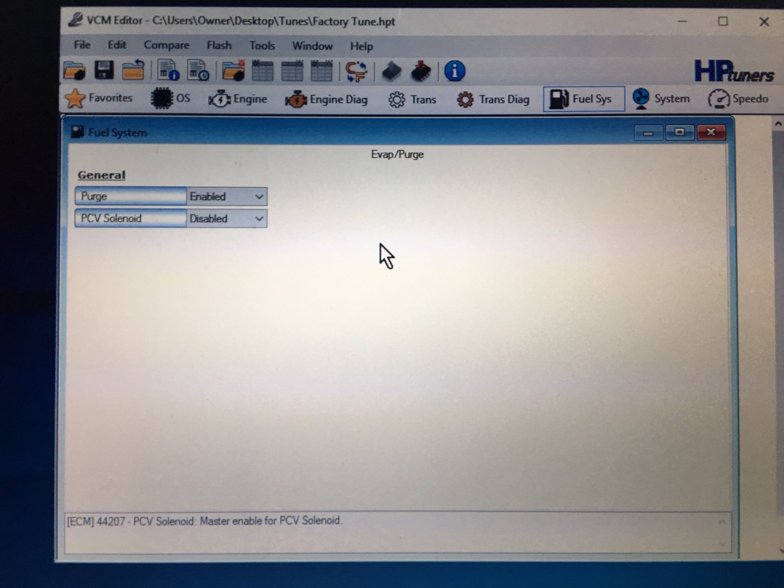

Head over to the "Fuel System" tab, and you'll see where I was able to disable the evap system:

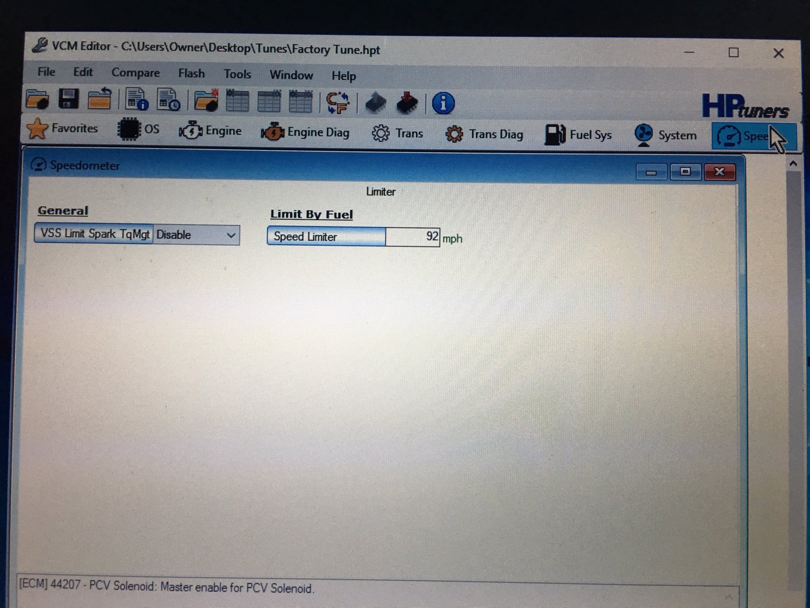

Here's an example of the "Speedometer" settings:

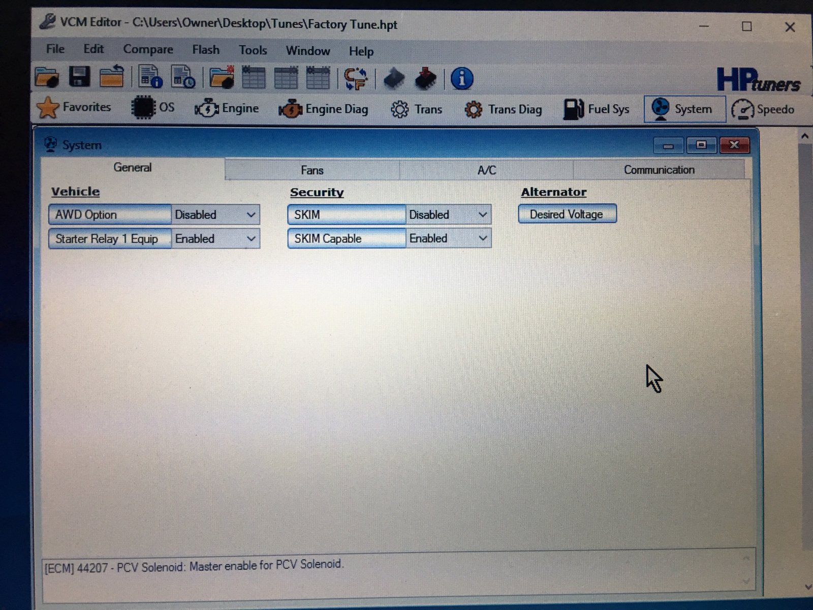

If you go under the System > General tab, you'll see the option to enable or disable SKIM (read this thread if you don't know what SKIM is: Sentry Key Immobilizer Module (SKIM) Install / Retrofit):

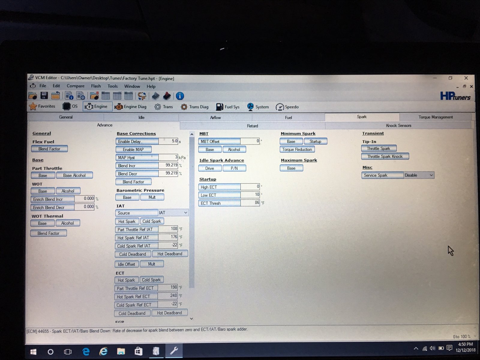

Check out all the options under Engine > Spark:

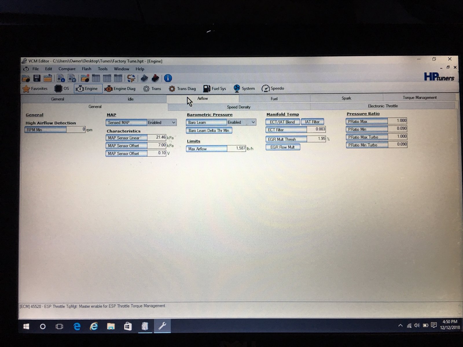

And here's the Engine > Airflow options:

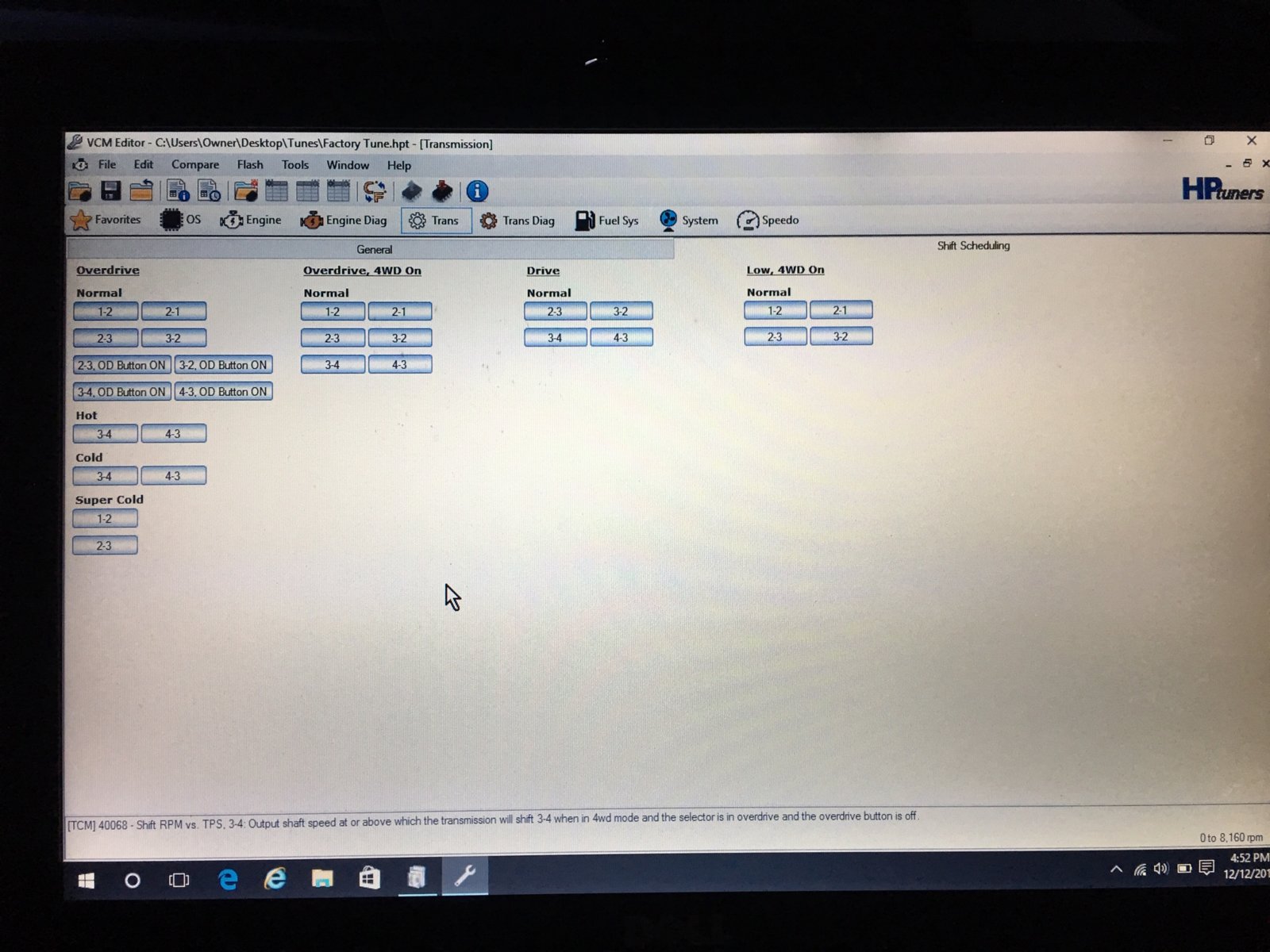

Here's the Transmission > Shift Scheduling options (haven't explored these yet as I'm not 100% sure what they do):
