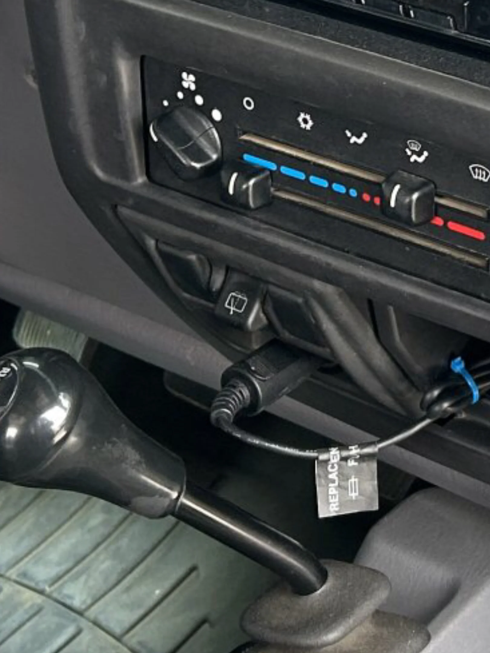

1998 TJ. Previous owner installed factory AC on my jeep. It works great, however, he forgot to install an on/off switch for it and the compressor runs even when I’m trying to run the heat. So in the winter I just pull the AC fuse. What I really need to do is install an on/off switch. Does anyone know of a good switch that would fit into one of these blank spaces on either side of the rear window wiper switch? If not, where would be a good place to install one?Thanks!

Just to be sure, in your pic you are set to defroster - which activates the a/c compressor. Does the compressor still run when you are set to “off” or “heat” only?
Correct, it runs no matter what position the two horizontal levers are in the AC compressor continues to engage.

Move both levers fully left, especially the top one. This should turn everything off. If it doesn't then you have another issue. Also, it looks like your fan control knob is broken, so maybe the fan isn't working right too. Although, I would be hesitant to say that the AC compressor should be on when you are not in the AC mode. I would take it to a professional AC mechanic and get their opinion of the problem, if moving the top lever to the off position doesn't turn everything off. Who knows, it might not be that expensive. My guess would be a faulty Compressor clutch. Or, maybe the wiring to the clutch has fused. In that scenario you really want to get it fixed right.
A cheap Mickey Mouse solution is never the right choice. I've seen so many problems caused by previous owners installing Mickey Mouse solutions to problems. It really frustrates and angers the next owner. Not only do they have to remove the Mickey Mouse solution, but then they have to find out why you did what you did, and what you did may have even caused more problems. No offense intended. Google AI basically says the same thing:
"If your Jeep Wrangler's AC compressor stays on, it could be due to a faulty AC pressure switch, a malfunctioning temperature sensor, a low refrigerant level, a broken cycling switch, a faulty compressor clutch, or even a problem with the electrical system controlling the compressor, which might need to be diagnosed by a mechanic."

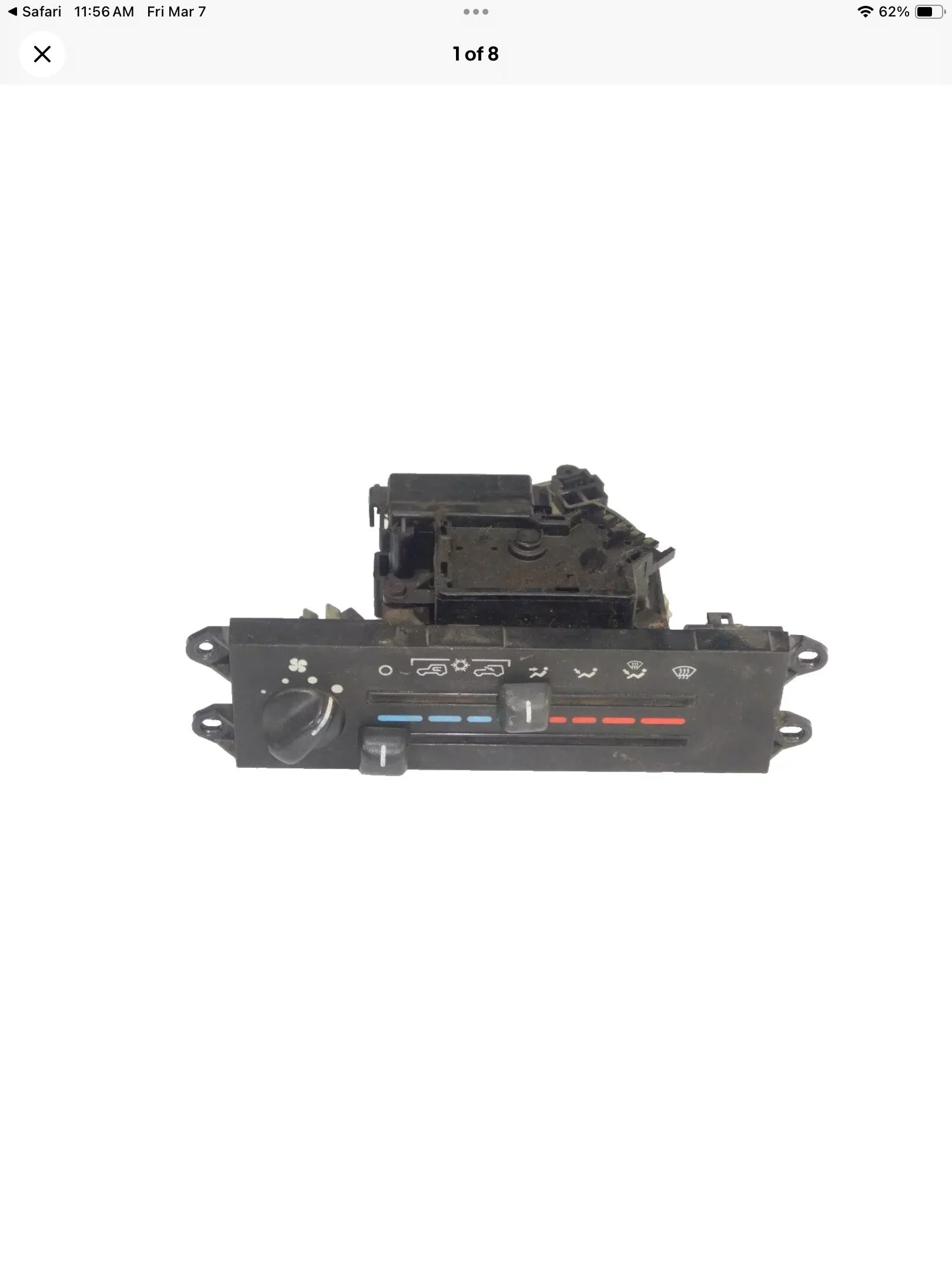

After a bit more research, I’ve discovered why the AC compressor stays on no matter where you have the upper slider switch. When the previous owner did the factory AC install he did not track down the slider switch that has the two settings for AC. Those two settings show the little snow symbol and either recirculate or fresh air. They also activate the AC compressor. I have the stock non-AC slider switch. The little snow symbol on that switch just allows fresh air to come in the dash vents. So I can either spend a bunch of money and get slider switch on eBay or just add an on/off rocker switch. eBay has a used HVAC control for $519!

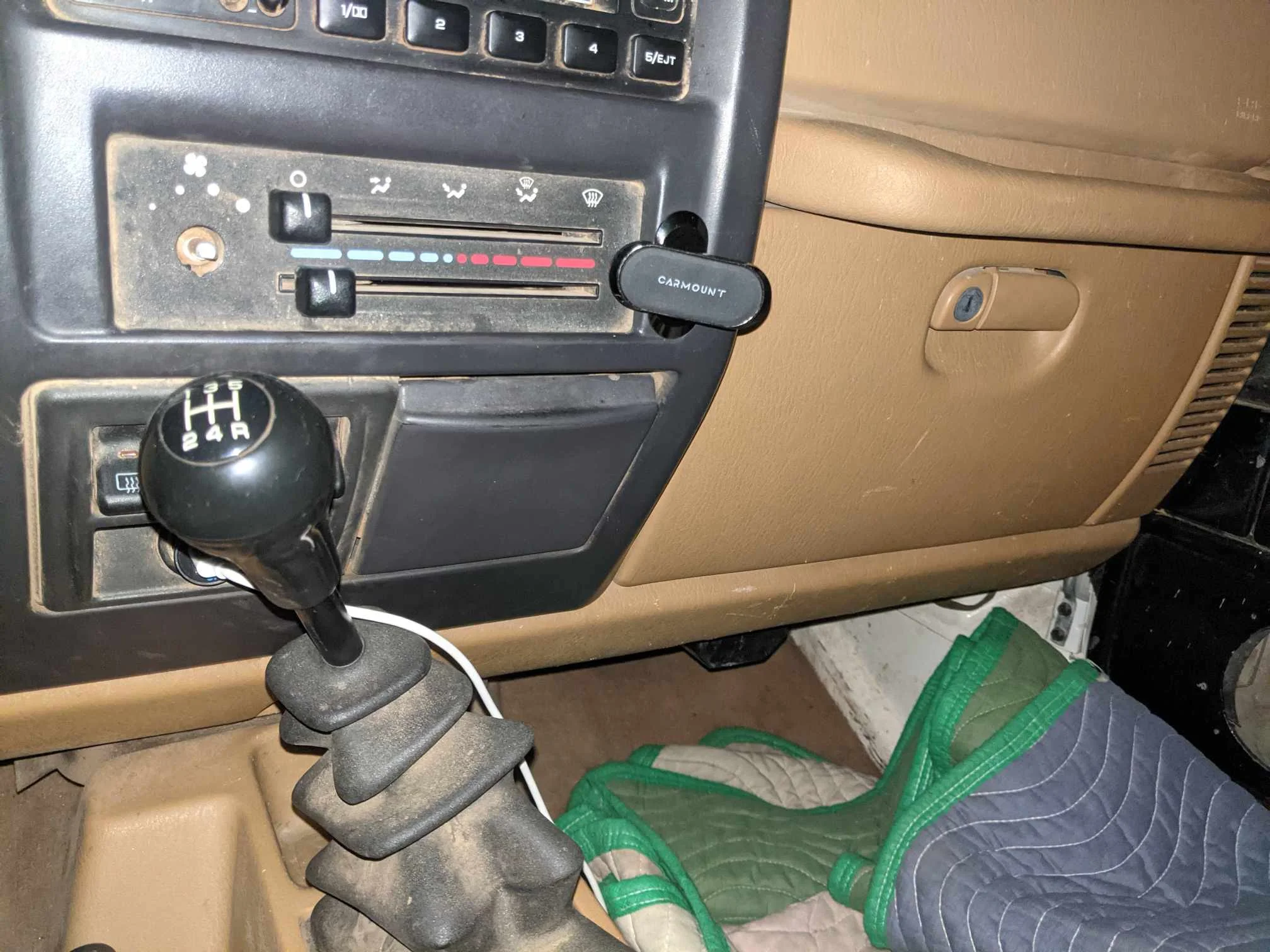

This is what my non-AC one looks like
Reactions: SSTJ
Ibasket, when I look on eBay that is what the non-AC typically looks like. I don’t know why mine has the little snow symbol for fresh air to the dash vents. I added a photo showing what the HVAC control looks like when you have factory air. I definitely do not have that control on mine!

Oh weird. I wonder what that one you have now is off of them

Yea, I noticed in your first pic that you had a different kind of slider-style than I had seen before. Maybe not from a TJ.
The ones you're seeing online are the style that came in 97 and 98 TJs. That's what I have. And yes, they often go for several hundred dollars on eBay. Your best bet is to find someone parting out a TJ who doesn't know that. I once picked one up for $35 that way. Facebook Marketplace, etc.
Or, here's at least a slightly better price.
