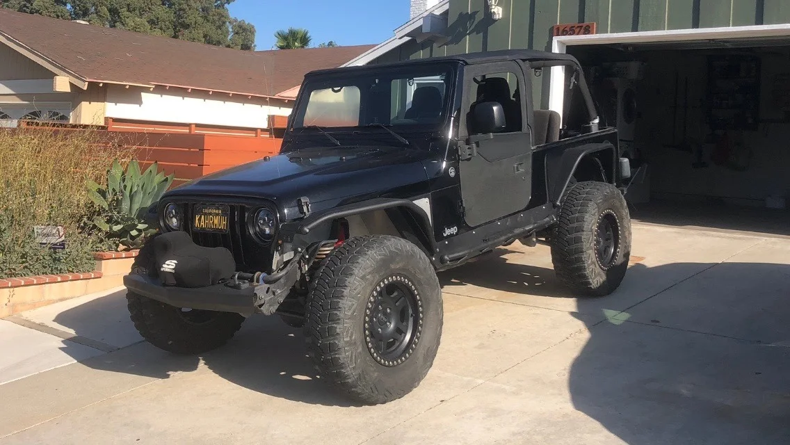

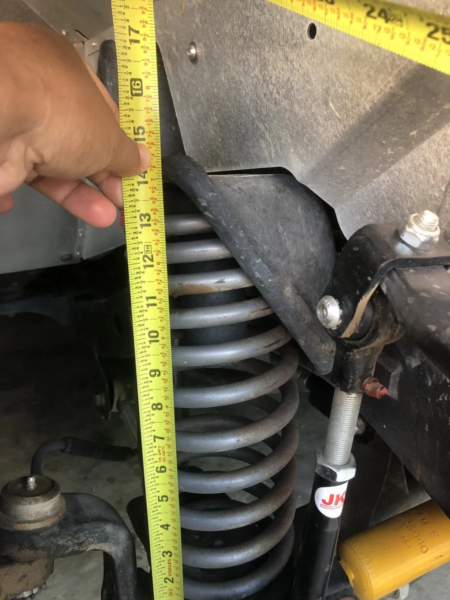

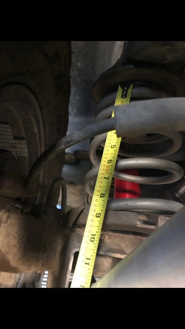

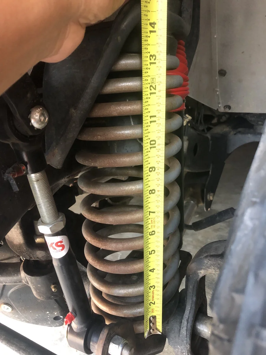

Ok Jeepers, need some suggestions and or recommendations. I'll try and be brief. (04 LJ Auto) I started with a Rough Country 3.25" SL 4 years ago (because I didn't know any better). Since then I've upgraded because I got Death Wobble last year but I still have the RC springs. I'm also on 50% life 35" GY Kevlar MTR. Well, I've also added some more substantial weight and didn't notice too much of my lift being gone until I pulled up right next to another LJ on 35's with a 3.5" Metalcloak SL and noticed our height differences. So, looks like I lost about half my lift and I just added 3" Rancho Shocks 5000x one month ago. And now I'm thinking of replacing my springs.
****** I'd really like to keep my shocks since I just got them but a little open. Which Coils Springs do you guys suggest? 2.5" OME HD, 3.5" Metalcloak, JKS 3", Savvy 3" or something else? By the way, nothing personal but I don't want a Body Lift, I know the added benefits but I'm ok without it. I do moderate wheeling with some rock crawling but mostly trails. I've included some pics while in the garage on level ground. And the rear measurement was taken with the Tire carrier and 35" tire NOT on the jeep. Any and all suggestions appreciated, Thanks
Metalcloak fenders all around and 4"flares
Metalcloak Rock Sliders
Heavy 3/16" Zombie looking steal from Bumper probably 50 lbs
Superwinch Tiger Shark 9500 synthetic rope 70 lbs
Genright Drop down Tire carrier
Dirtworx Rear bumper
Currie/Savvy Arms all around
Adams custom rear DS and SYE
Barnes4wd Bolt on Skid
jks Tracbar 3.5" limit
Currie steering
JKS disco's

Our jeeps look about the same weight-wise. I tun currie 4" spings and they netted me exactly 4 inches f/r so they would likely put you over your 3.5 Torrance. (mine measures 16 Front 12 rear)
Stock is 12 front 8 rear. It looks like your at 1-inch lift... I haven't heard anything bad about MC springs from anyone who runs them. (or any of the other brands suggested for that matter)

Doesn't the 3.25" kit come with a coil spacer along with the springs? Is that the coil spacer in your pics, or the stock isolator? Either way, you should have the spacer and isolator in there.
It probably did but the shop that did the lift for me gave me the bare minimum parts. No control arms and I was charged separately for the TC drop down kit.
With the weight of the jeep known you can pick a correct spring. Without the weight known then shove a spacer in is the only way you can expect to get the lift height you want. Weigh it. Front and back.
