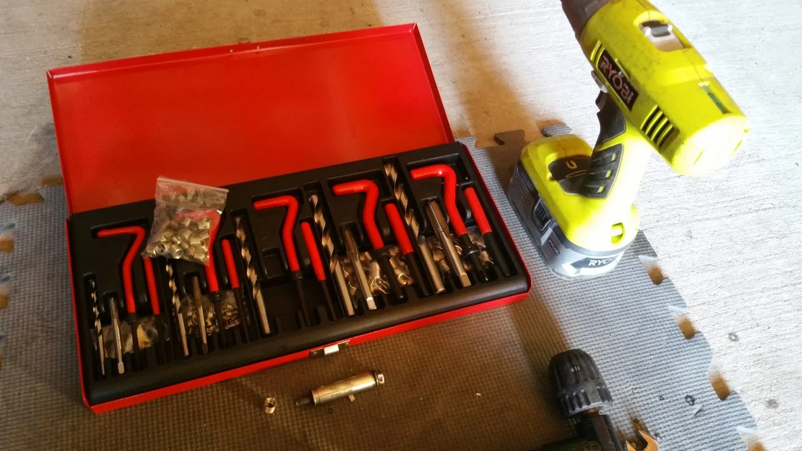

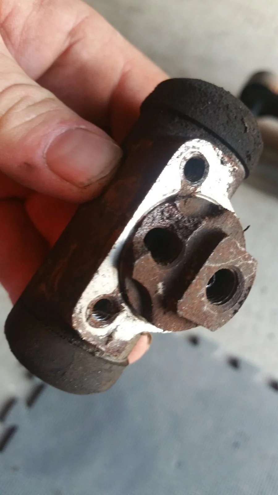

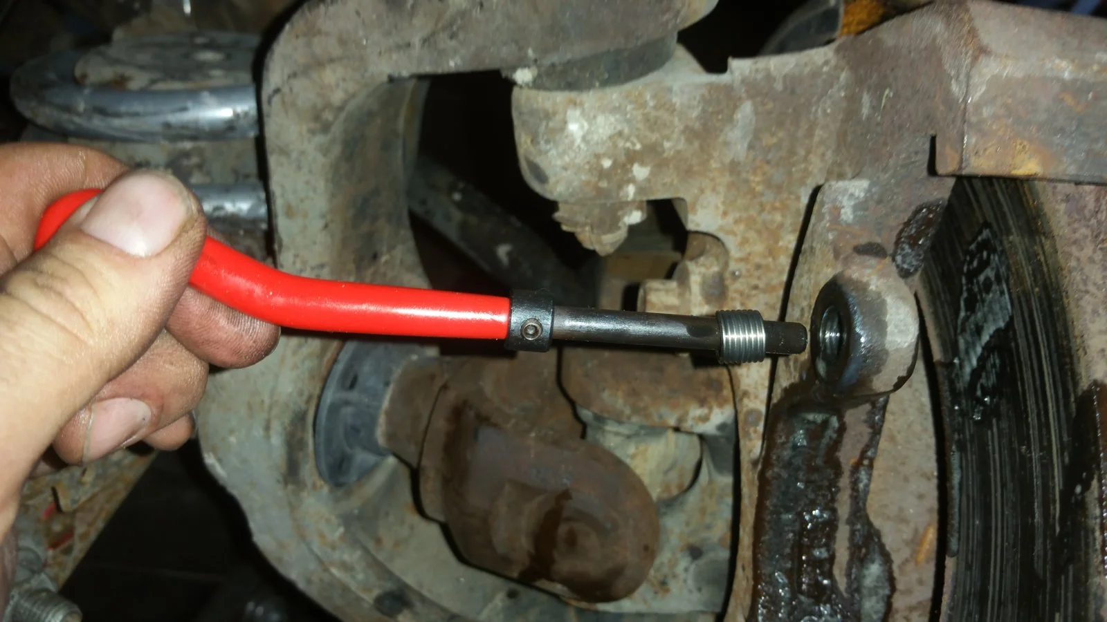

Also found I had a stripped thread for the front break caliper in the passenger knuckle? So I only had one bolt holding it secure, drove it that way quite awhile. Did I mention that the driver back wheel cylinder had busted out the casting around the bleed screw so I had disconnected it and capped the brake line. Finally researched and found a heli coil kit, 35 bucks on Amazon.View attachment 32394Well my add, adhd, rdbd kicked in and a squirrel ran by, (you know they are still pissed at Lucky), and I drilled out the wrong thread! Imagine that. So I had a little extra practice at heli coiling! View attachment 32395 This is where the casting broke off the wheel cylinder.View attachment 32396
For future reference and anyone following along, wound wire inserts work much better in blind holes where you can't have a burr on the bolt that will thread them out the other side. You want a solid threaded insert for through holes so it can be locked in place with thread locking compound. The compound can wick through the wound wire inserts and cause other issues. EZ Lok, Time Sert and others of that style work best in through holes.

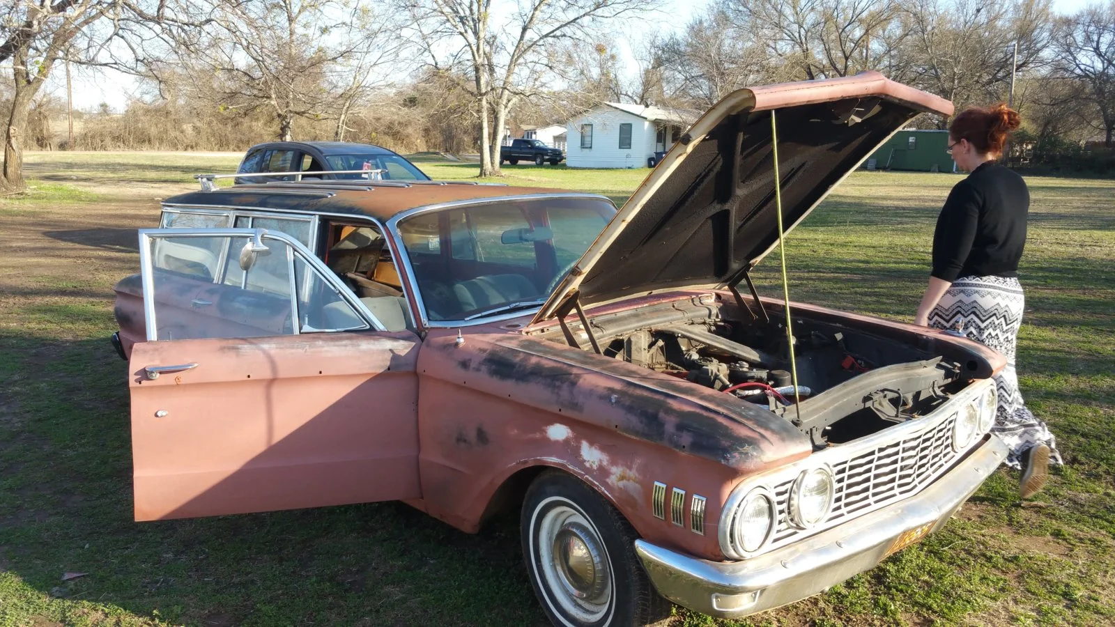

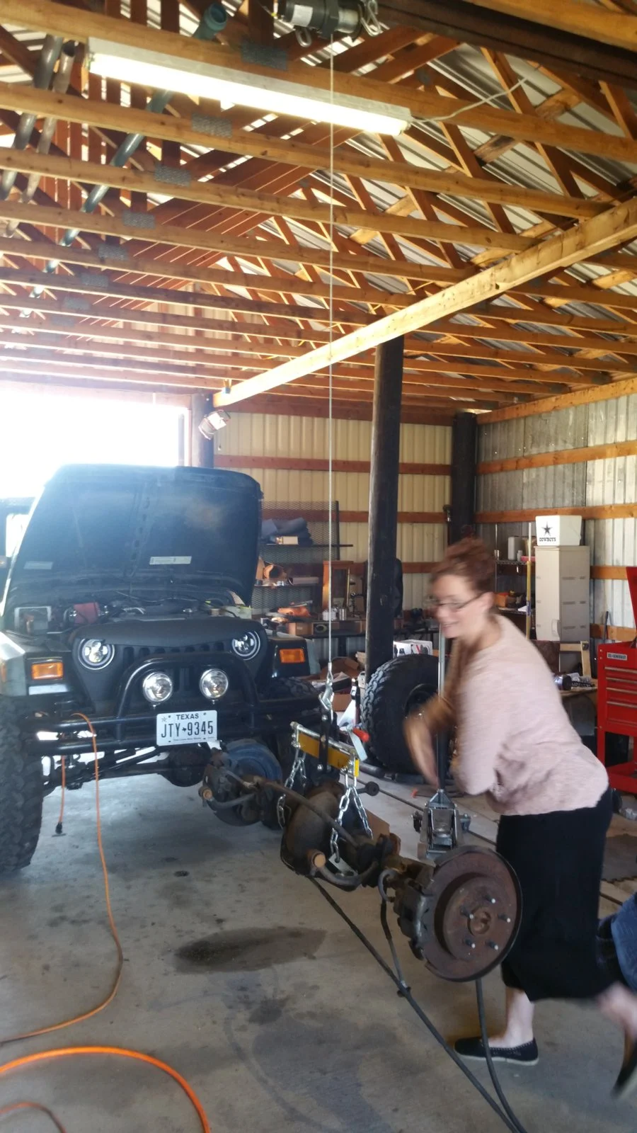

Well Im sticking with 36-37's so I found an 8.8 to put under her. Happen on it while buying a 1961 Comet Wagon to restore for my fiance to use for her interior decorating business. Like I need another project!
I am going to 35s next and though Yukon says that 35s are OK on the 8.8 stock, they recommend the ultimate 88 kit for anything bigger. I really want to get that next but it's hard justifying it when I'm still on 33s

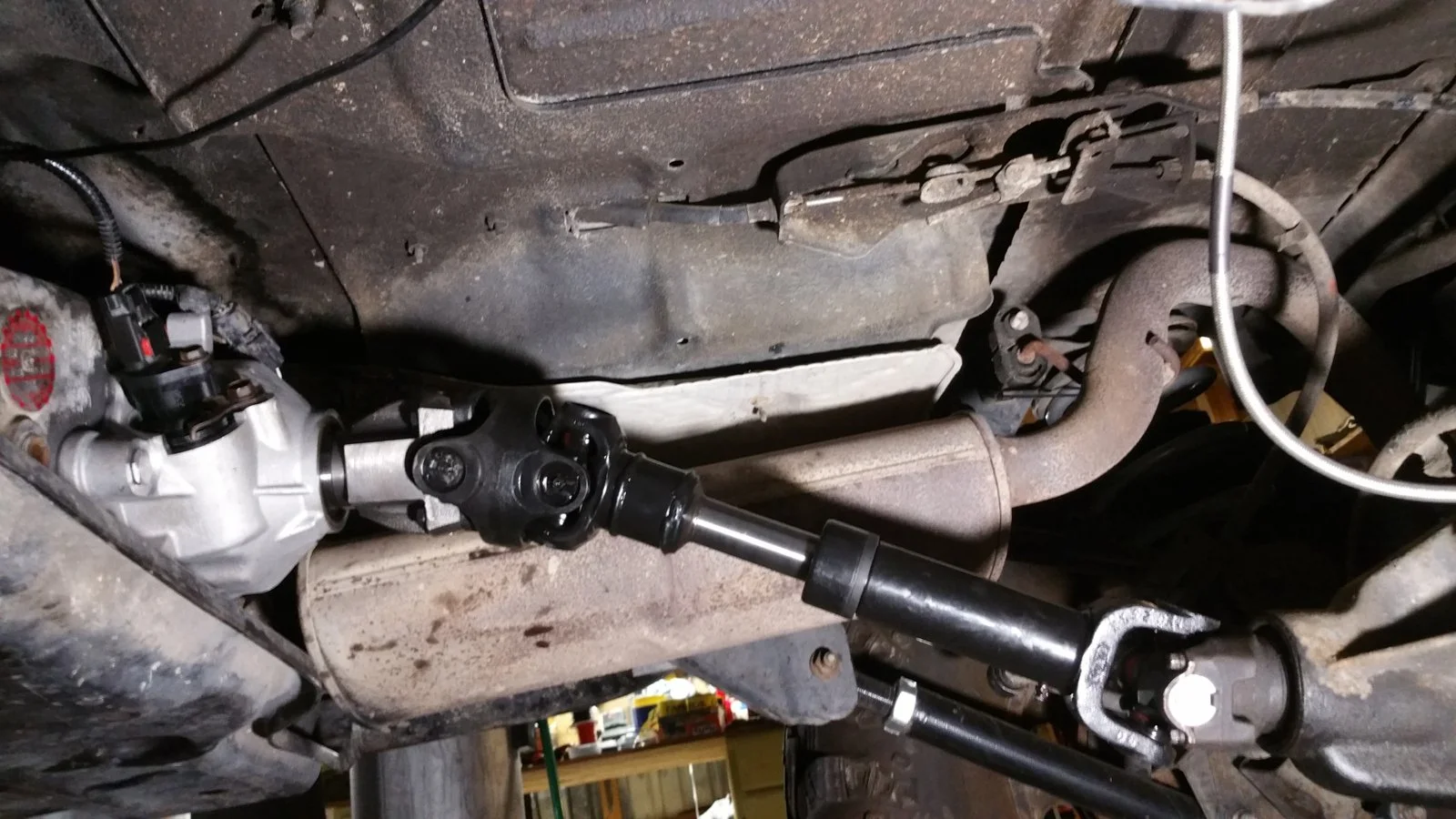

Ok finally installed the Rough Country SYE and drive shaft! Wow what a difference. Took out the transfer case drop as well. No vibration at all!
Yes I did adjust the pinion angle after I took the pic. ;)

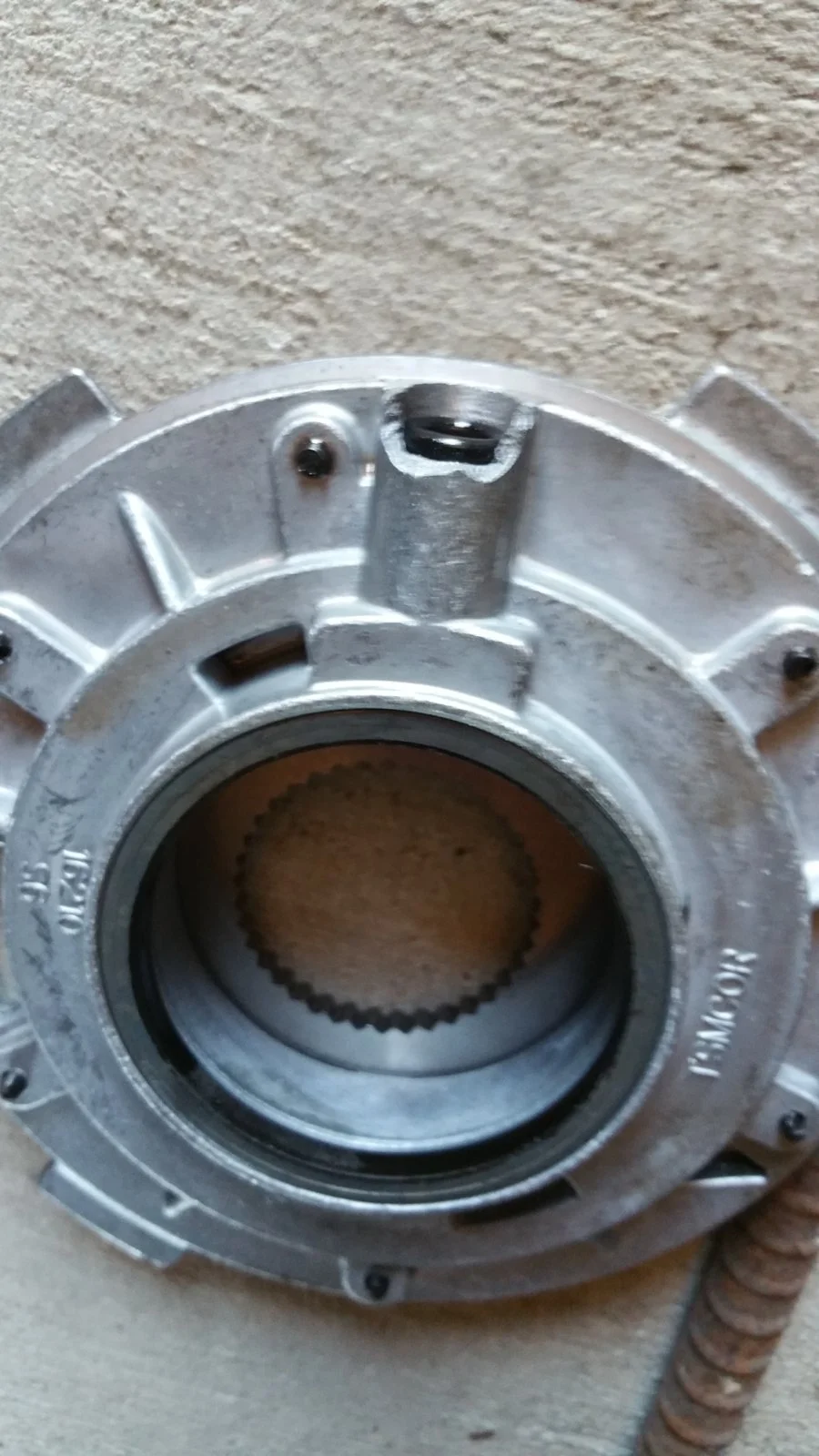

But on the pump a side of the intake tube casing broke off. The tube still seated in and felt snug but does this happen alot or Im I just lucky?

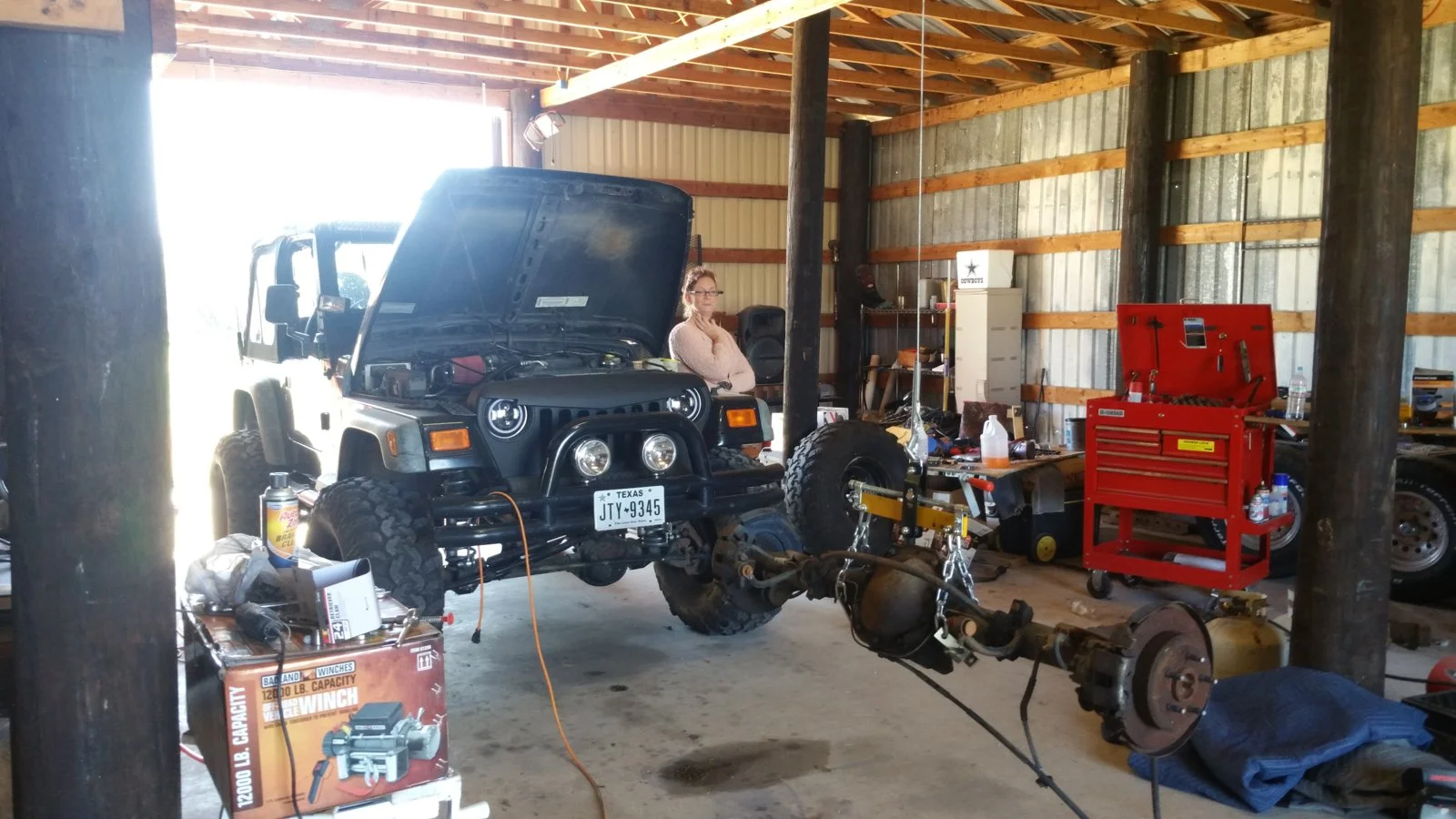

Had to get the vibration out after the lift, fiberglassing the dash, Im swamped at work, and my Jeep came with 3.07's and Im running 36x13.5x15 super swampers so 4.88's going into an 8.8 is my current project then Im going to focus on the stroker.
My SHG was throwing up a bicep but a took the pic to soon! Lmbo. Its nice that she supports my addiction!
