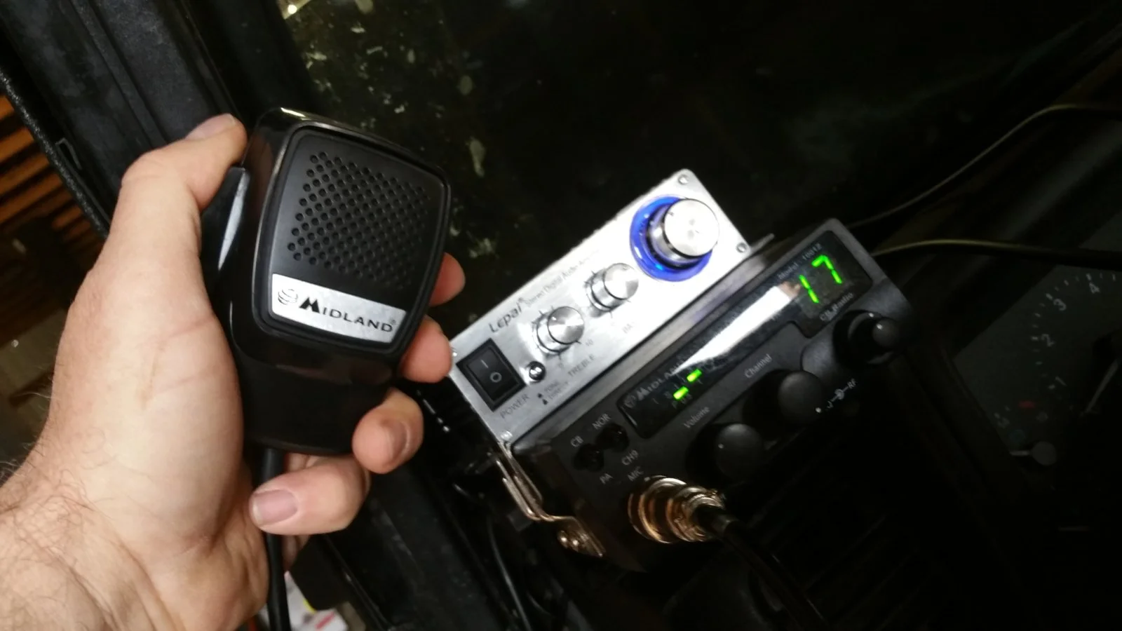

Wow if its not one thing its been another. But finally installed the two LED antennas my SHG bought me for Christmas. And put in a 20 watt amp for the PA.... yes it was well worth it! I can scare the raspberries outa kids walking home from school, old people walking outa Walmart and especially any highschoolers I see parking. Lmbo.

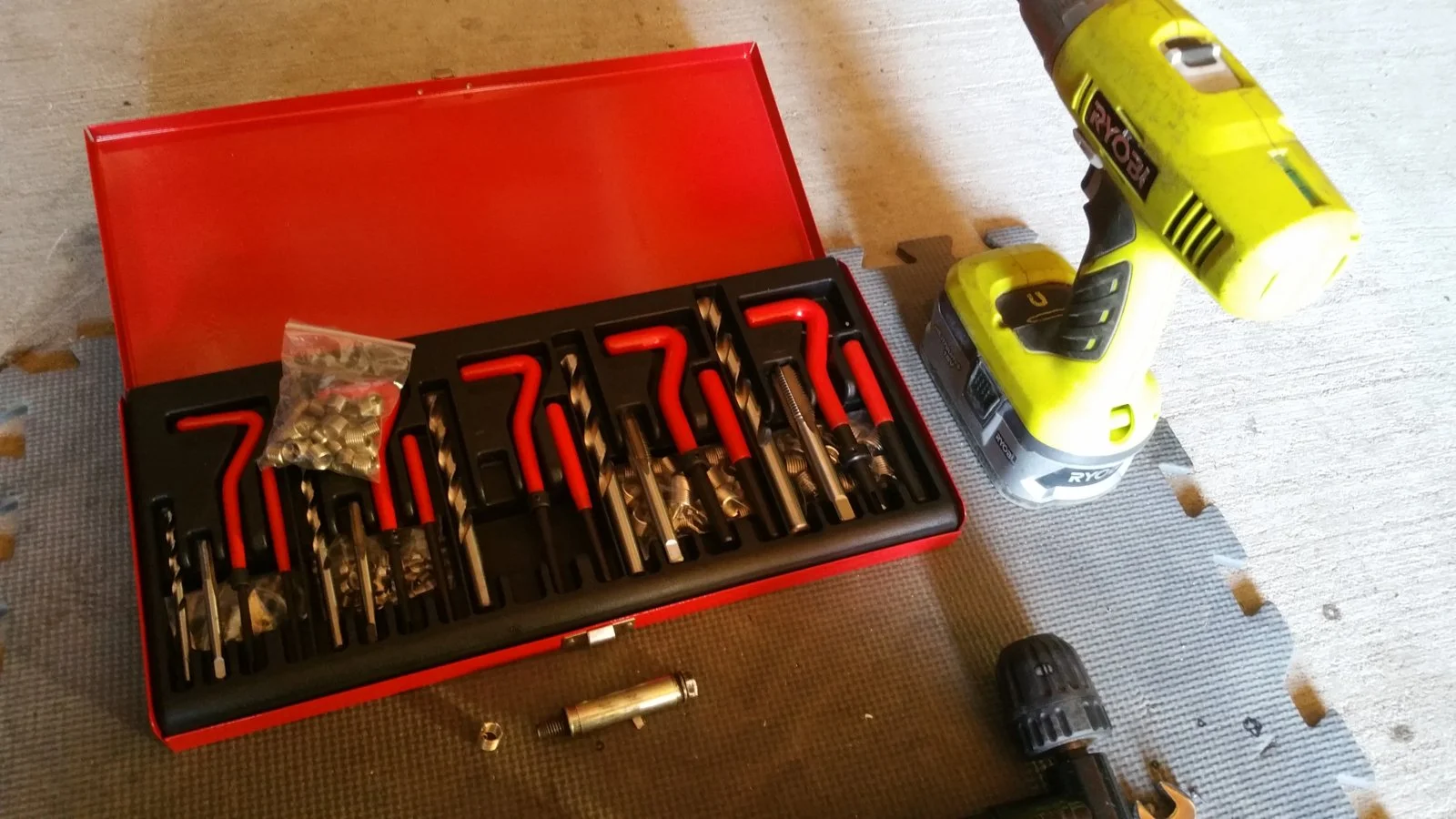

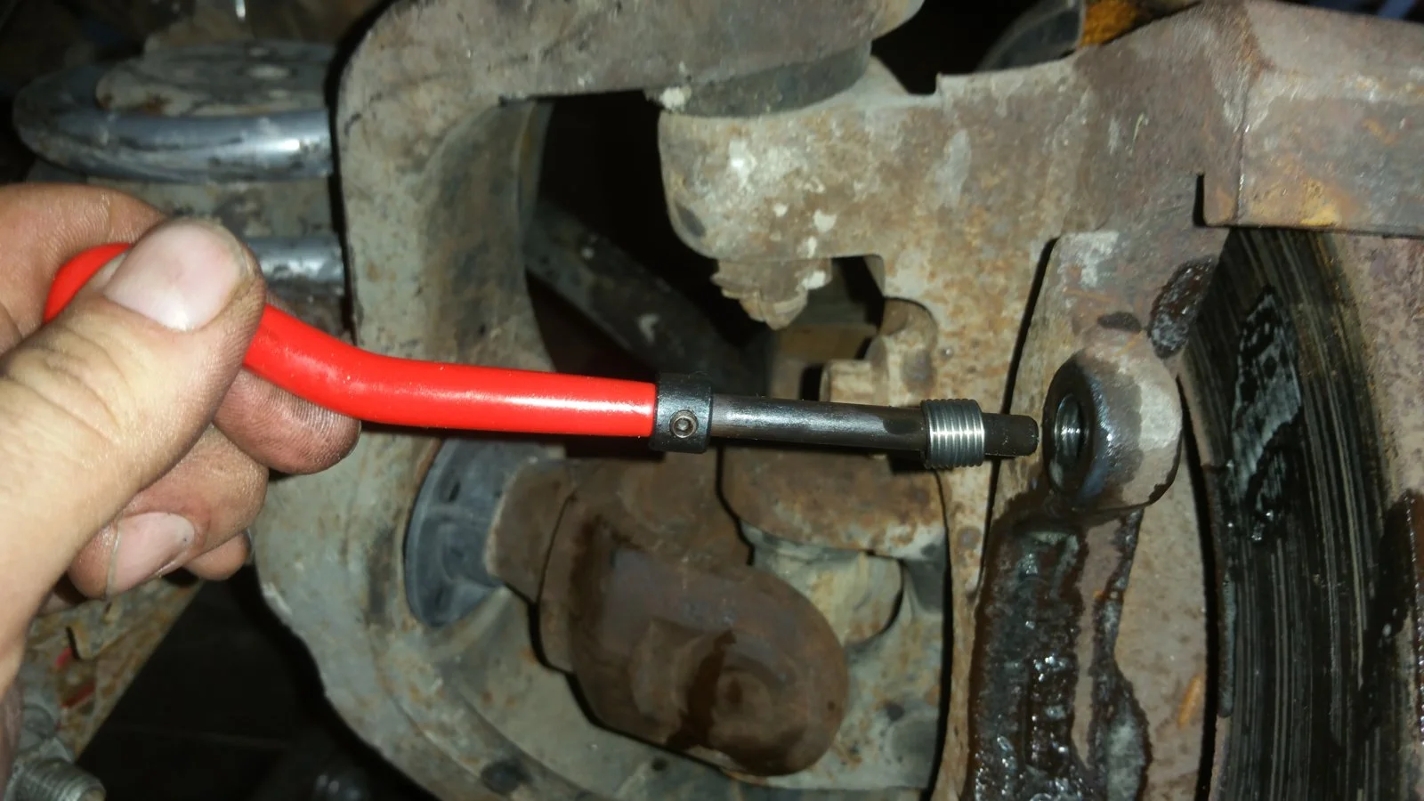

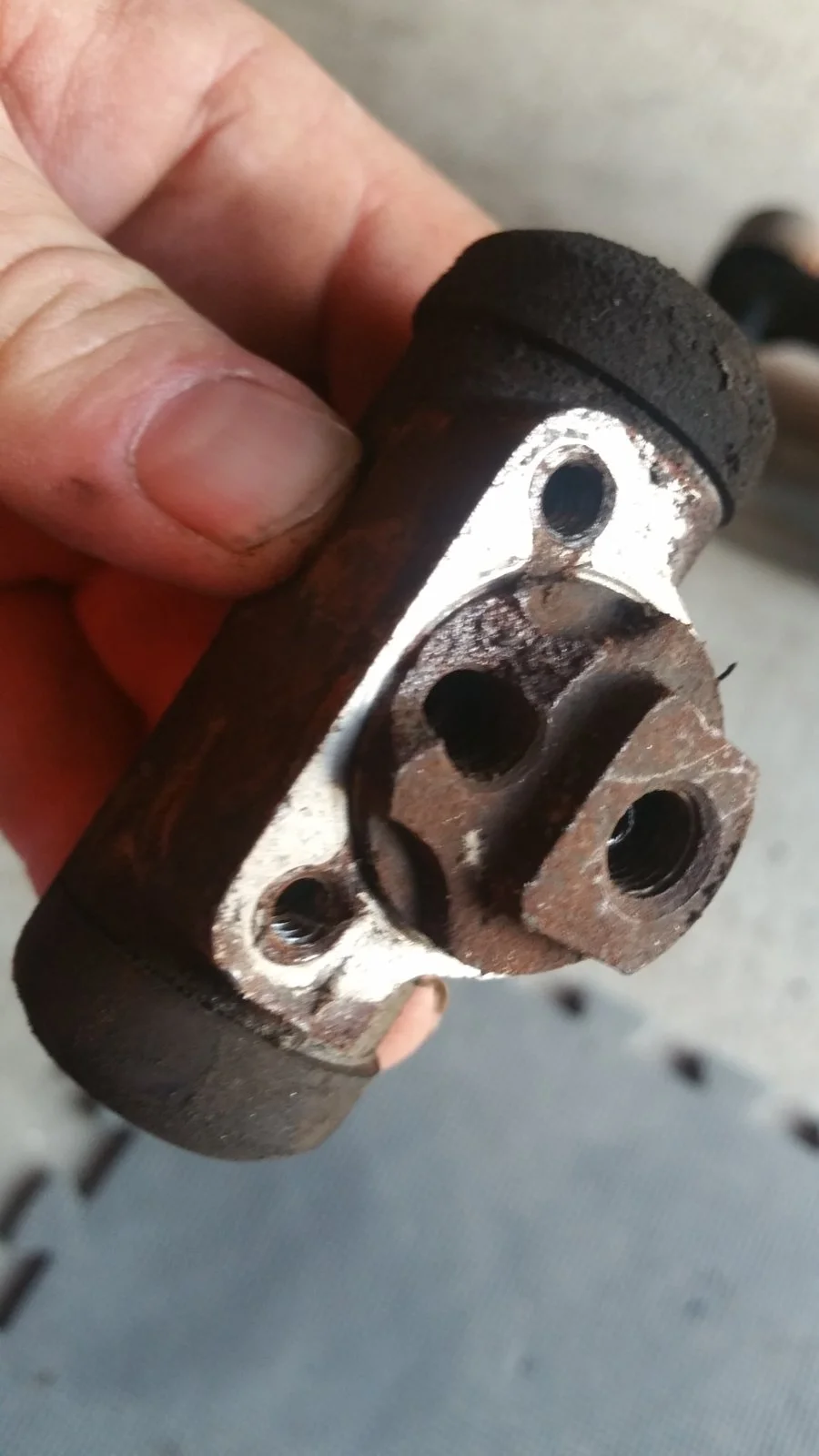

Also found I had a stripped thread for the front break caliper in the passenger knuckle? So I only had one bolt holding it secure, drove it that way quite awhile. Did I mention that the driver back wheel cylinder had busted out the casting around the bleed screw so I had disconnected it and capped the brake line. Finally researched and found a heli coil kit, 35 bucks on Amazon.
Well my add, adhd, rdbd kicked in and a squirrel ran by, (you know they are still pissed at Lucky), and I drilled out the wrong thread! Imagine that. So I had a little extra practice at heli coiling!
This is where the casting broke off the wheel cylinder.

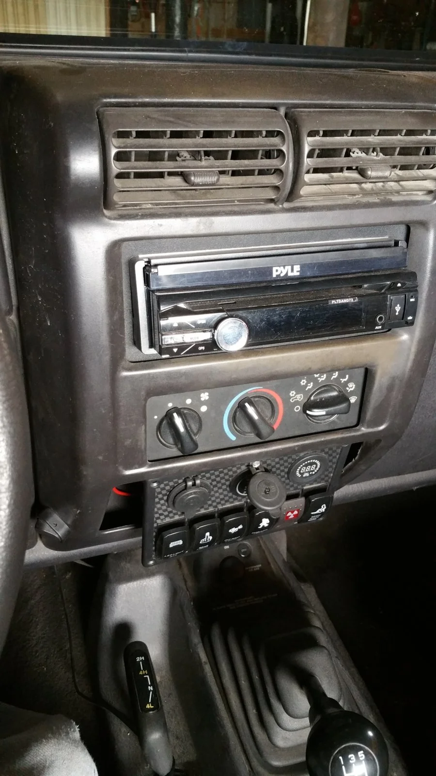

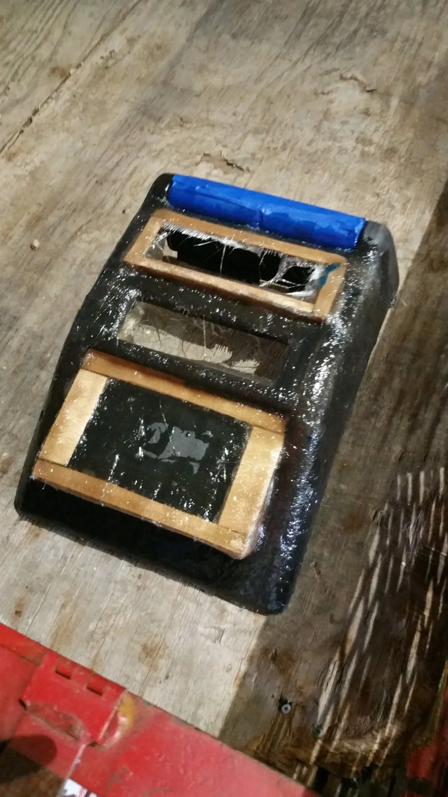

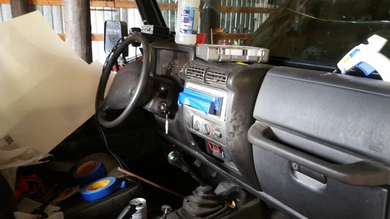

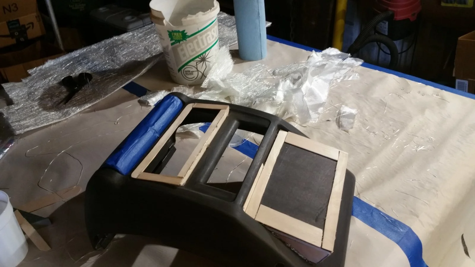

Today I finally aquired enough supplies and youtubing to tackle modding the dash to properly install my 6 rocker switch panel so I can install another 6 switch panel under it. What can I say I ran outa buttons for cool stuff!
Now to let it cure overnight and hit it again in the morning.
