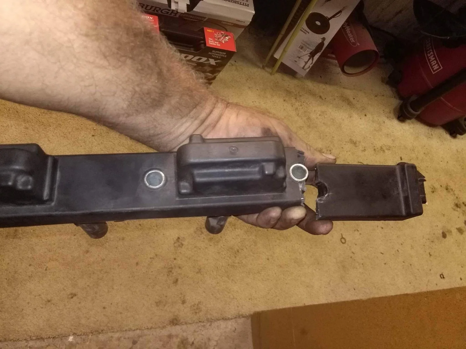

    Ok so I finally download the alarms instalation manual and figure out how to get it in valet mode. The head and dash lights werent working, the radio quit playing, and it still wont start. Ugh. I play grab and pull under the dash and the left side speakers start working. Im holding on to the light swtch and stretch around to see if the lights are on and see a flash reflected ofd the tool box. I wiggle the switch intensely and the dash lights flicker every now and then. Its the stupid switch. So now Im thinking there may not be any connection between the no start and the inside problems. I go and check, again, power to the plugs and nothing. Then I notice what looks like a hair line crack in the coil pack bar. I pull it off and start to put a little pressure on it and it snaps into. Wow. I put the old one on and it fires up first try! Are you kidding me! Talk about foreplay..... Check everything and take it for a test ride....Jeeps are fun! received_872732402891967.jpeg 20170809_210714.jpg

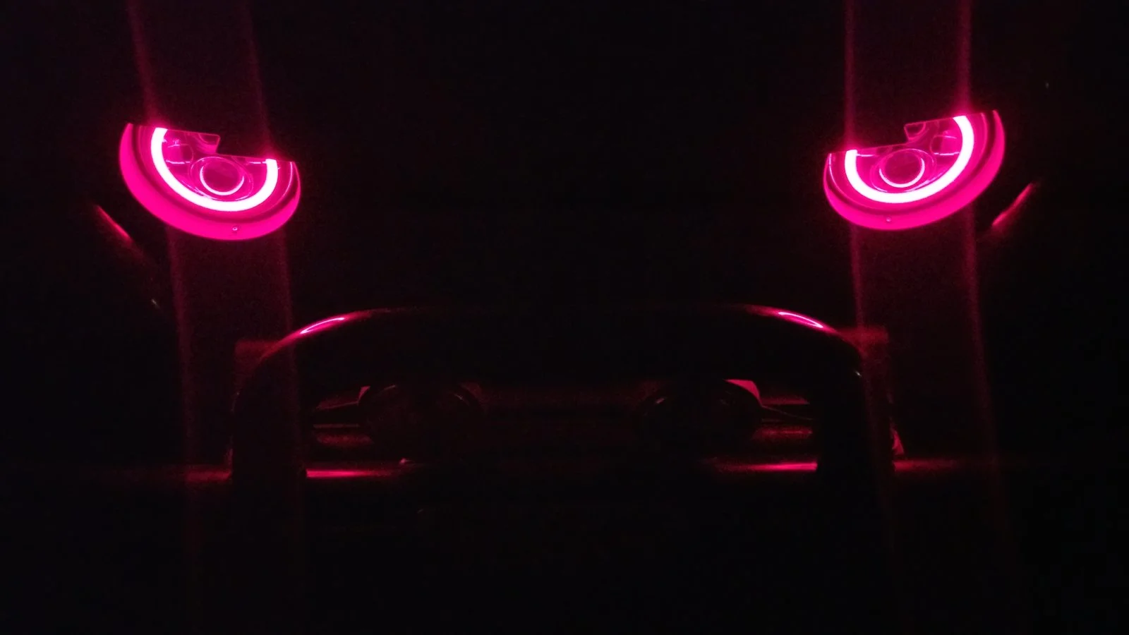

    Oh yea, the new mods! Lol. Oh chit handles, (broke in rather well today!), and an Alien Shade full bikini Top! Loving the 7" halo lights! 20170813_151849.jpg 20170813_151935.jpg 20170813_214515.jpg

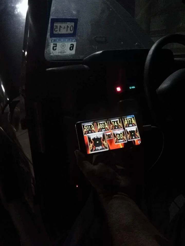

    FB_IMG_1503013216758.jpg Ok so now Im looking to fab a tablet into the dash somewhere. I plugged the bluetooth into the ecm port and fired up Torque. Found out the speedo is 4.5 mile an hour off!. So now it makes a little more sense as to the sensation at 75! FB_IMG_1503013216758.jpg
