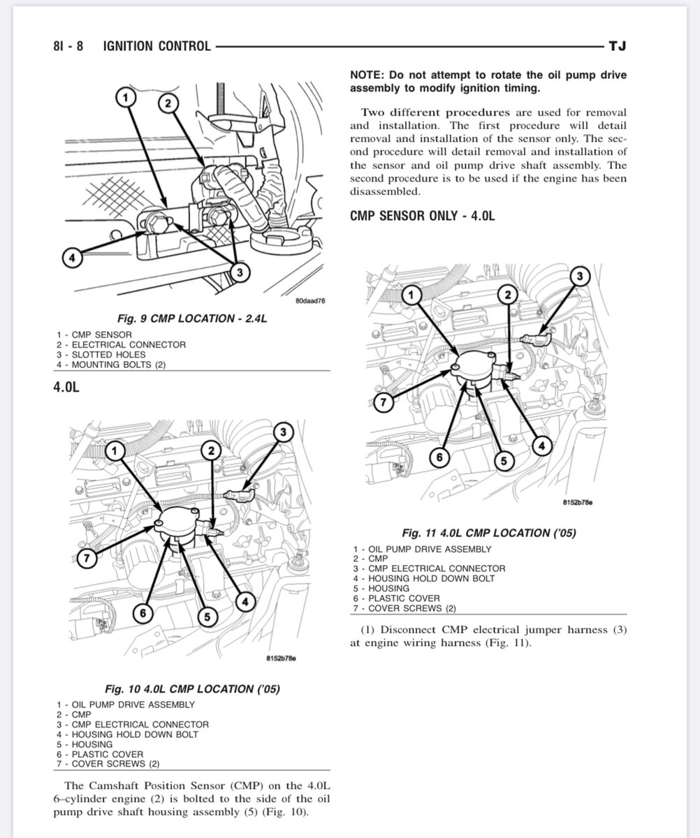

Is it possible to just bump up the OPDA a few degrees the way we used to set timing in the school parking lot? Just a blind advance (or retard) of a few degrees to get them to read within the same time frame? I know this would be far from ideal. But if no relearn tool is available is there a plan 'B'? It could take a few tries to get it right, but would just that small alignment correction cure the timing issue?

The FSM says specifically not to in the top right, but mine was off from before I replaced the OPDA and had to work with it a little.

I recently replaced my OPDA on 2006 Rubicon with the Crown unit. Had a few mis-steps along the way: when trying to remove the CPS from the original OPDA, it snapped. Installed OPDA with Crown CPS, found that the jeep moved and I couldn't align the new OPDA in the same position as original (manual, in gear, ugh). So I attempted to blindly align things. That didn't work too well, as it went into limp mode when I test drove. Went back, found the flywheel mark and TDC mark on the block, and realigned everything (I was like 180 out of sync). Also, I installed a NAPA CPS since the consensus is that the Crown CPS is suspect. Drives fine now! No limp mode. Of course I've only done a quick test drive since its still winter here and the snow's too deep to wheel...
Wondering... do I need to find someone with a DRB tool and do a relearn still too?
