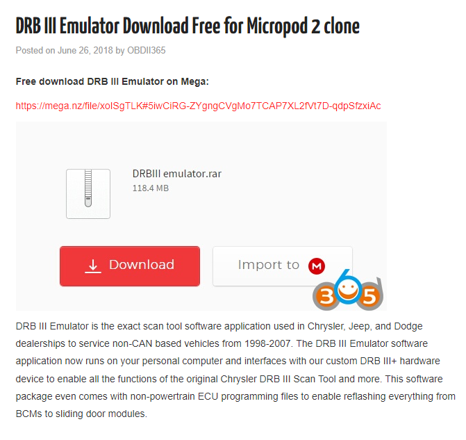

Surely recreating the drb3 functionality isn't beyond the capability of someone... I feel like a tuner manufacturer or @Wranglerfix could do it with some windows software and a pre existing USB to odb2 cable. Am I crazy?
Someone already has it - but not sure how good the reverse engineering is. I had found and bookmarked this link a while ago when I went crazy trying to fix the harmonic vibes issue.
https://www.controllertech.com/products/drb-iii-emulator
Only way to know how good this is to compare against how it does against a real DRB III. Other than @mrblaine, I don't know anyone on the forum that has or knows someone who has a DRBIII + knows how to use it properly. Those DRBIII tools should last a while ... but like everything else electronic, one day it will fail to boot.

Nobody reverse engineered anything, the DRB emulator is Chrysler software that is free.
Are you sure what you linked to is official Chrysler software? Does not look like it. I would be surprised if Chrysler benevolently open sourced their proprietary software completely free for public use. It is either illegally copied and shared, or reverse engineered. Scan tool makers may perhaps have some agreement with Chrysler for that information but I do not know much in that area and so a just guessing.

You can download the same emulator from Chrysler, I didn't look hard for the link, I think it's called tech authority or something. I've run it but was hesitant to buy some clone wiTech and really didn't want to pay the subscription or spend the massive amount on a real Chrysler wiTech. I hear what you are saying about the complexity but it really is just expensive and honestly getting one of those cheap chinese ELM things to talk the right language can be equally difficult.

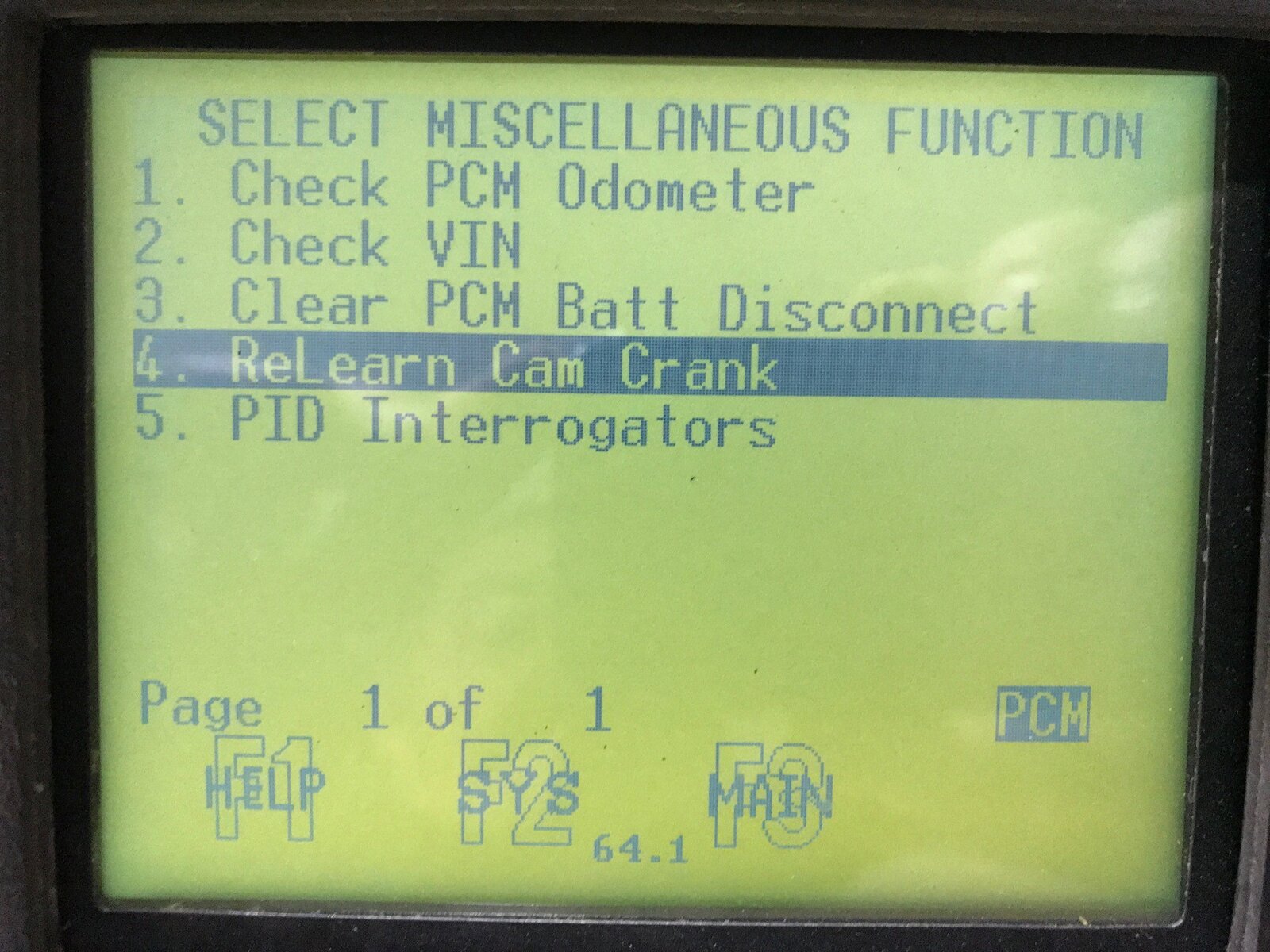

There really isn't any relearn process.
There is when I plug my DRB III into my 05 LJ Rubicon:
I can't figure out what it does, though. The engine has to be off to do it, and not much happens, other than you get a message that it's done after a few seconds...
Perhaps it just sets a flag used by the PCM to do something the next time it's running?
