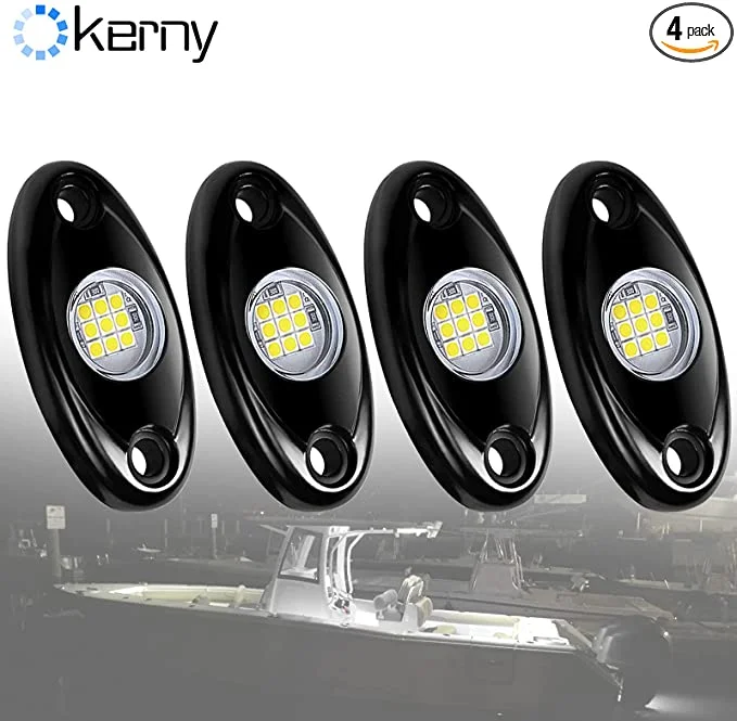

I just got a TJ and one of the must-have things is Lots of Lighting inside. I will run a wire from the footwell switch on the lights switch ( ccw turn ) to a relay and from there heavier wires and lamps in strategic places. If you look in Boat stuff companies you will find awesome solid products.
Is there more stock interior lighting than the dome lights ? Burnt out lightbulbs someplace? I want a lot more interior lighting without using a flashlight. Plus when I open tailgate, dome lights dont go on
Check this out....... ( Okerny boat lights )
