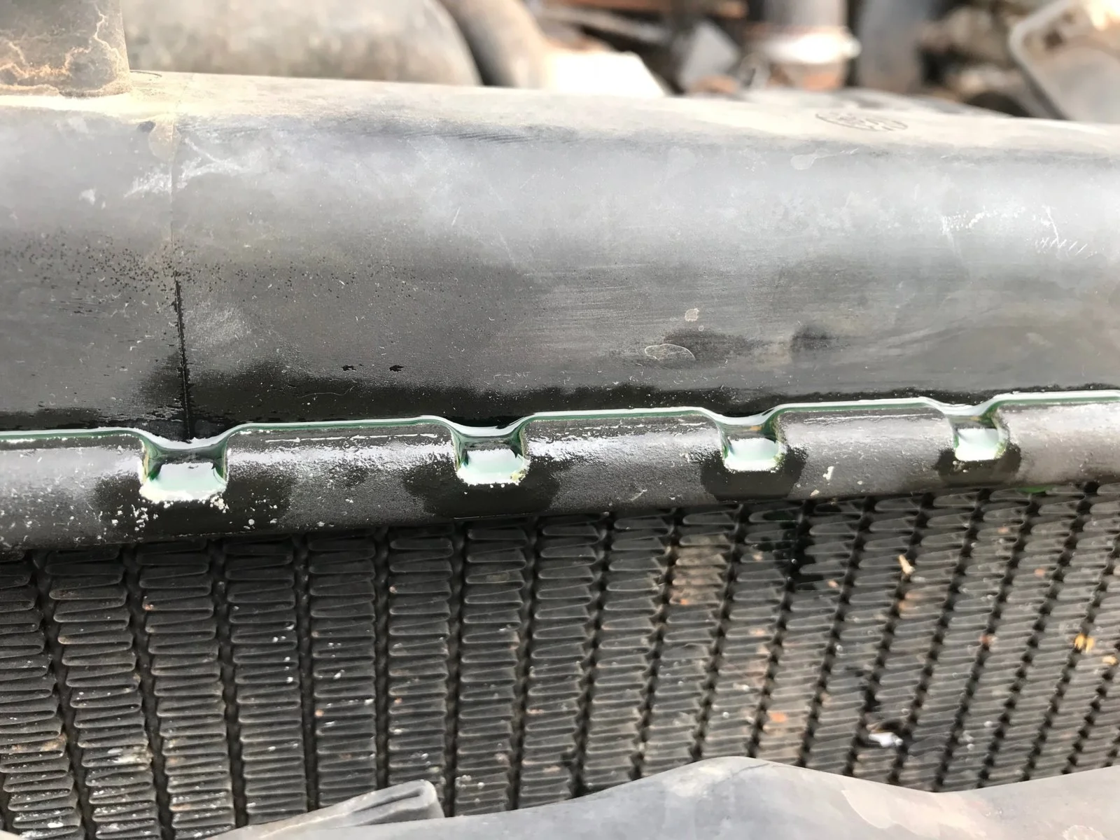

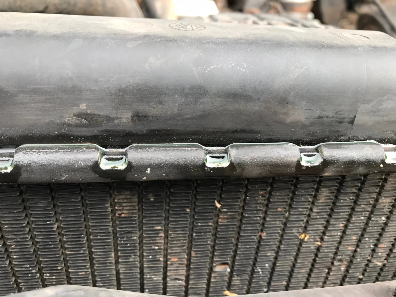

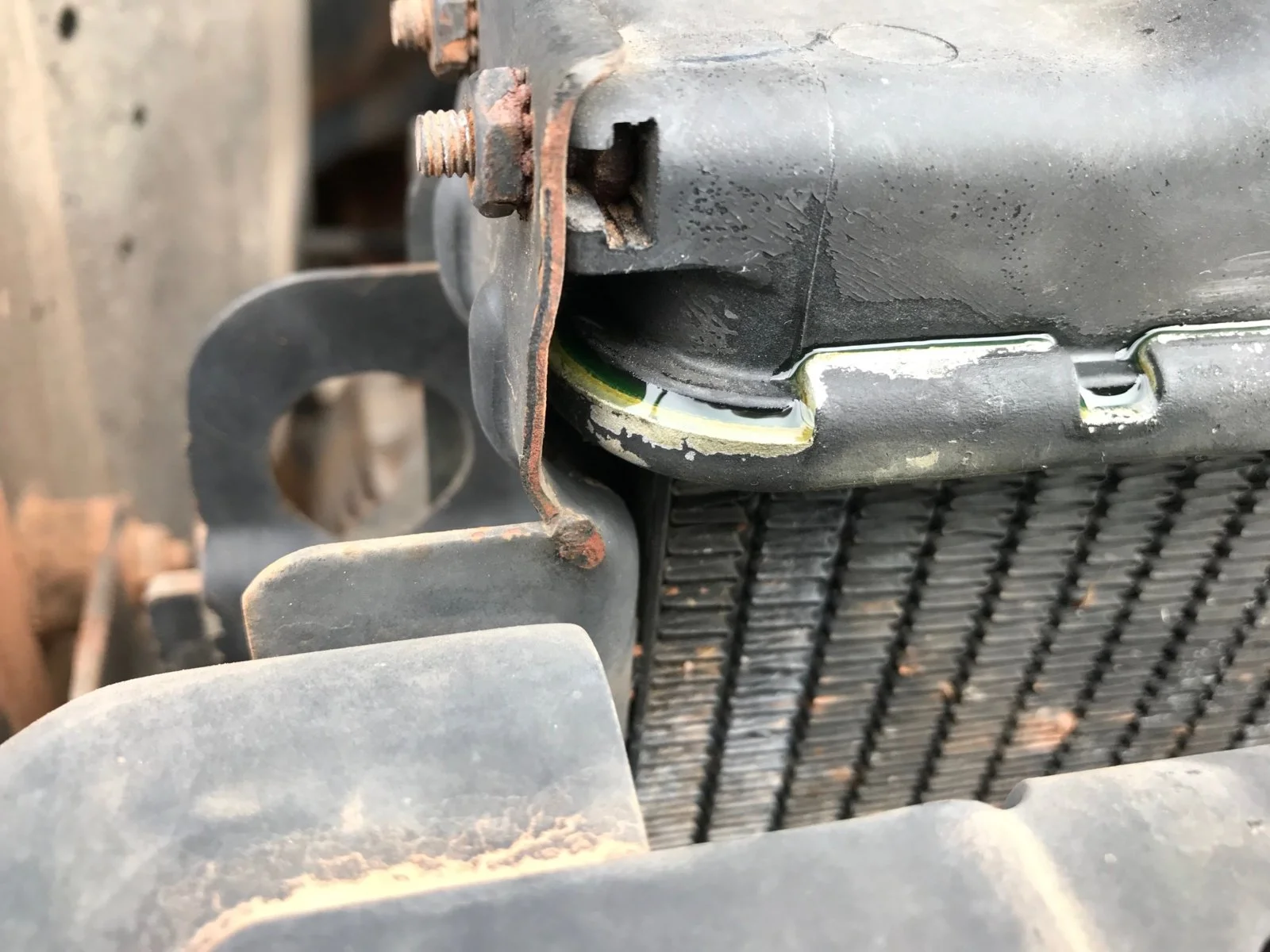

I ran the engine for 5-10 minutes and watched it. I think the issue is the radiator and the top seal (sorry, don't know the technical term for that).
While the engine was running, I looked around all the hoses and around the radiator cap, and didn't see any obvious leaks there.
However, I noticed antifreeze was pooling along the top of the passenger side of the radiator. It also seemed to be along the middle of the top of the radiator (though that could have just been dripping). So definitely not the side of the radiator cap. On the side of the upper hose, maybe possibly it has some leak that I'm just not seeing in the hose, but I don't think that's the case.
I've attached a few pictures of where it was leaking. But, based on that, I think I know the answer.
