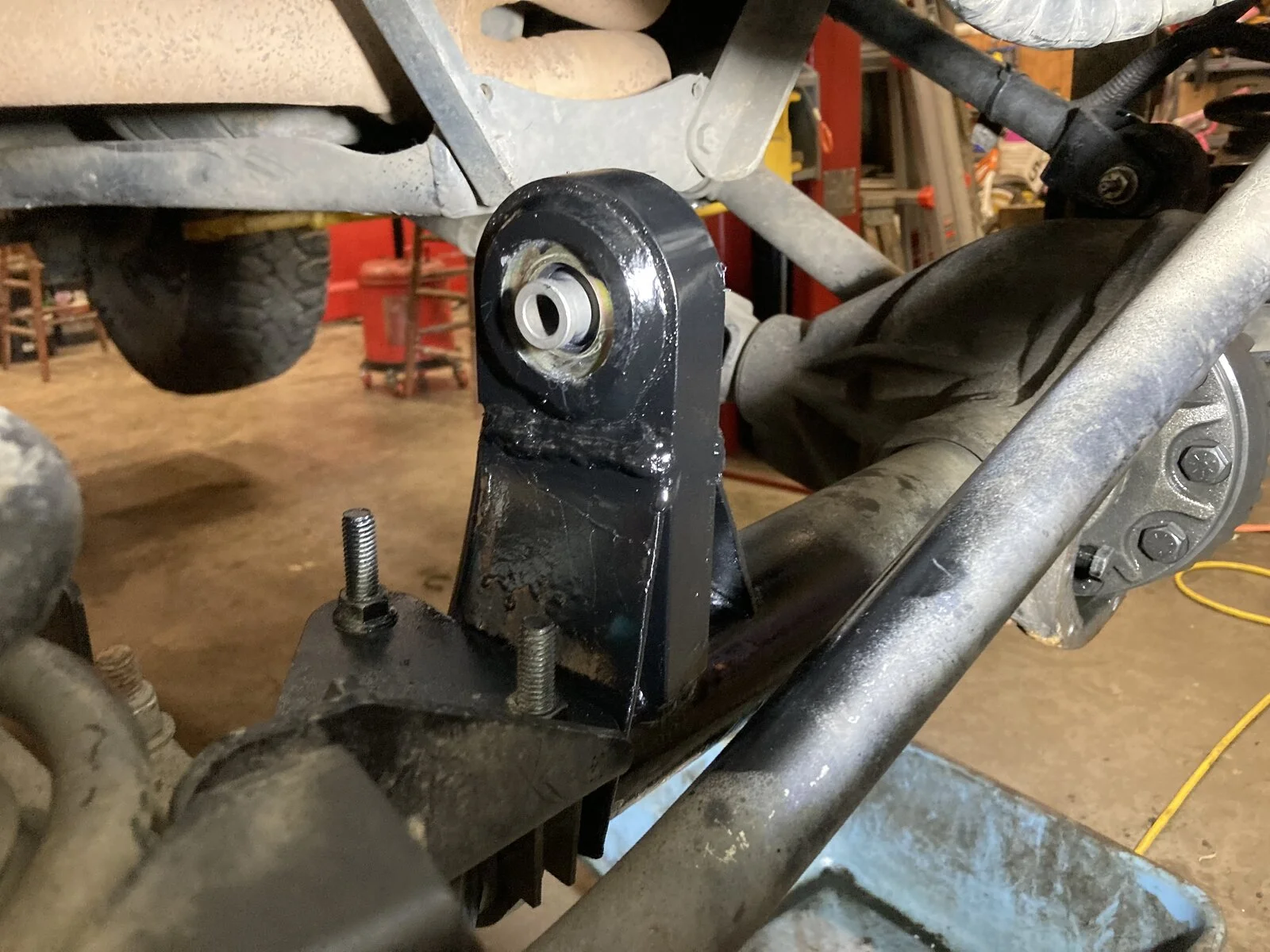

I'm not a fan of the bracket that comes in the CE-9102K kit. If I went with JJs, I'd want to do something similar to what Blaine did in the thread below. That said, I found the correct JJ that goes in the driver side, but need the correct one for the passenger side mount.
Driver side : https://savvyoffroad.com/product/ce-9112m/
https://wranglertjforum.com/threads...y-joint-bushing—will-it-fit.31051/post-500756
[URL]https://wranglertjforum.com/th...y-joint-bushing—will-it-fit.31051/post-500756[/URL]
I bought two of those CE-9112M Johnny joints thinking they would both just press in. What I didn't know is that the passenger side has to be welded in (like what Blaine did), as it is too small for the hole in the tower. Thus why I just pressed in the clevite Moog joint that I thankfully had on hand.

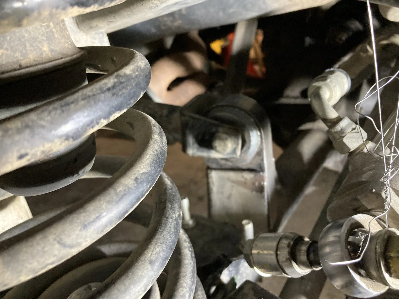

I have the Johnny joint ones. I don’t have a lot to say yet but the work. You don’t be disappointed if you go that route. What don’t you like about the pass side control arm mount?
The stock mount works and just needs a little reinforcement. Much like the front lower control arm mounts!

My mount was in rough shape so I used their supplied one. I didn’t do the install so I can’t provide any info there.

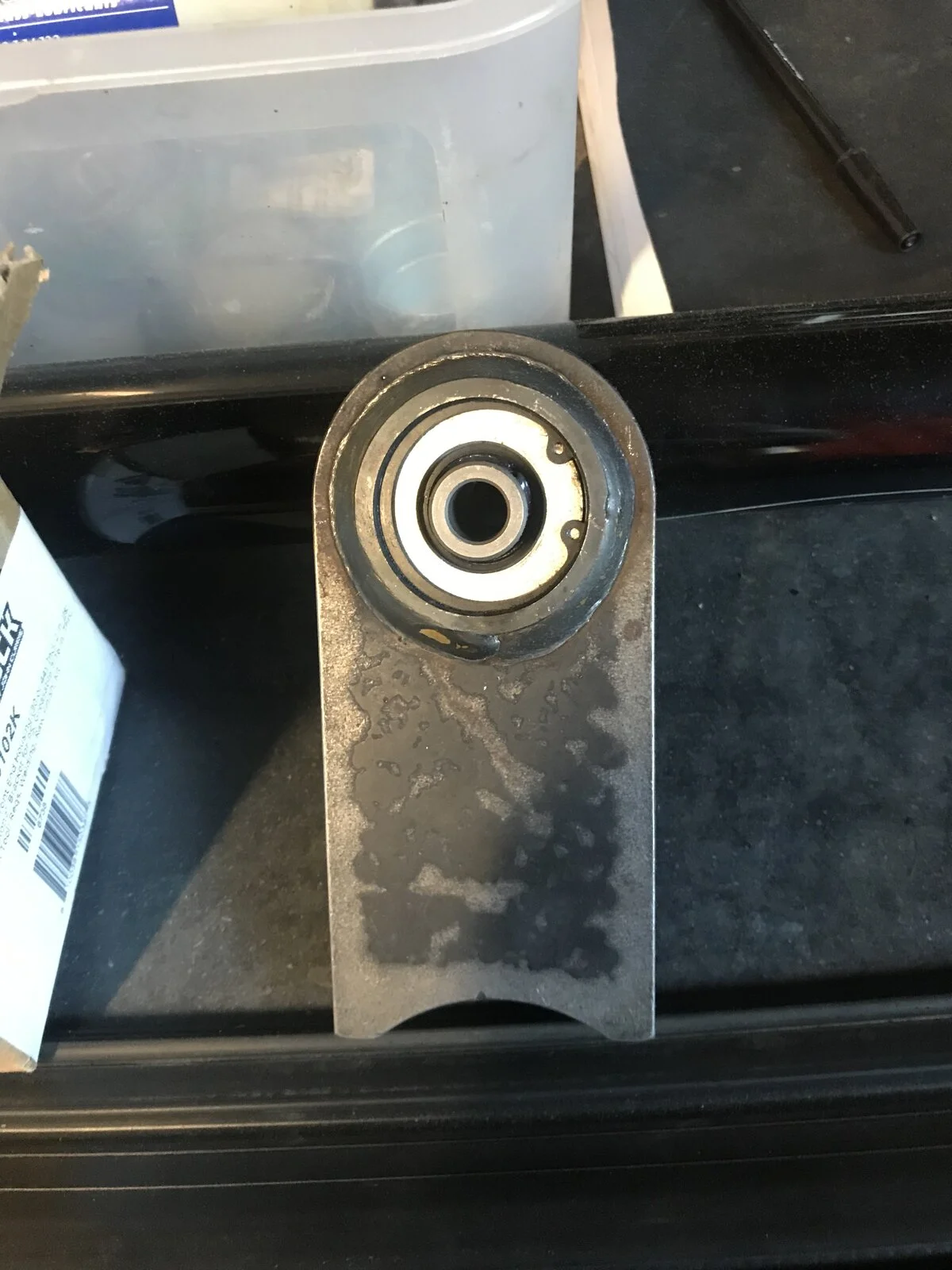

I went with the savvy kit and it was a good addition. I used the tombstone on the passenger side but wasn’t really concerned about looks. The way Blaine does it is much cleaner.
The driver side just pressed in, the passenger side bushing gets cut off and the tombstone gets welded to the remaining pieces of the original mount. You do need to trim and test fit it a few times to get it in the right position. The second photo is the bracket tacked in and weight on the wheels to make sure it’s positioned correctly.
It looks like you welded the mount to the old bracket and the axle. The installation directions say you don't have to to avoid warping the tube.
Or are those just tacks?
It’s one bead along the bottom of the bracket on the front. In the rear I drilled some holes and added plug welds, then welded the stock bracket to the new savvy bracket. I wasn’t worried about welding that part of the savvy bracket to the axle tube, it isn’t wide enough to warp the axle when welding it. However, if you install one yourself, do whatever you’re comfortable with.
