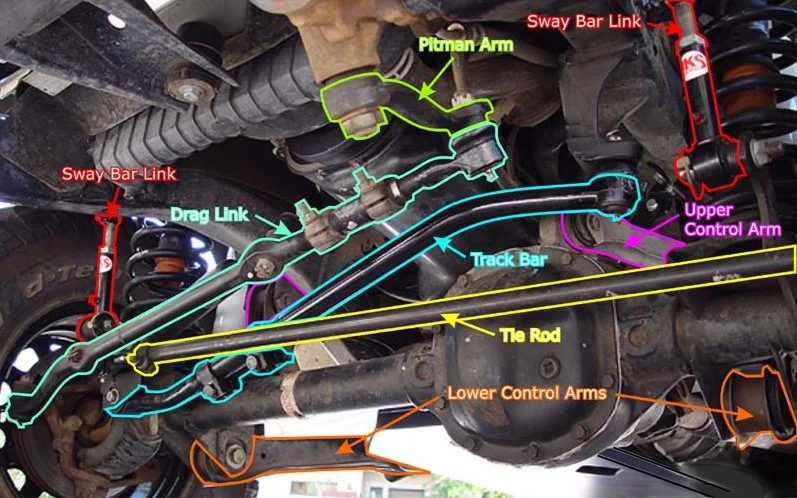

So, I am a first time jeep owner. I took my it to get an alignment after replacing tie rods, drag link, sway bar links, and shocks. The guy who handed me my keys after doing the alignment told me there's still some slop in the steering but he went on to say how that's just the nature of the short wheel-base? Is this true? or should I keep checking things out until I get this thing fixed?
I still have to turn the steering wheel about ten degrees to stay straight and there is a slight dead spot as well. It really just doesn't seem natural for the jeep. I am guessing it is the track bar or something but it is driving me crazy. I just want it fixed
By the way it's a 1997 2.5 with a 4" lift.
The wheelbase is the length from wheel to wheel , that's a measurement. That has nothing to do with the steering not working properly. Not sure how they managed to connect that.
was under there and it felt fine. Didn’t even think to check the bushings
You typically can't feel anything by hand on a track bar, that arm centers the axles and moves the weight of the entire frame and powertrain. It takes a dry test to reveal movement.
There are 6 bushings on the front shocks, 2 on the rear shocks, 12 on the sway bars , 16 on the control arms, 4 on the track bars...they all matter.
