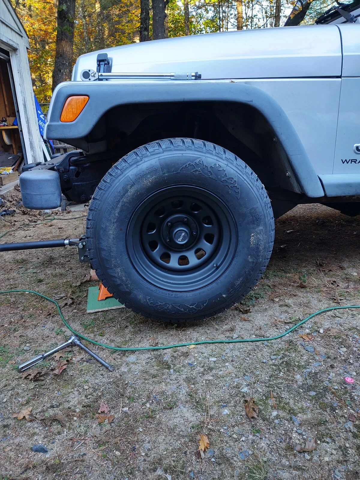

Hey all.
I’m brand new to the Wrangler community and just got my hands on a 2003 TJ with the 2.4L I4. Well taken care of and has just over 60,000 miles on it. It’s an auto, bone stock. I originally had the intent of doing a 4 inch lift, 33s, doing the SYE and driveshaft, adjustable track bar,etc., but I haven’t seen allot of talk about the 2.4 auto. Is it worth the bigger tires? I’m not doing any extreme wheeling and not a lot of highway driving. Mostly just in town stuff to work and the like. My biggest concern seems to be the power loss and I’m curious if I’d be able to get away with not regearing for a year or two, or if there’s a better combo of lift, wheels and tires that would suit the 2.4 better?

Since your goal is mostly "in town stuff to work and the like" and you liked it enough to buy it, I'd just put 31" tires and see how it feels power wise wherever you drive it. I have the 4.0 so that's a slightly different story than the 2.4 but my stock TJ has 235/85 R16 Duratrac tires (just under 32 x 9-3/4). With those thin tires I've never had any interference when turning sharp or off road. If/when you want to go higher, the 2.4 probably isn't what you'll want at that point.

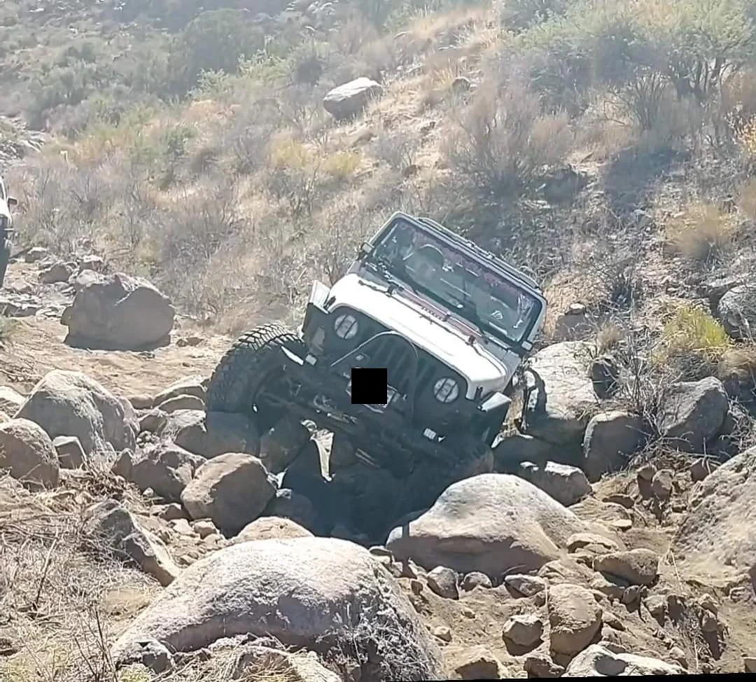

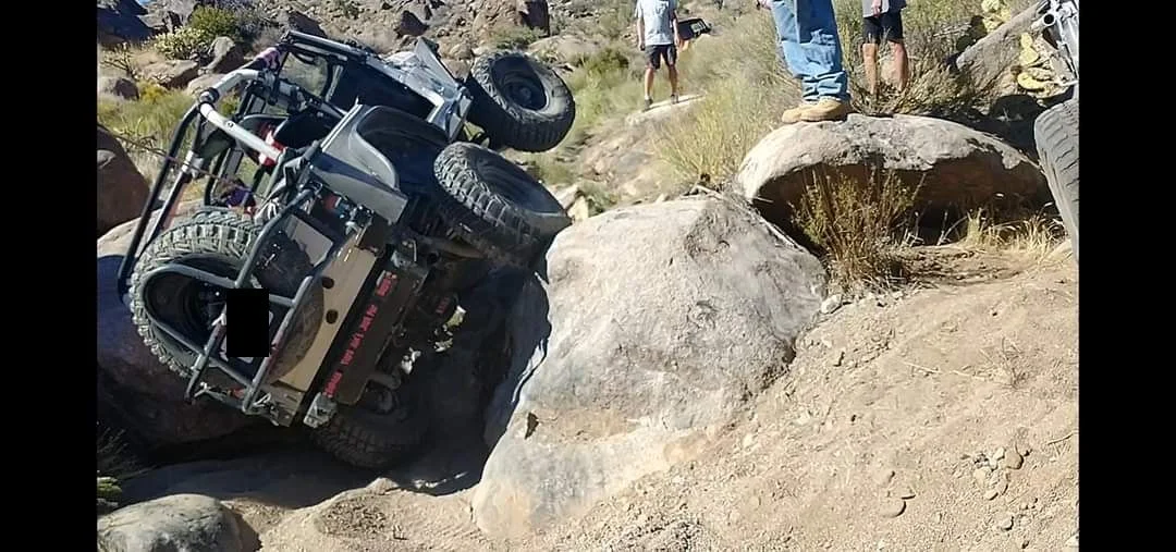

It's definitely worth it. Just ask the owner of this 2.4. You don't need go over 1MPH to do this stuff.
