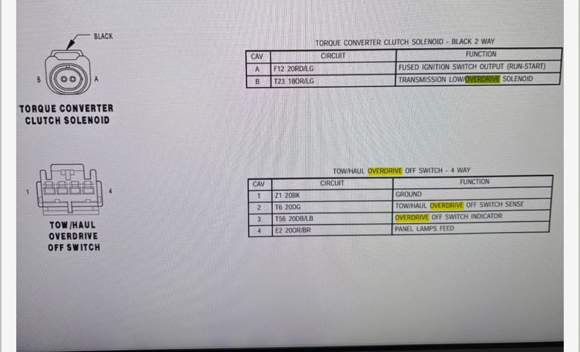

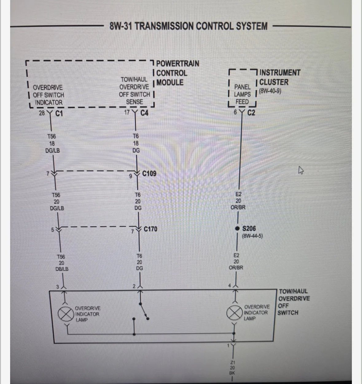

I was wondering why you used the light blue and orange wire , terminal 2-4
I took my switch apart to confirm
When depressed terminal 1 (ground) black is connected to terminal 2 (pcm sensing wire dark green )
Terminal 3 is the od indicator light dark blue, terminal 4 is the dash light orange
If I am reading this right you are connecting terminal 2&4 together via the relay when the vehicle is in reverse
Why wouldn’t you connect terminal 1& 2 ??
