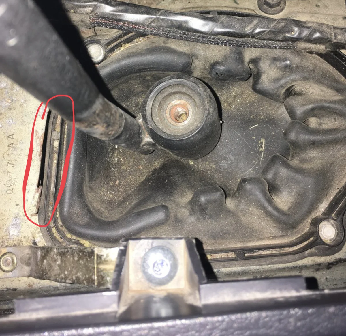

I’ve had this issue with the NSG-370 transmission. I lifted 2.5” and did a MML. At that time I was fine. Later I did a BL and that’s when my shifter started contacting the console and my lower shifter boot tore and heat started rushing into the cab. There is nothing wrong with removing the shifter and bending it with a brake. My solution was more complicated and difficult, but I didn’t have access to a brake. Ultimately my solution will be a tummy tuck.Wouldn’t a motor mount lift increase the angle and tilt the transmission back even further, exacerbating the shifter location issue?
Are there any long term issues with removing the shifter and bending it with a brake?
Bending the shifter is just treating a symptom, I doubt that a boot will allow that much movement without tearing eventually. The previous owner even cut part of the tranny tunnel to clear the increased throw from the drop, when you fix the problem you might want to seal the front of the lower boot. The proper way to fix it would be install upper adjustable control arms possibly a slip yoke eliminator and a double cardan driveshaft. The motor mount lift is just a simpler solution To get the proper driveline angle and get rid of the drop.

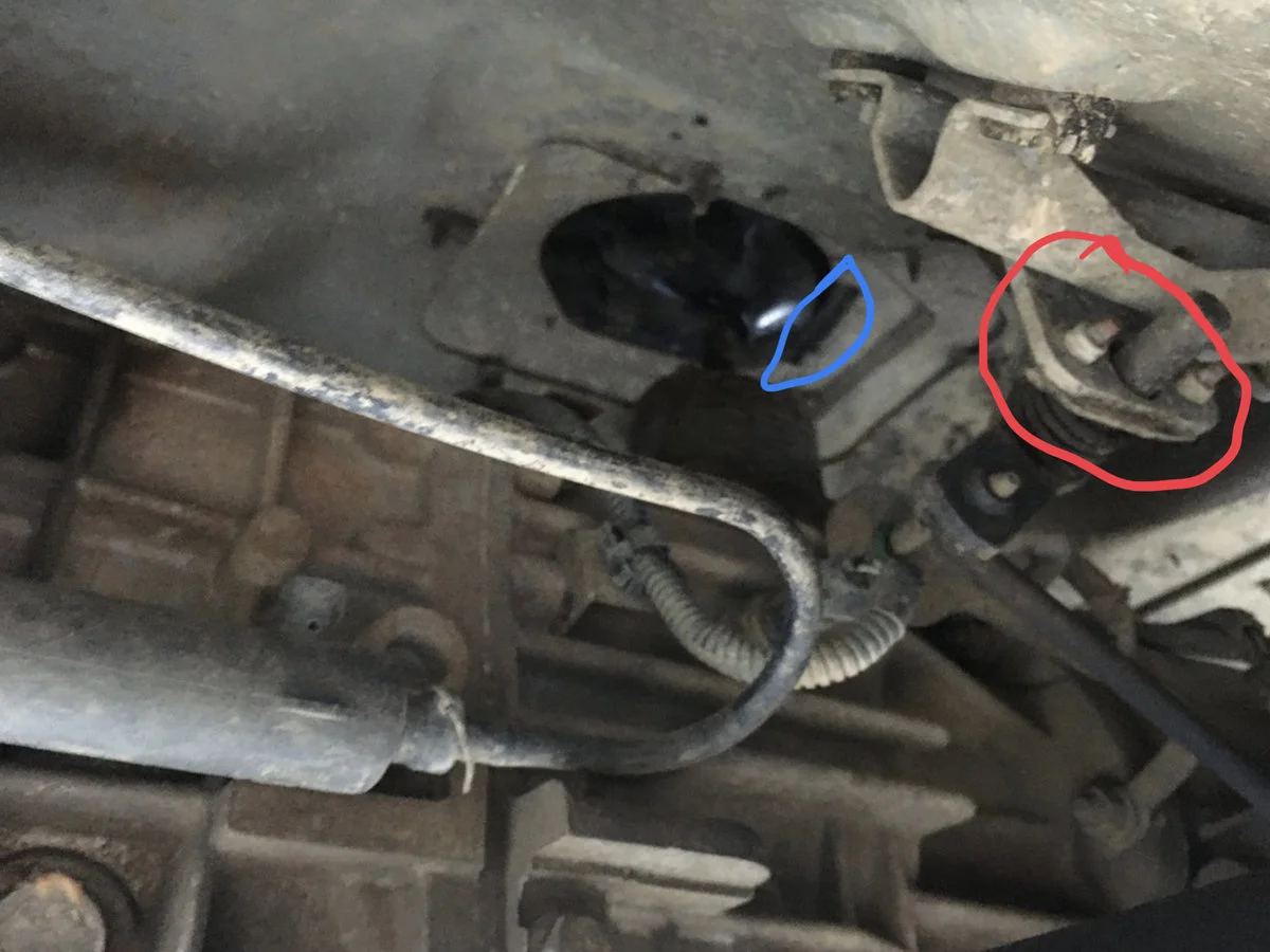

i see a TC shifter relocation bracket on there too. so the BL is also compounding this.

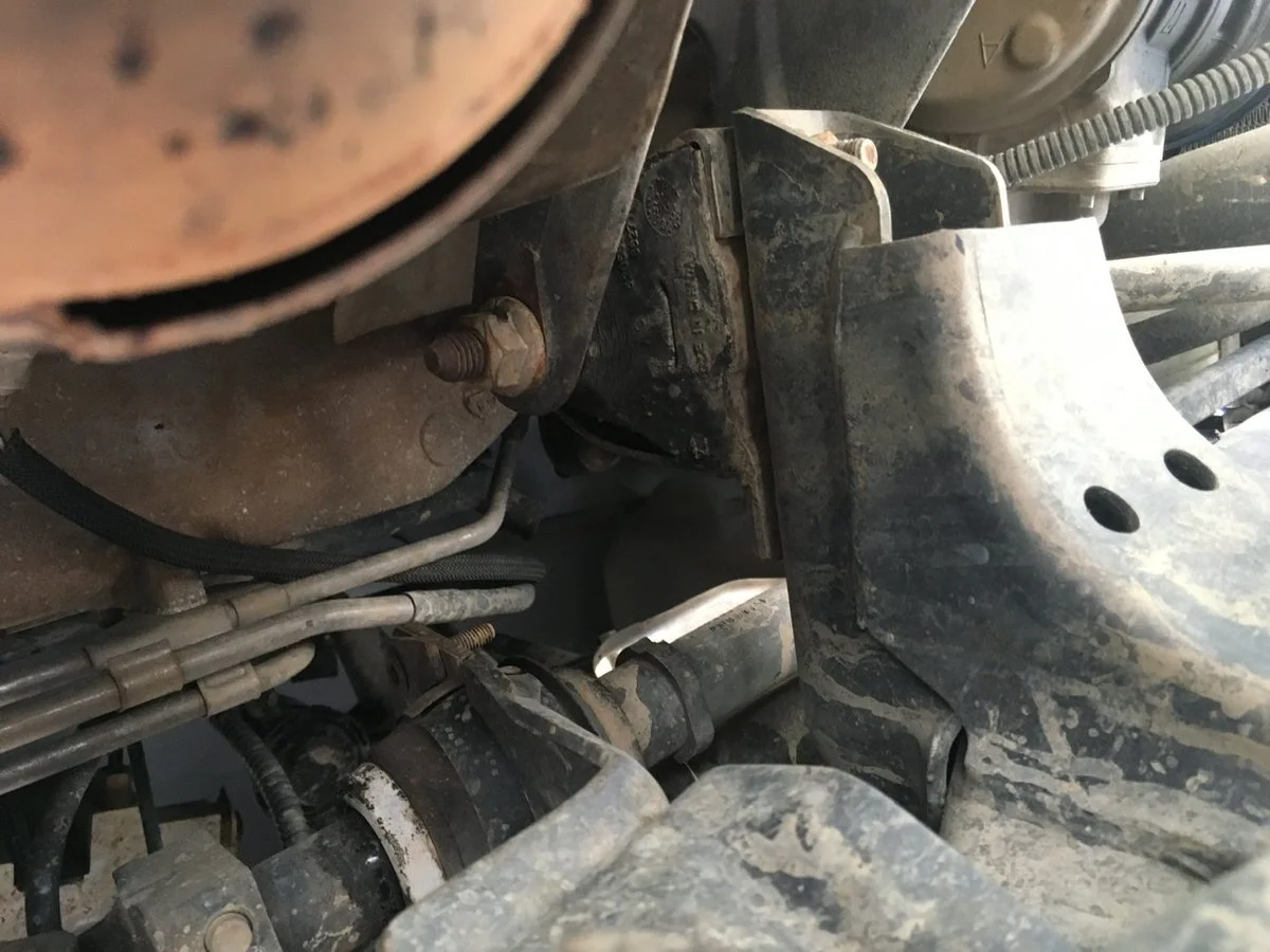

confirming whether or not it has an MML is next, like mentioned.

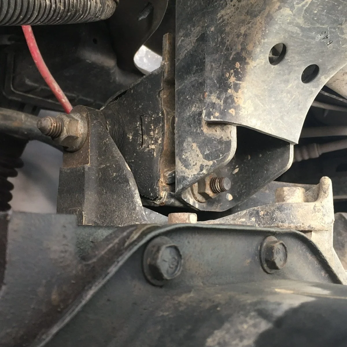

You do not have a body lift or there would be a spacer here.are you saying I already have a body lift?
I’ll take some pictures of the motor mounts to see if a prior owner already accomplished this as well
You don’t have or need a body lift but you do have an 1-1/2” TC drop that needs to go, a body lift would make it worse. As @someguysjeep pointed out there is a relocation bracket that would also need to be removed. Shifter relocation bracket in red, the cut in the tub to clear the shifter is circled in blue.

You know, just a couple minutes with a tin snip and then you will be able to shift fine. Total cost $0. If your goal was just to fix the shifting issue then this would seem the way to go. Otherwise you are spending a whole lot to fix a very minor problem.
