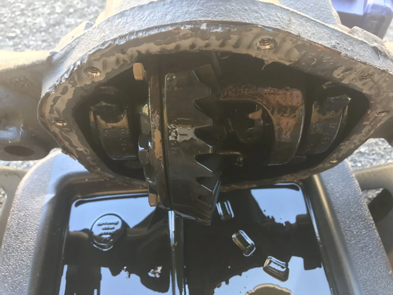

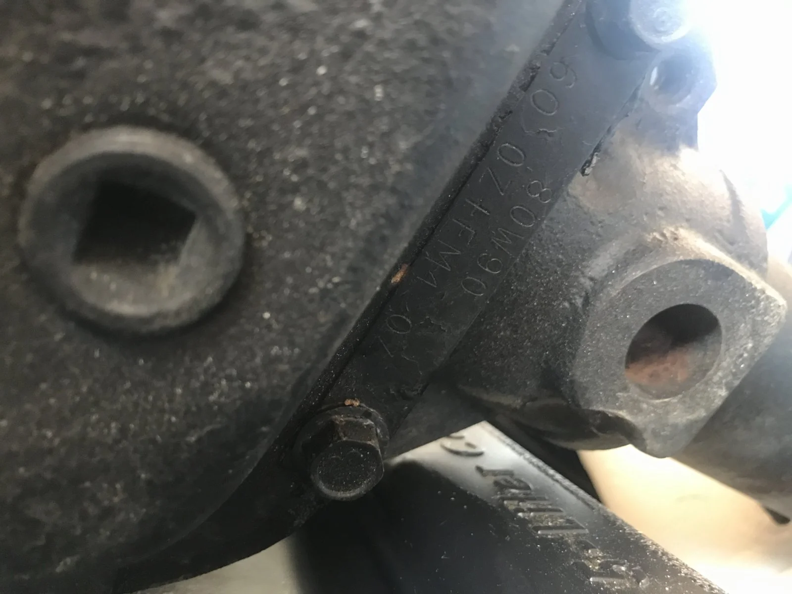

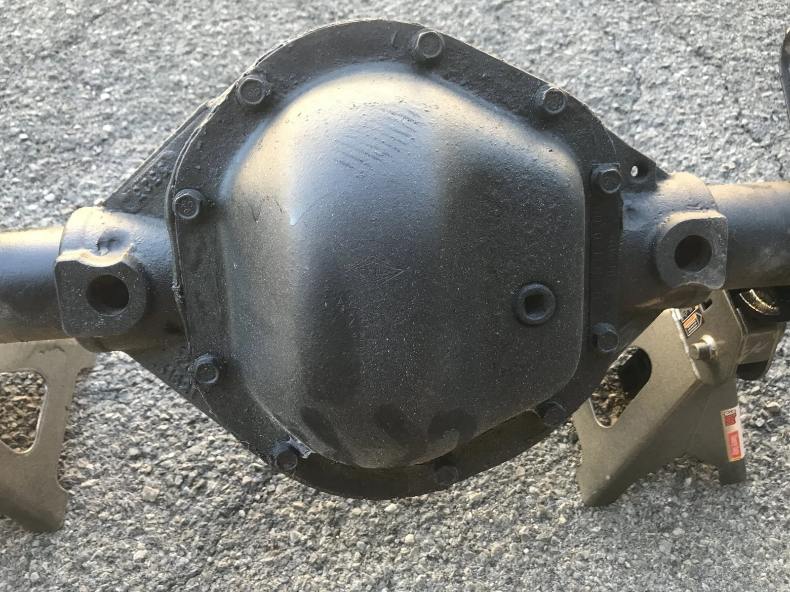

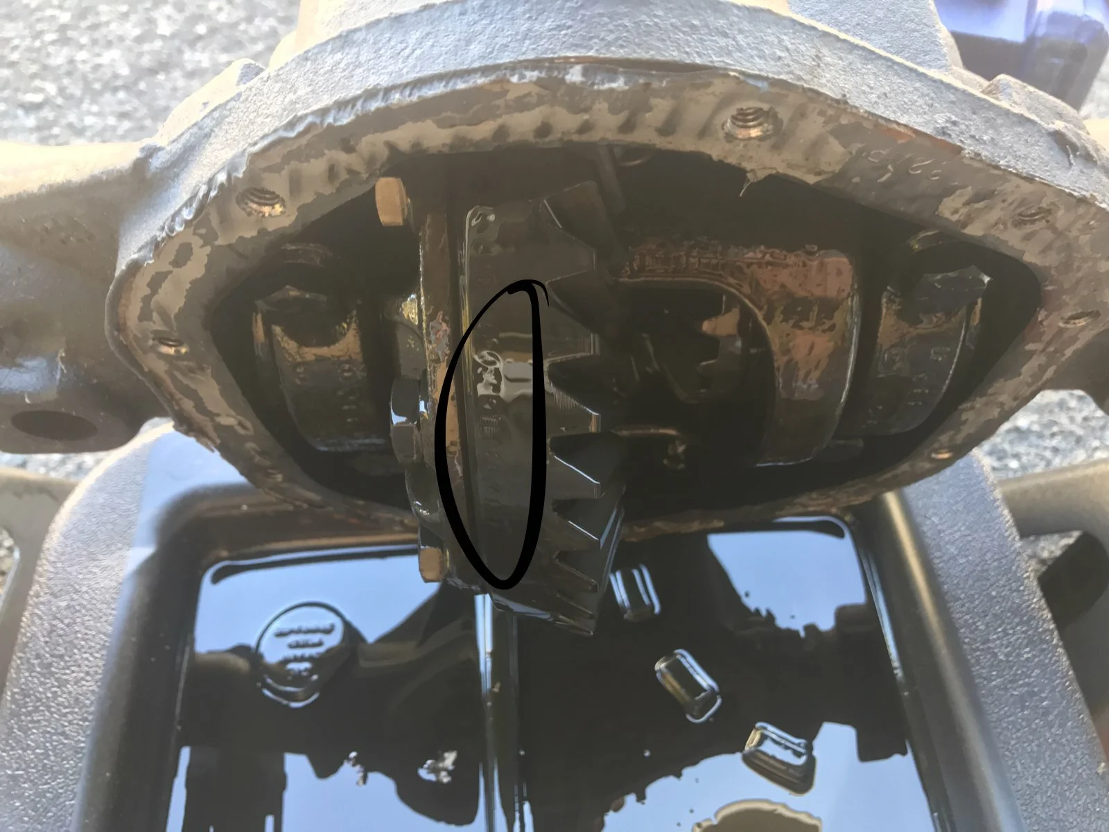

Sourced my rear axle today! A mint dana 44 TJ axle with 40k miles on it. Everything turned beautifully, looked good, and checked out. The gears are in great shape, just need to take time to figure out the gear ratio (I thought it was written on the tag). Going to try to install the axle asap and then regear/lockers after. More to come!

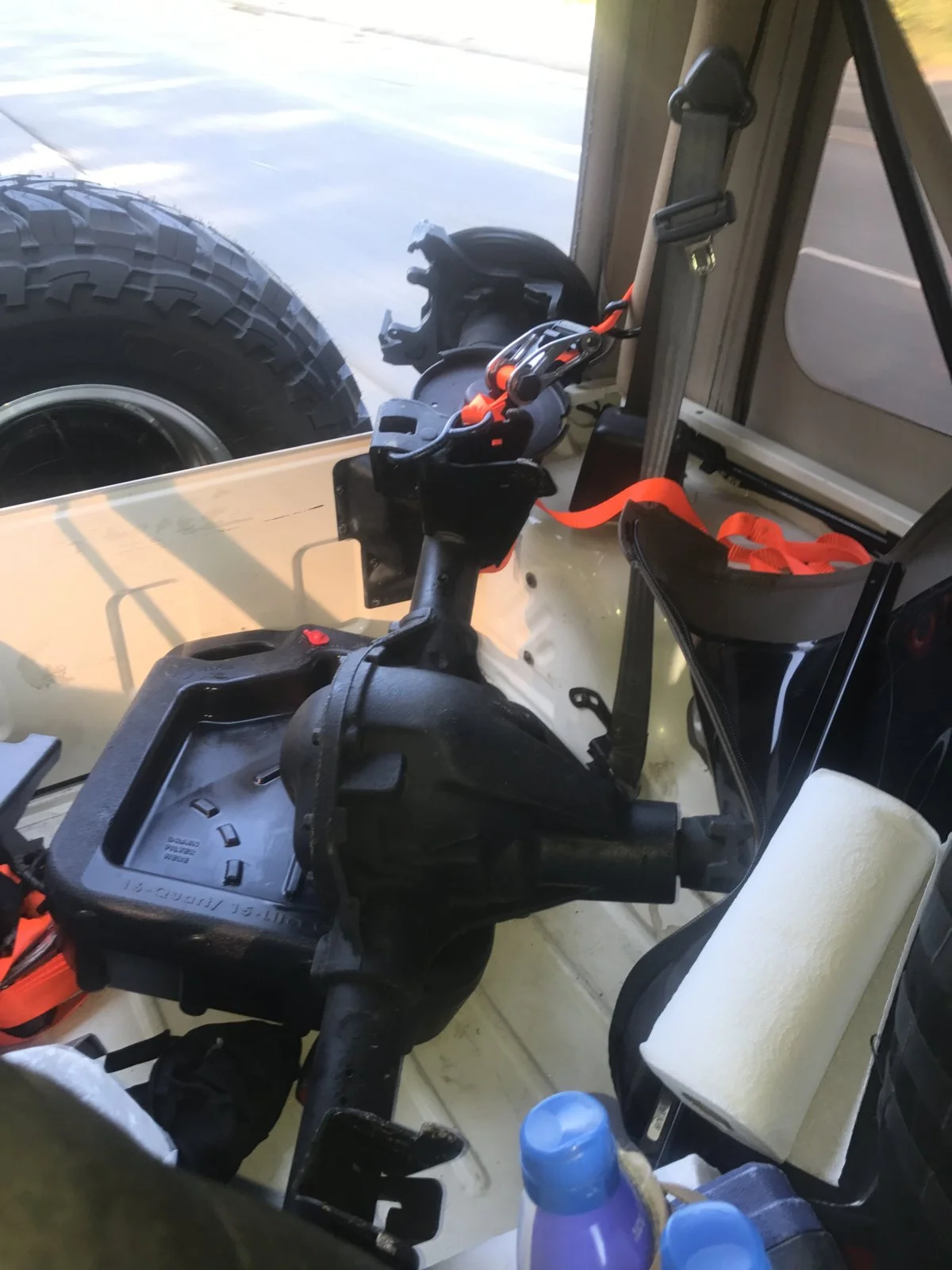

Also, yes I did pick it up in my TJ. Fit just fine without the rear seat in ;).
Take some brake cleaner and really spray the differential out. On the ring gear should be some numbers stamped into it (the smooth part). Those numbers should indiacte ring gear teeth and pinion teeth or simply the ratio of the two. Example: "4.10"

bet that was a fun drive home, lol! Nice score!
It was! Taking it to class with me tomorrow! ;)

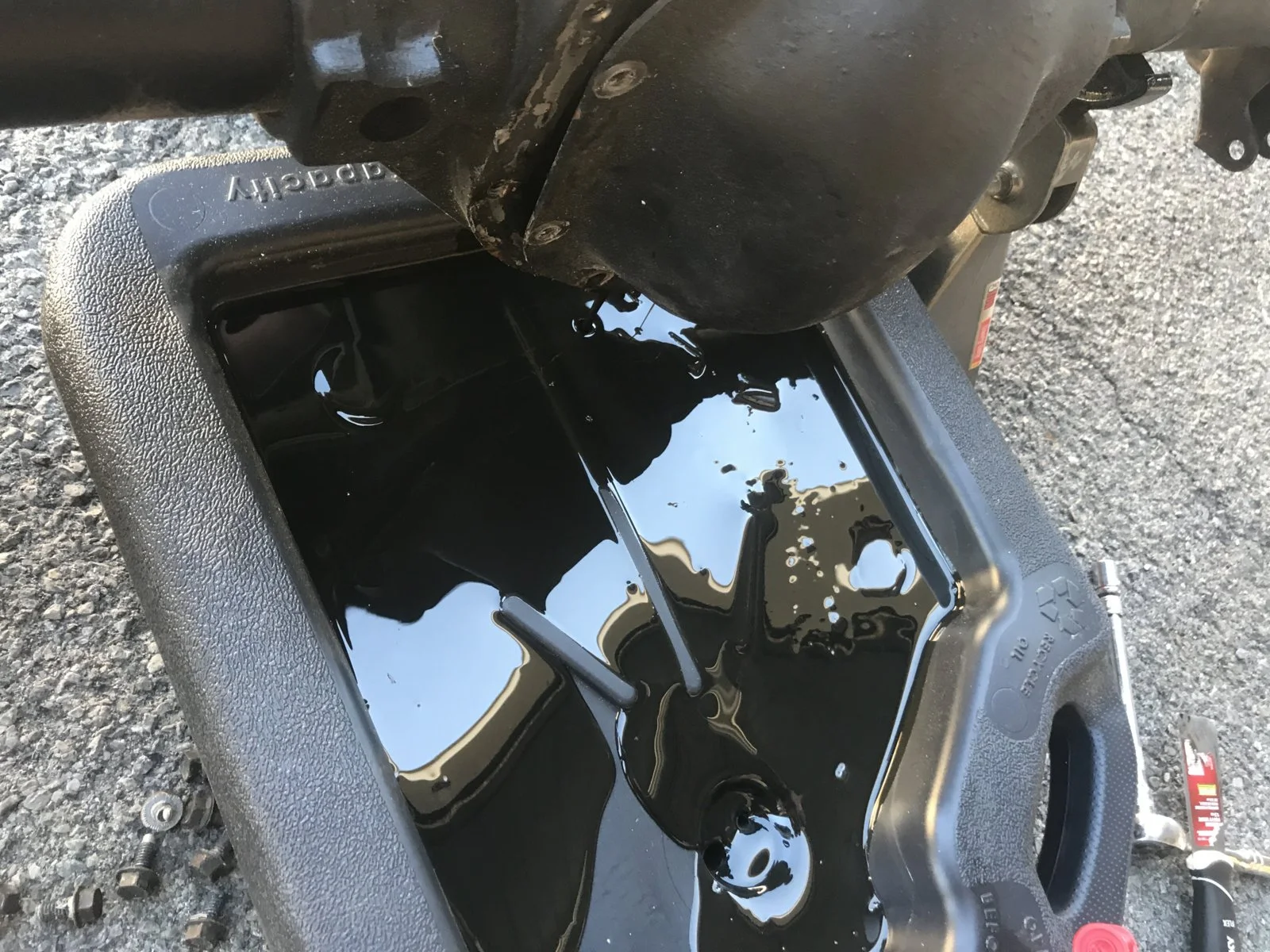

Okay- serious question. I have been considering cleaning my diffs and replacing the fluid myself, but I read it is the most horrific smell imaginable. I see you now have some experience with this- what do you think?
I have never heard it and didn't smell anything doing this. I guess I'm noseblind to this kind of stuff... I wouldn't say its too bad but I'm about to reload the Dana 44 possibly tomorrow so I'll get a good whiff and let ya know. Researching stuff I don't know like can I swap brake lines over without bleeding fluids ect. :)
Diff fluid definitely can have a strong smell. Best way I can think to describe it is, bitter smelling. But it isn't so bad that I had to stop working.
