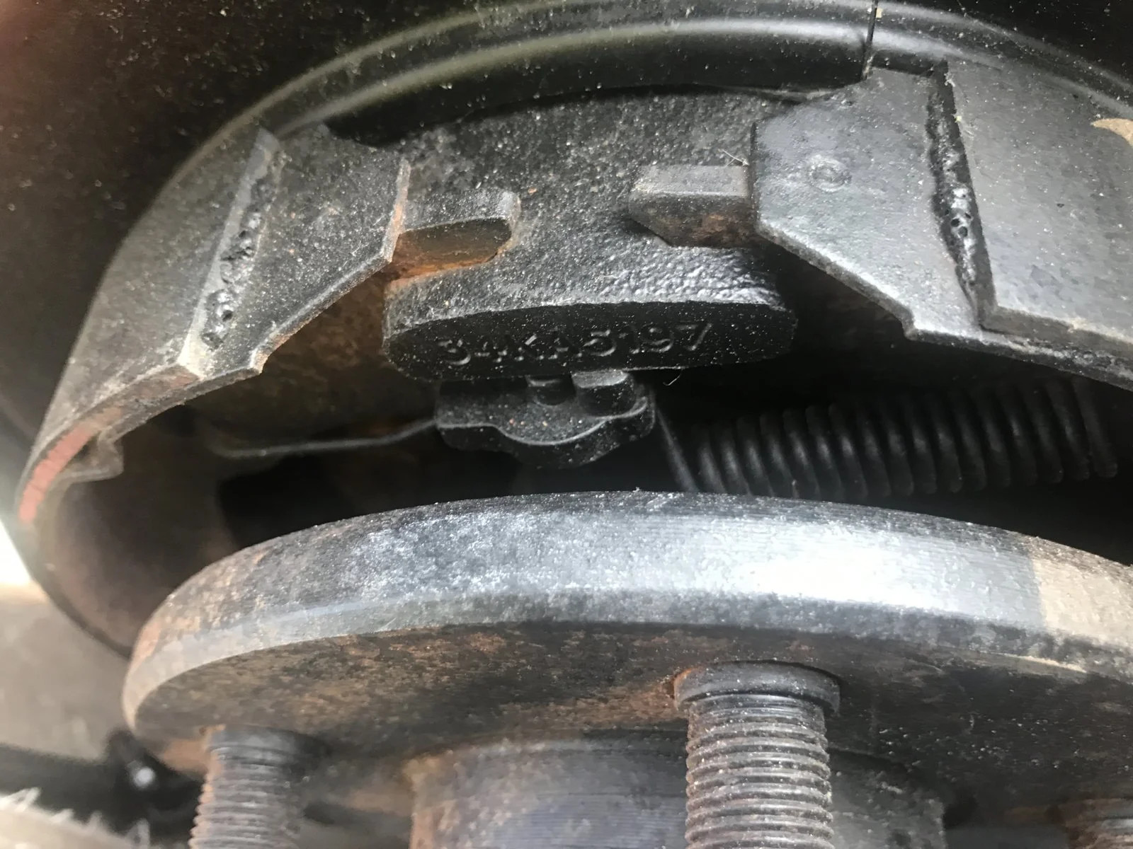

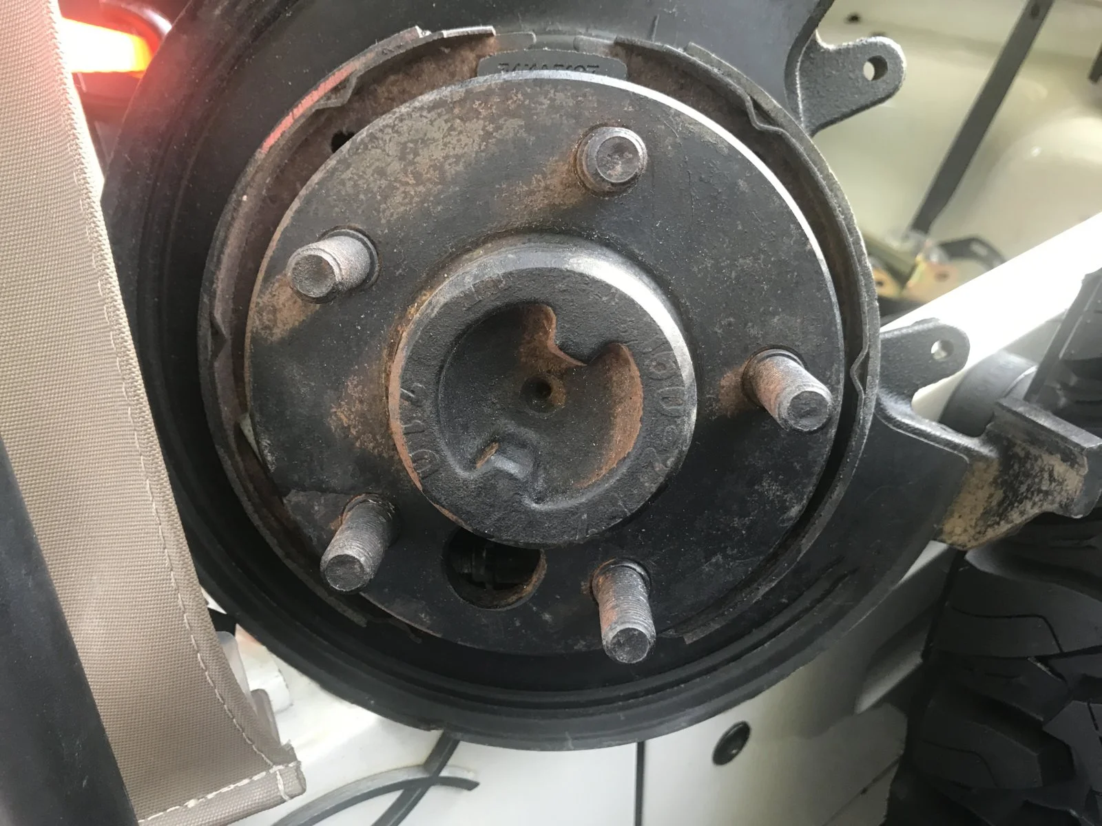

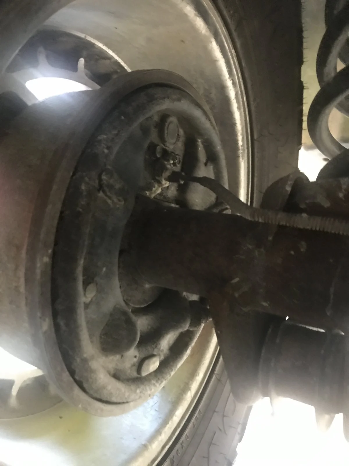

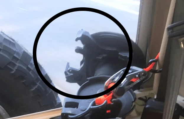

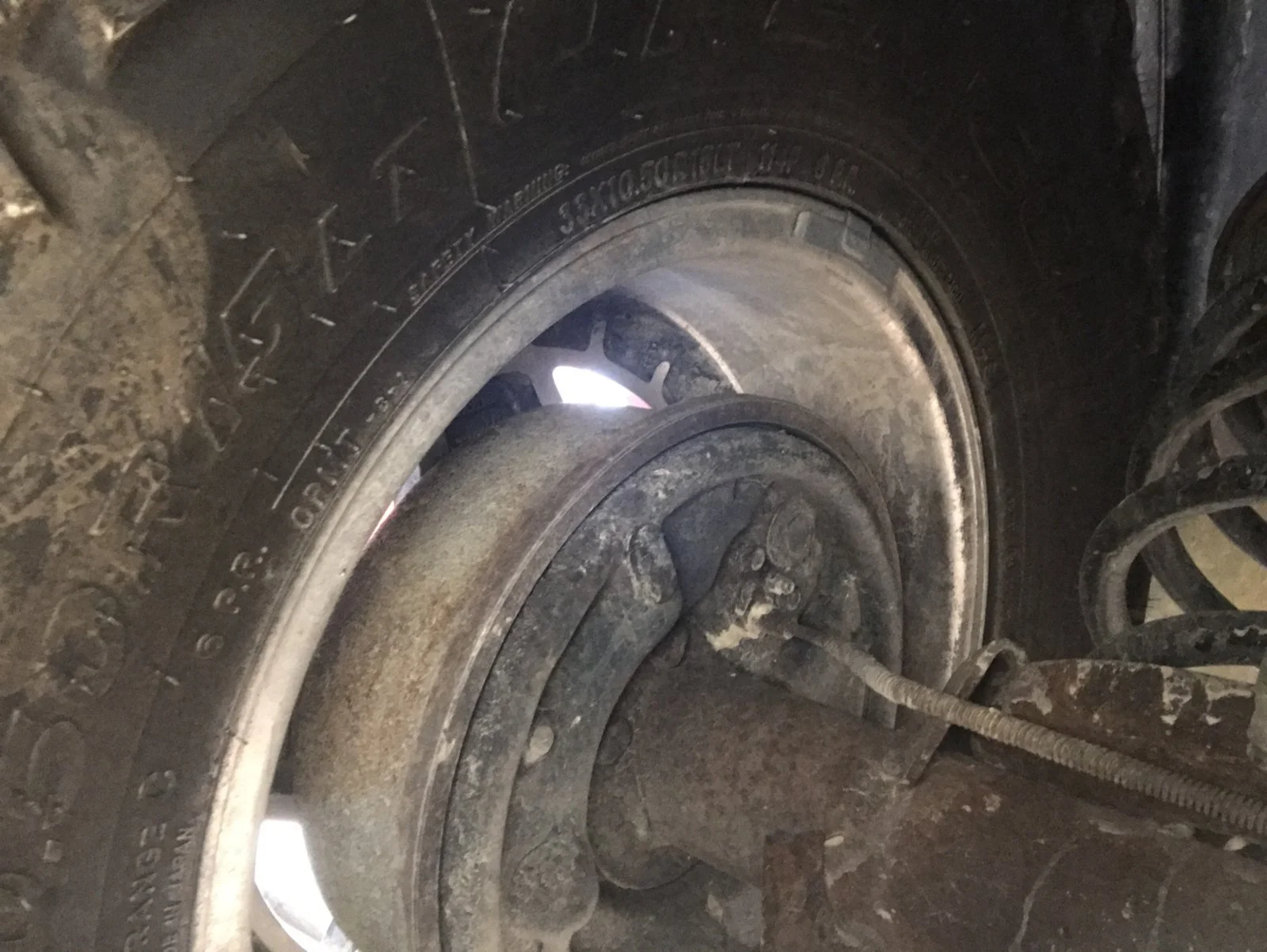

Boy, I'd have never guessed that axle had drums. Those ears sure look like caliper mounting brackets.
Yeah, those shoes are the parking brake shoes. You are all set for disc brakes! buy some calipers and discs. IIRC, aftermarket calipers are about 35 each, and discs were about 40 each. Parking brake shoes are in that ball park to.
Stu-Offroad has a nice write-up on the switch. You might have to buy some lines, a parking brake cable, and do something to the proportioning valve but the hard part is done. In order to switch to drums, you'll have to pull your axles to get the backing plates on.
Stu-Offroad has a nice write-up on the switch. You might have to buy some lines and do something to the proportioning valve.

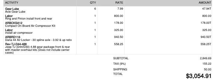

Contacted offroad connection today, for just the master install kit/gears/carriers/bearings/seals is a total of $2005.00 (Just got the quote for the regear no locker). This is using Yukon parts.
Shops like Motobilt and UCF regear for $1600.00 including carrier replacement but bearings/seals are additional if they need to be serviced. Funds are getting low so trying to get the locker priced out sucks because I only have cash for the re-gear. If you just do gears its $1400.00 if you have proper carriers.
If all bearings and seals were replaced, $1800-$2000 is an accurate quote for just gears and carriers with all bearings/seals replaced.

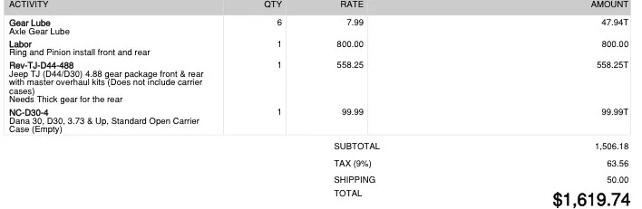

Here are the exact quotes from motobilt, everyone else contacted gave verbal quotes:
