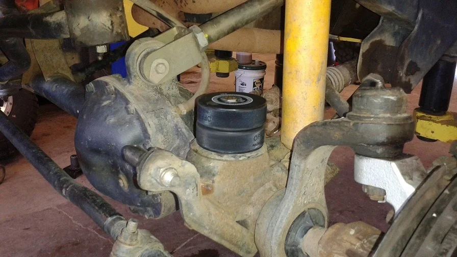

Forgive me if this is the definition of a "Should know" kinda question but I need to order front and rear bump stops as well so I don't destroy my Sahara flares right? I have the Currie Front and Rear Bump Stops on my Excel spreadsheet right now and 99% sure I need them.
You will definitely need them if you go to 33's. I used hockey pucks for mine and drilled/tapped out the lower perch pads to bolt them on. Technically, I have 2 3/4" of lift since I added some coil spacers for a little more clearance, but with that lift, you'll need 2" of added bumpstop in the front, and 1.5" in the rear. Since yours is a Sahara, you may have the wider Rubi flares, so that will help some with clearance.

I used daystar bump stops. They are pretty long but you can trim them down to the ideal height you want. Only $20 a pair too. I haven't had one issue with them coming out either.

Co-worker of mine recently installed a Cloak lift on his Rubi. I saw the bump stop kits that MC provided and they are just hockey pucks that MC pre drilled and added different length bolts. You still have to drill and tap threads in the lower spring perch pads. Save yourself some dough and just grab some hockey pucks from Kmart/Walmart/Target whatever and some bolts from the hardware store.

You just saved me hahaha. Thank you for clarifying, sadly down here in Alabama I will need to order the hockey pucks online from amazon. Was there a specific thread tap I should use?

5/16 USS thread worked fine for me. You'll need a 5/16" tap, a 17/64" drill bit, and a drill bit slightly larger than 5/16" to drill holes in the hockey pucks. You shouldn't need more than 2 pucks per spring, so 8 in total, probably only one puck per side for the rear. All depends on what tire size you'll be going with.

Thank you for clarifying. Tire size 33x10.5x15. Was planning on getting hockey pucks for the rear tire carrier anyways to snub the 33s.

The bump stops will be pretty straight forward. When you install the lift you'll be removing the shocks and the coils. Install one of your new wheel/tires, put the front axle to full bump, find out at what point your tires hit, and bump to fix. I can go into more detail if you need it.
Thank you Bob, hopefully what you have provided me and what Chris has in the FAQ will be something I can handle. Its hard to visualize it never doing it before.

It will make more sense once you get under there and get busy. I can post a few pics tomorrow to possibly clarify things a bit, but I think you got this.
