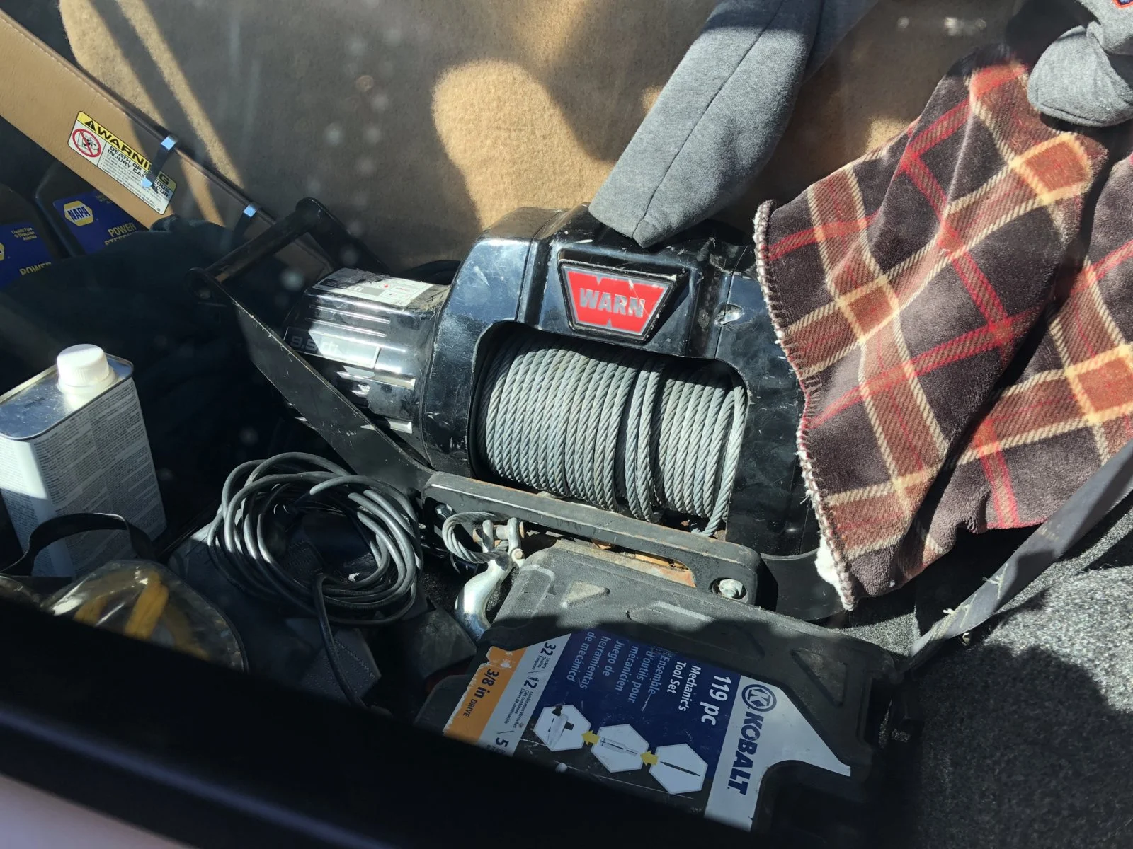

Did another thing today! It checked out fine, free spooled easily, and pulled/released cable on command. Really nice unit & gonna look great on my Jeep! If only the iron bowl wasn’t tomorrow I’d be mounting her up then!
