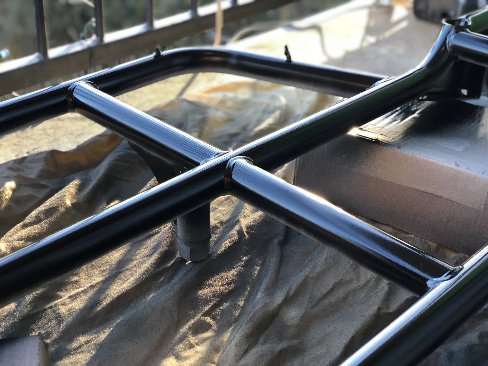

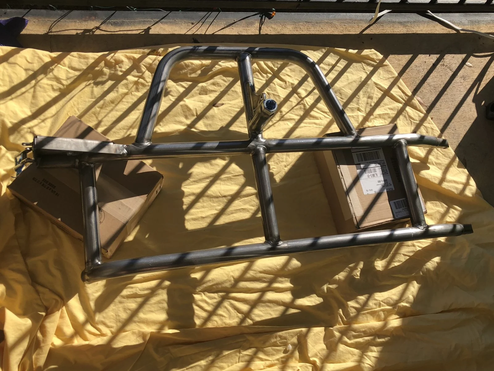

Sanded & cleaned:
Prepping the college level paint booth:
All pieces primed:
Second coat of paint:
Final coat of paint, very impressed with the quality of this spray paint:
As you can see I have to do one side at a time, so the back primered side will be taken out tomorrow.
