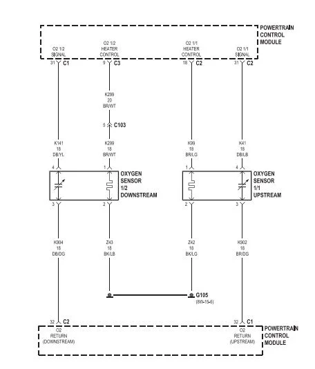

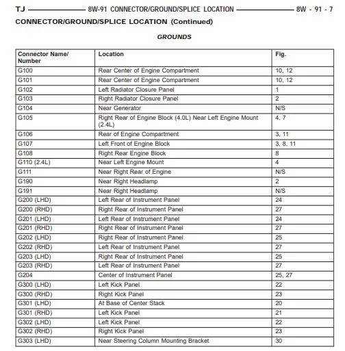

Ok where is the G105 ground located?
Thanks

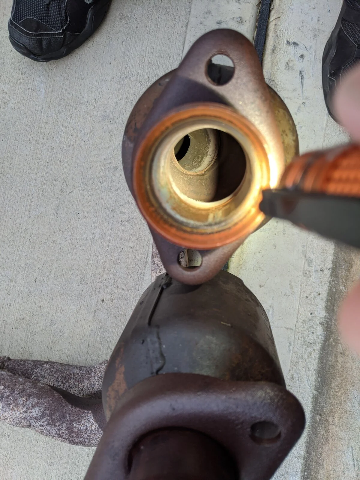

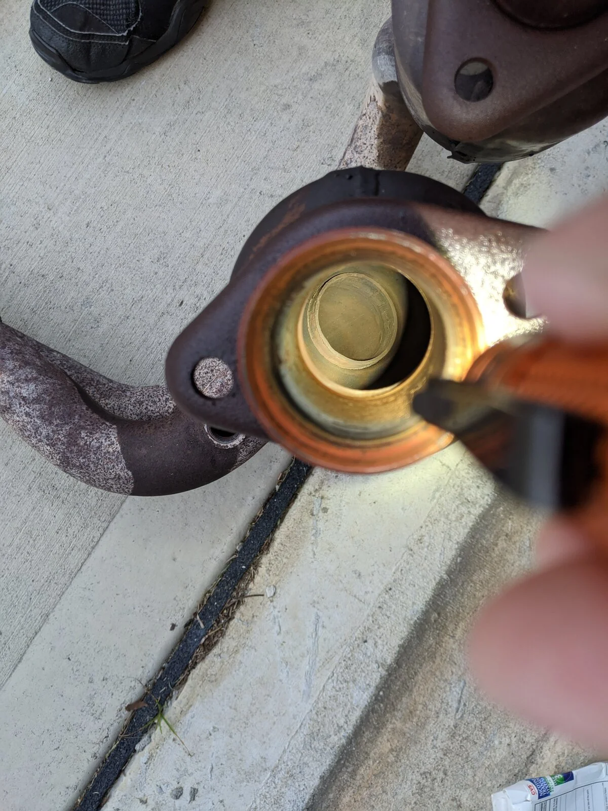

I figured out why I'm getting a catalytic converter CEL!
View attachment 195317View attachment 195318
That would do it. I just finished replacing g the CAT’s last night. I recommend going Magnaflow (the $372) option if you can’t get those, then Bosal from rock auto. Is a re-branded Magna down to the warranty card in the box
whatever you do don’t get Eastern Catalytic. You can look at my build thread for the headache I had there.
