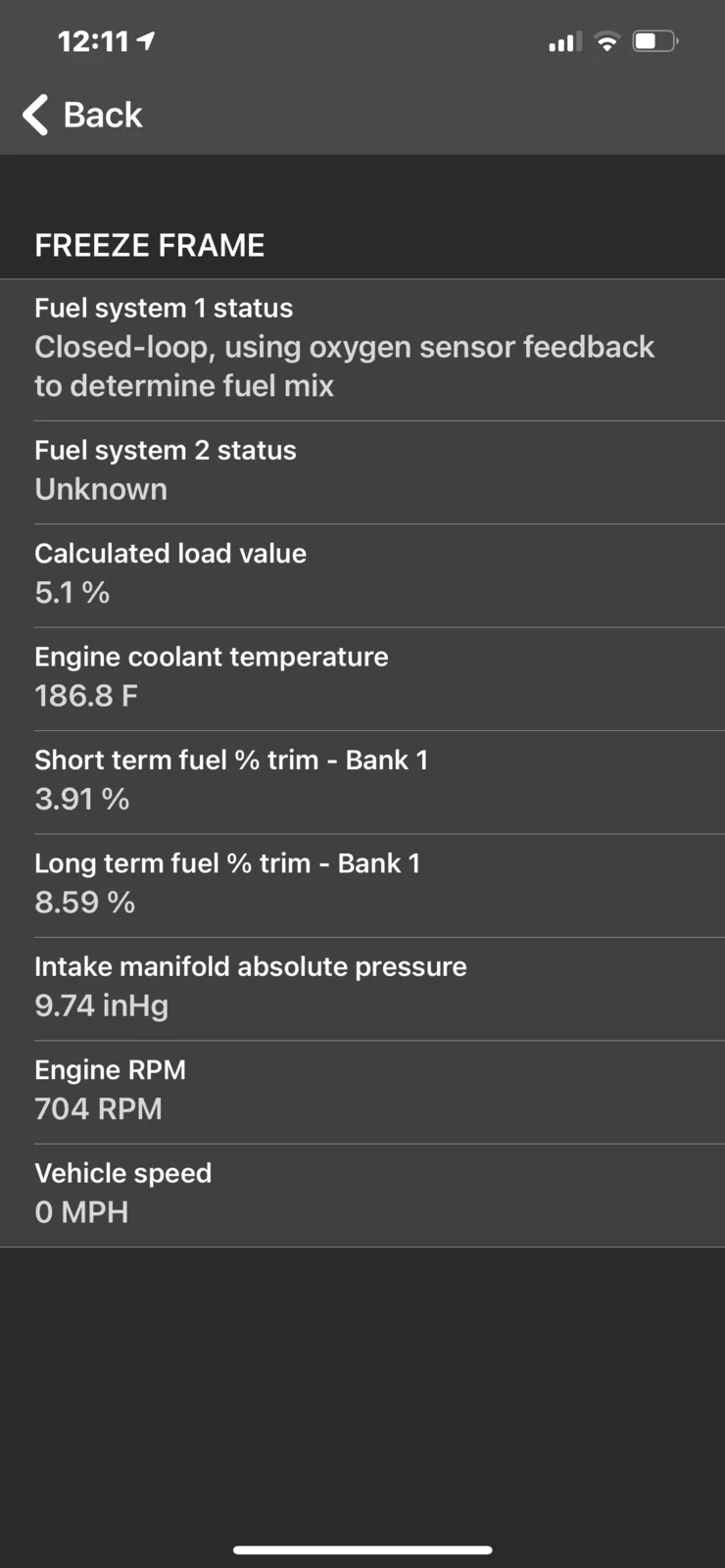

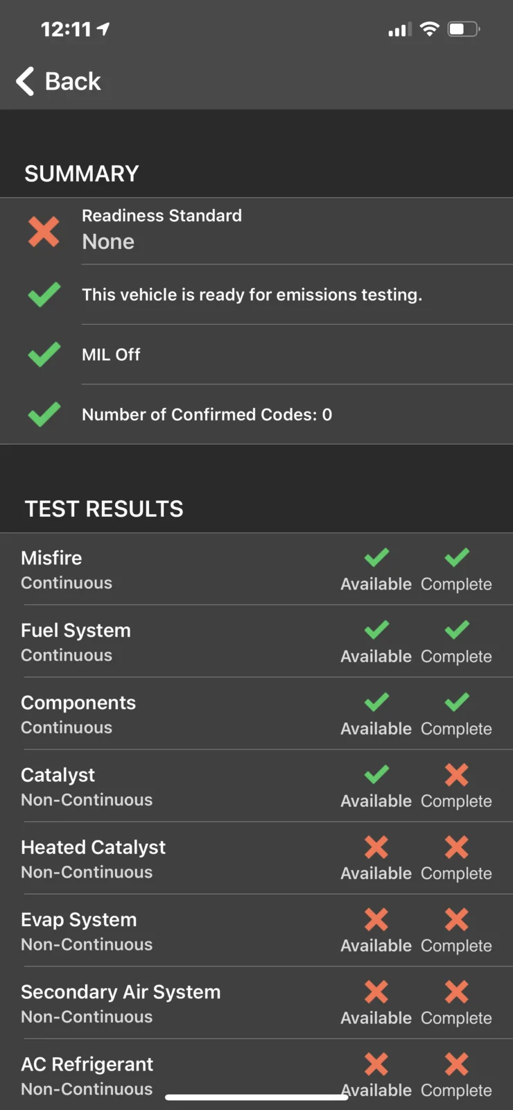

I’ve received a P0133 code on a ‘97 with the 4.0L so I searched to see what it was and how to fix it. I found it could be the sensor or maybe a cat going bad. I also read that it could be a dirty air filter. The air filter was pretty dirty so I took care of that. Put a clean air filter on it and reset the code. A week later I got the code again. Before I bought two new sensors I would check the cat to see if it had physical signs of problems. The problem I saw was that it has no cat. I can see the PO replaced the muffler and put in some pipe to fill the gap where the cat was at. Now I’m wondering if it still is the sensor or the missing cat causing the code. Once the code was once cleared again I ran a test in the system and I think it looks ok. What do you think?
