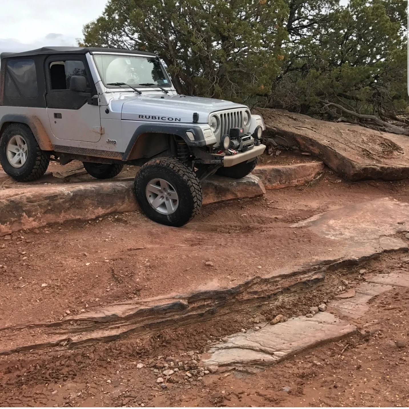

Pictures of the Heep attached.

Thats a good looking TJ. How do you like the ST MAXX? When I went to my 255/85s the choice was ST Maxx or KM2. I went the KM2 route. But I like the slightly wider look of the ST Maxx better.
Awesome shot at TOTW. I'd agree with Fargo, just add the OME 10mm spacer, or a 3/4" poly spacer if you want a little more rake. Don't fear the spacer.

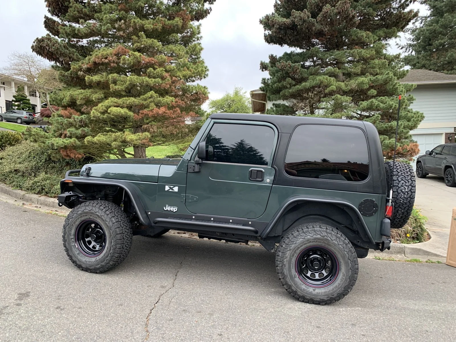

Ok, so I just Got my 2” JKS lift kit installed today. Coils, shocks, quick disconnects, extended brake line brackets, front and rear adjustable track bars( rear was not included in the kit) and rear bump stops. Also added a teraflex steering shock.
Only drove about 20 miles so far but the difference from my stock coils with the front bilstein shocks and rear pro comp shocks is huge. Waaayy smoother over bumps, yet firm. Responsive suspension that feels tight. No issues on the install. Came with all the hardware labeled and easy to follow up. I love the height with my 32’s. All parts are quality, beefy parts. Will report back after more testing but so far I am beyond excited. Night and day difference.
Thanks for the review and the pictures of the coils. It looks like there is still plenty of soft coil left before you get into the heavy rate. Can you measure your coil. How much lift did you get?
Hey Fargo,
Did not measure the lift yet but I will do it in the next couple of days. It definitely looks like more than 2” and that’s because of the flat fender flares too. I have some good bumps on my way home and did not feel any bottom ups. It feels smooth and tight compared to my stock coils and old shocks

I was really looking forward to these photos, but without stock flares, they don't help in my case. The flat flares have so much more room it's hard to see what it would look like without those.
Thanks for posting, though.
