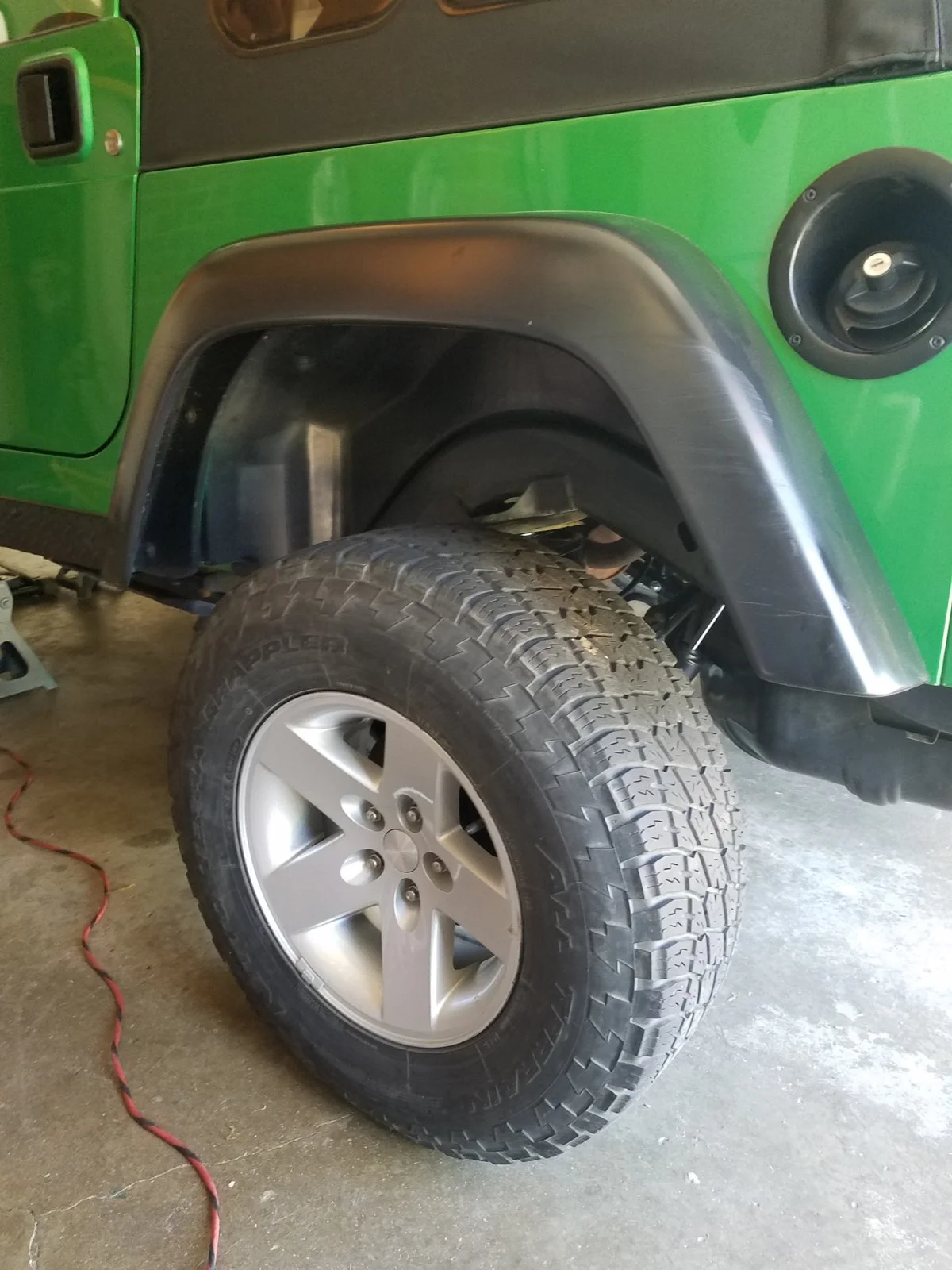

I was really looking forward to these photos, but without stock flares, they don't help in my case. The flat flares have so much more room it's hard to see what it would look like without those.
Thanks for posting, though.
Sorry glwood:)

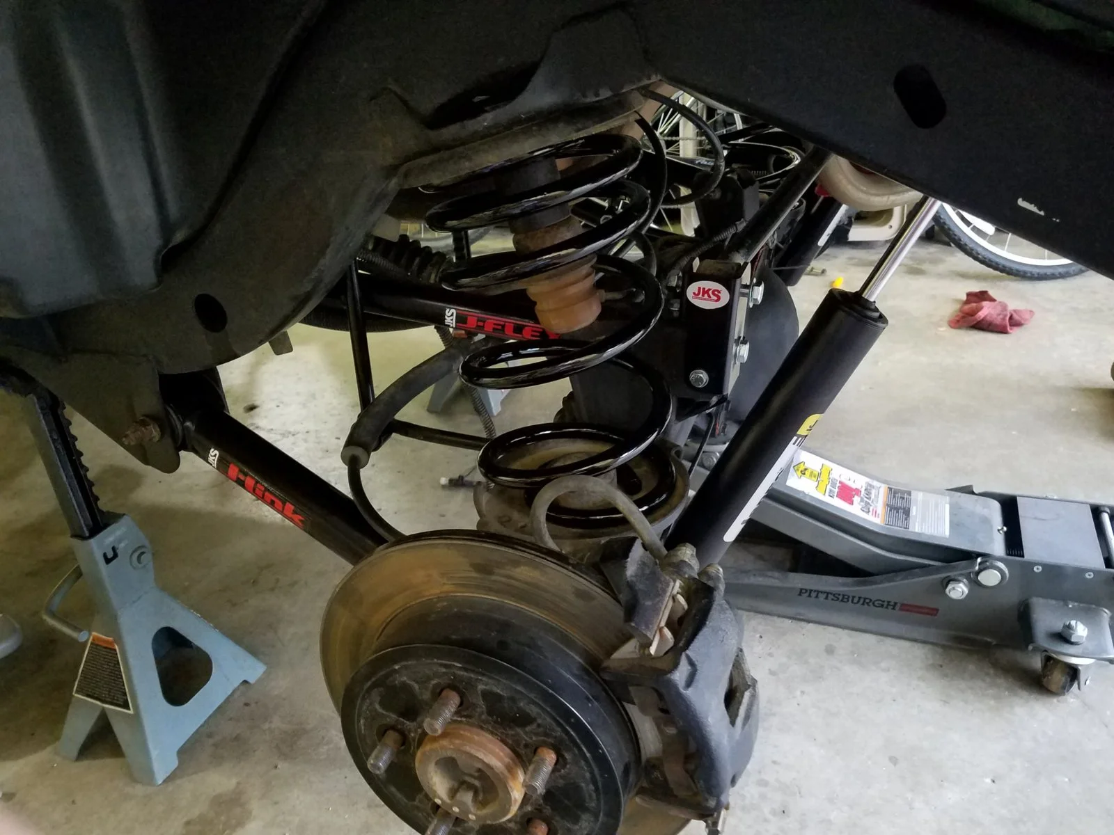

I'm currently in the middle of installing the 3" JKS JSpec on my 05 Rubicon. So far I have the back finished and working on the front half now. Right now with the rear on the ground its measuring 4.25" of lift rather than 3". I'm a little worried about this as I really wanted this dialed in at 3". Ill have to finish before anything is official. I purchased 33x10.5x15 BFG KM3's and I'm worried I should have just went with 35's if its going to be a 4" lift. If this ends up being a 4" lift in the end Ill be reaching out to JKS to see if I can switch to the 2" springs using all the same parts that came with the 3" kit. Likely the answer is yes.

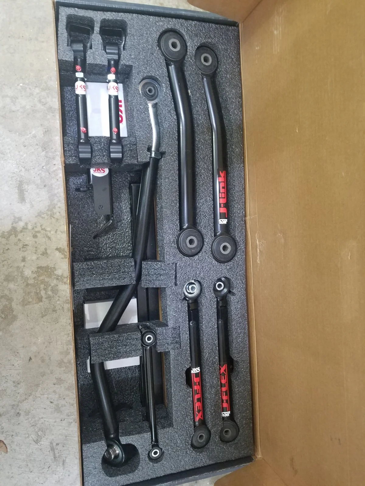

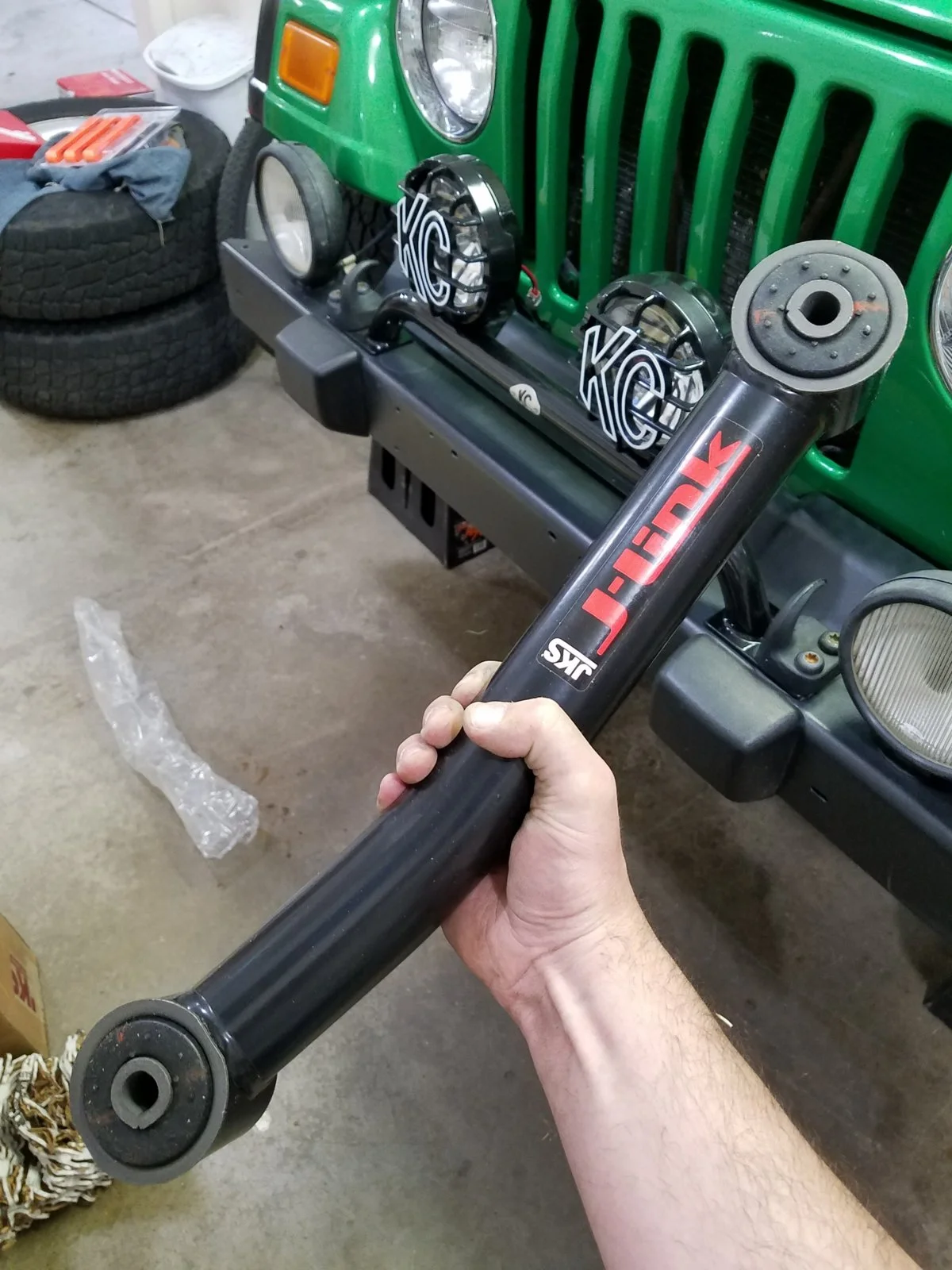

It is a quality kit. The control arms, track bar, and brackets are all beefy. I added fixed lower control arms, and adjustable upper front control arms. I'm also using the JSpec shocks. I had myself sold on a Rock Krawler X Factor kit, until I was talking to Verne Simons (journalist for Petersons 4wheel mag). He sold me on the idea of using all JKS control arms and track bar with a different brand spring (I can't remember what he said to go with). But now I wish I remembered because I might be swapping springs until I find something I like. But again, too early to say yet since I'm not done. I figured I would just start with all JKS since the kit is so complete.

Careful taking measurements until both ends are on the ground. Depending on where your jackstands are, the balance point and frame flex will affect them. I had like 3.5" of lift on the rear when I did my 2" OME lift until I got her on all four wheels again. Once I was done, it measured out perfectly at 2"
You could also have some sag in the OEM springs. Get it on all fours and drive it then access where your at.

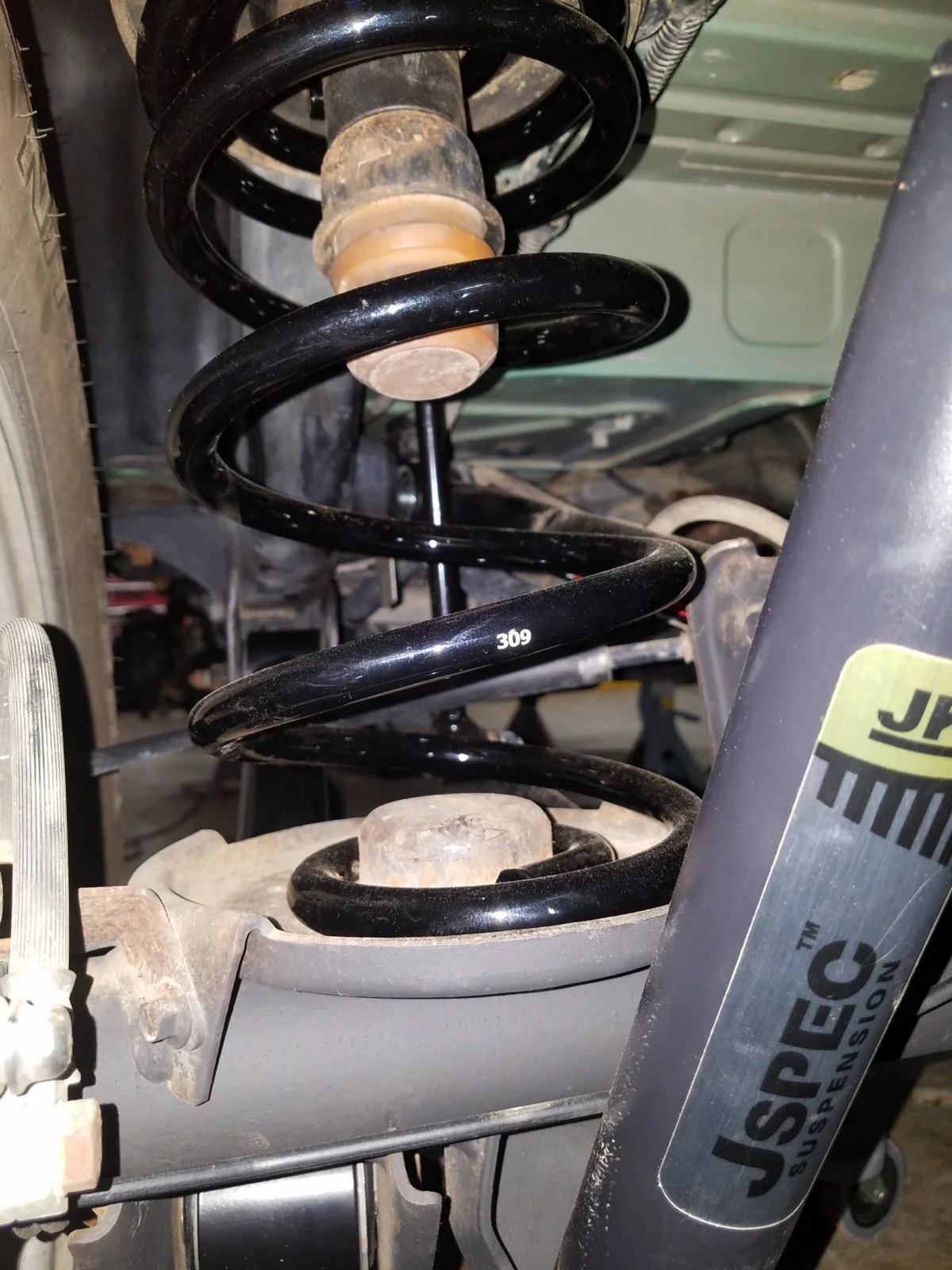

Mine are the 309 spring also and I gained 3.375" over the old original springs.

These are the 3” numbers
Uncompressed Length Front: 20
Spring Rate Front: 150/200
Uncompressed Length Rear: 15.125
Spring Rate Rear: 190/240

Quick update. I got the front springs and control arms in and the rear has already dropped to 1/4" above 3". Still have to do the transfer case drop. My concern is all gone.Ill post pics after I get the new wheels on and get the last few things dialed in!
