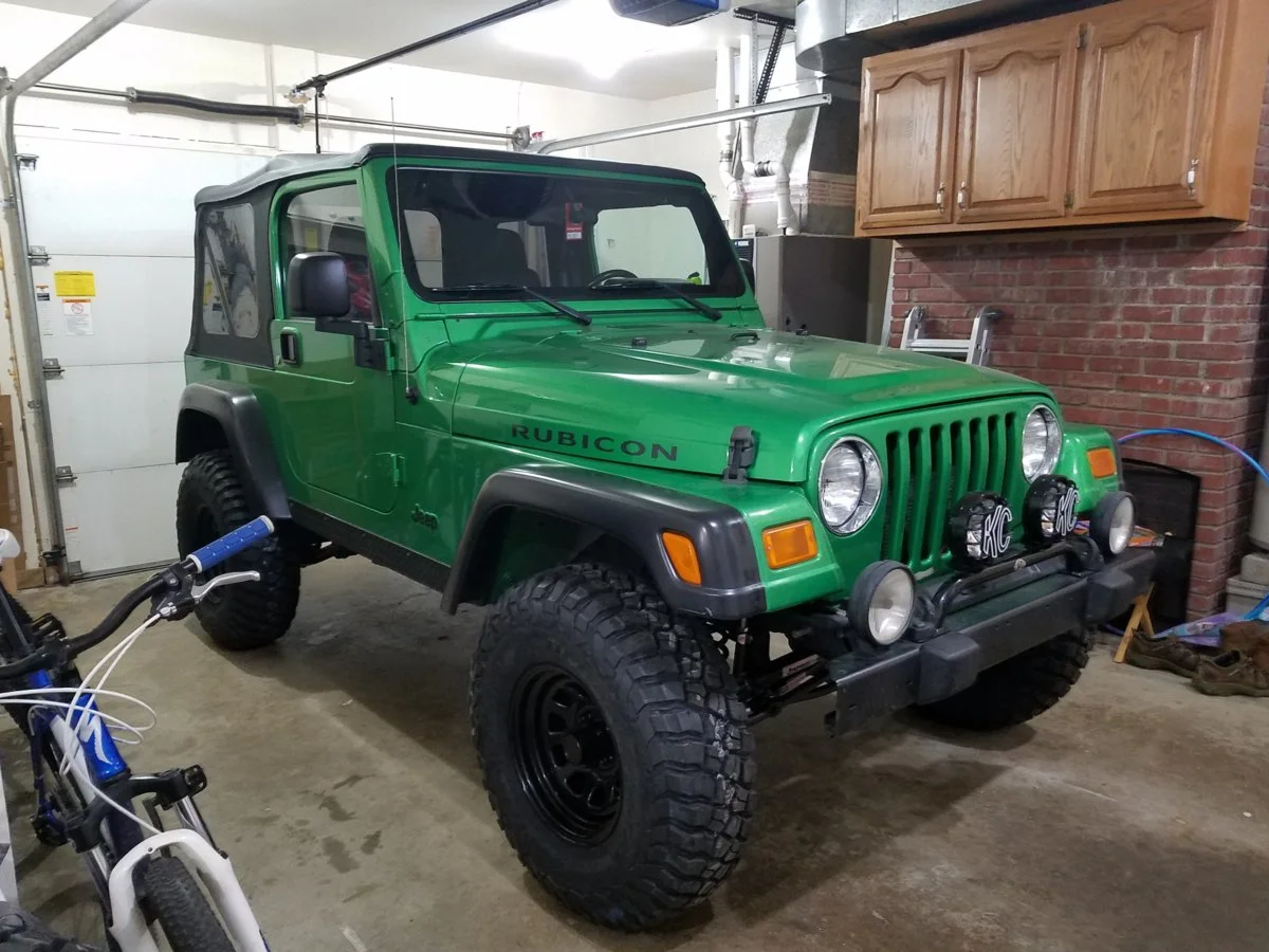

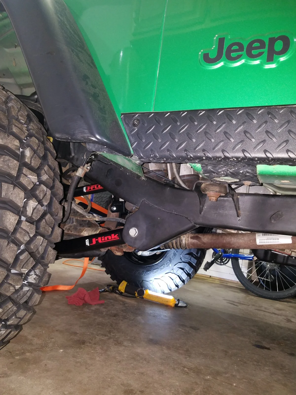

All done installing parts! Just getting the alignment dialed in, figuring out pinion angles, and rear driveshaft plan. Teaser pic! 😋

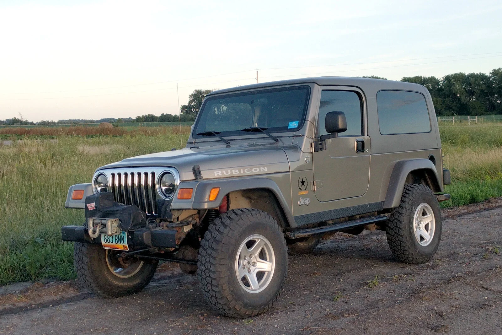

Life got in the way and I finally got to take the Jeep out on its first drive last night after I got my new drive shaft and finished setting adjustments. It drove and felt good. I still have a little tweaking to do as I do have a little steering wheel shimmy I need to figure out. I havent had a chance to get a good pic outside of the garage yet so here you go!
