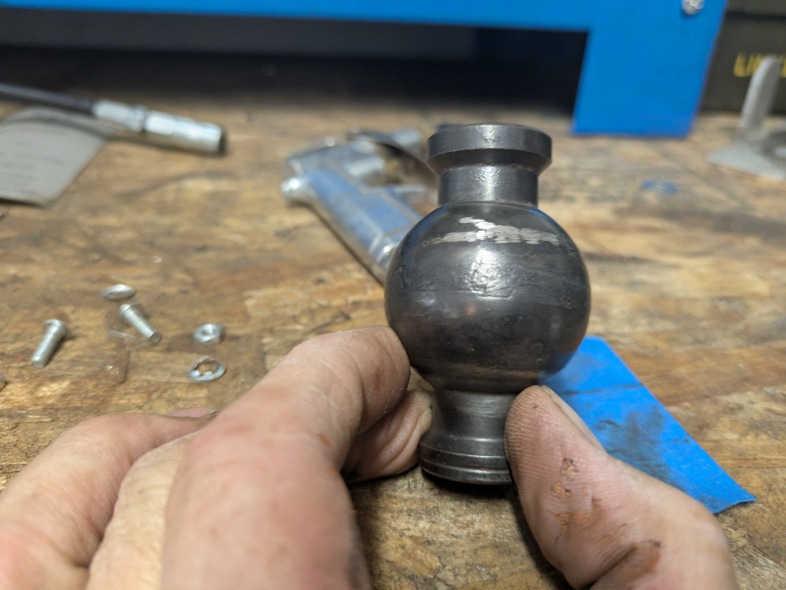

I've been following all the Johnny joint threads and figured it was time to pull my control arms and inspect the joints.
I live in Western Washington where we get lots of rain.

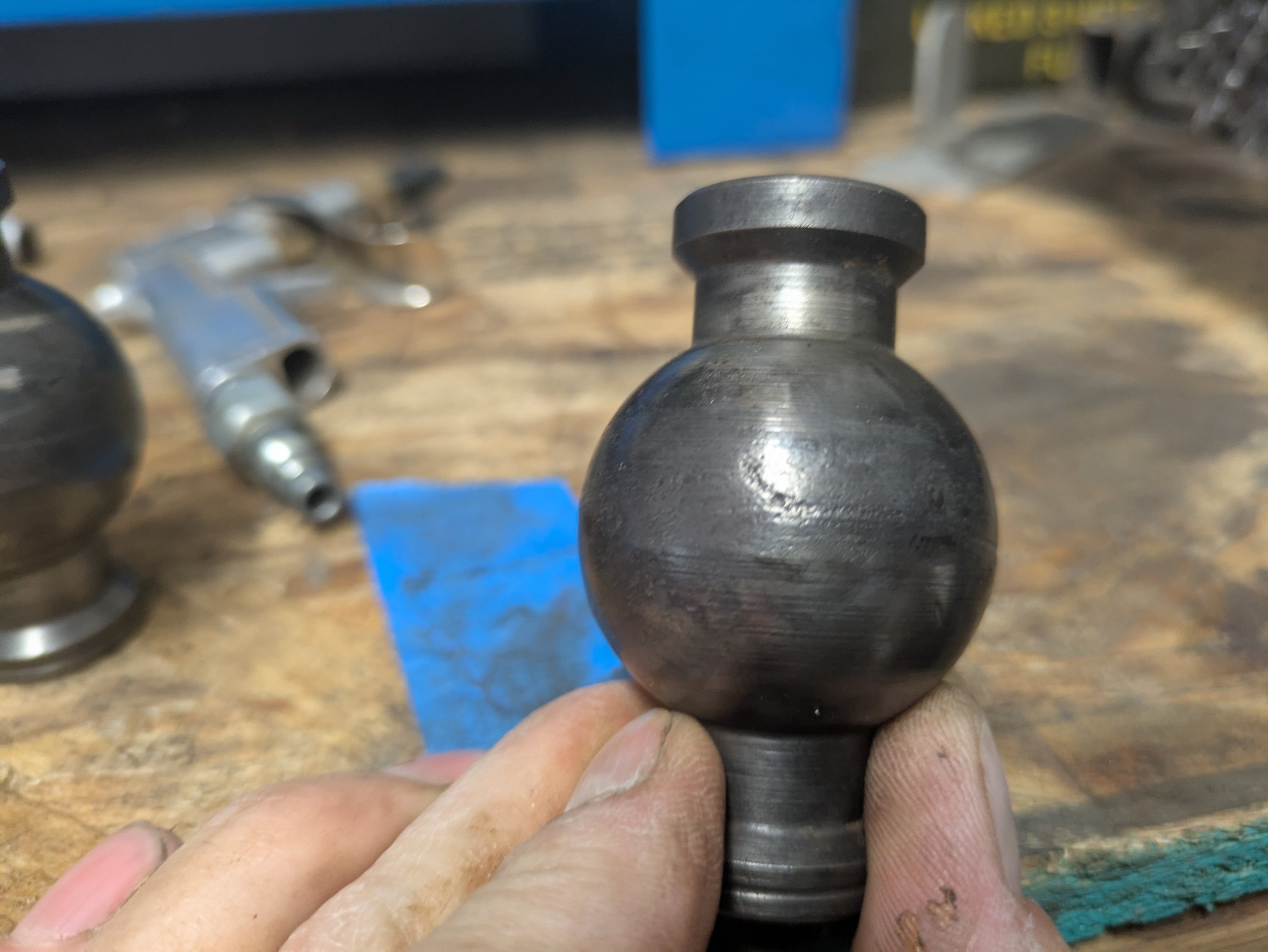

What I found, and am still finding, is that it appears most of my joints MAY not have been greased from the factory.
Almost every ball has pitting on it. Most of the centers of the joint housing have a thick deposit of urothane stuck in place.
I'm fairly certain this has occured do to being dry.
I have found a few that definitely had grease, they look, feel, and act differently than those without.
MY big question for those who know more/ better than I, should I be buying new cups and balls?
So far I have noticed about half of the balls are pitted.
That’s about how most of mine looked after about a year. They were near impossible to move and creaked like the dickens. I now disassemble and grease them twice a year because I hate the creaking. The “pitting” you see is how mine looked too, even when fairly new.

The balls were never smooth to begin with. When assembled, are they loose in the races?
Josh,
When I removed them, not at all.
Rusty and so tight I could not get the ball to center, and had to use a 12" punch to center them in the disassembly tool.
After wire wheel the balls, and cleaning the cups w mineral spirits and steel wool, then reassembling, they are very "moveable".
Very easy to move. None that I have removed so far have been moveable by hand, until the cleaning process

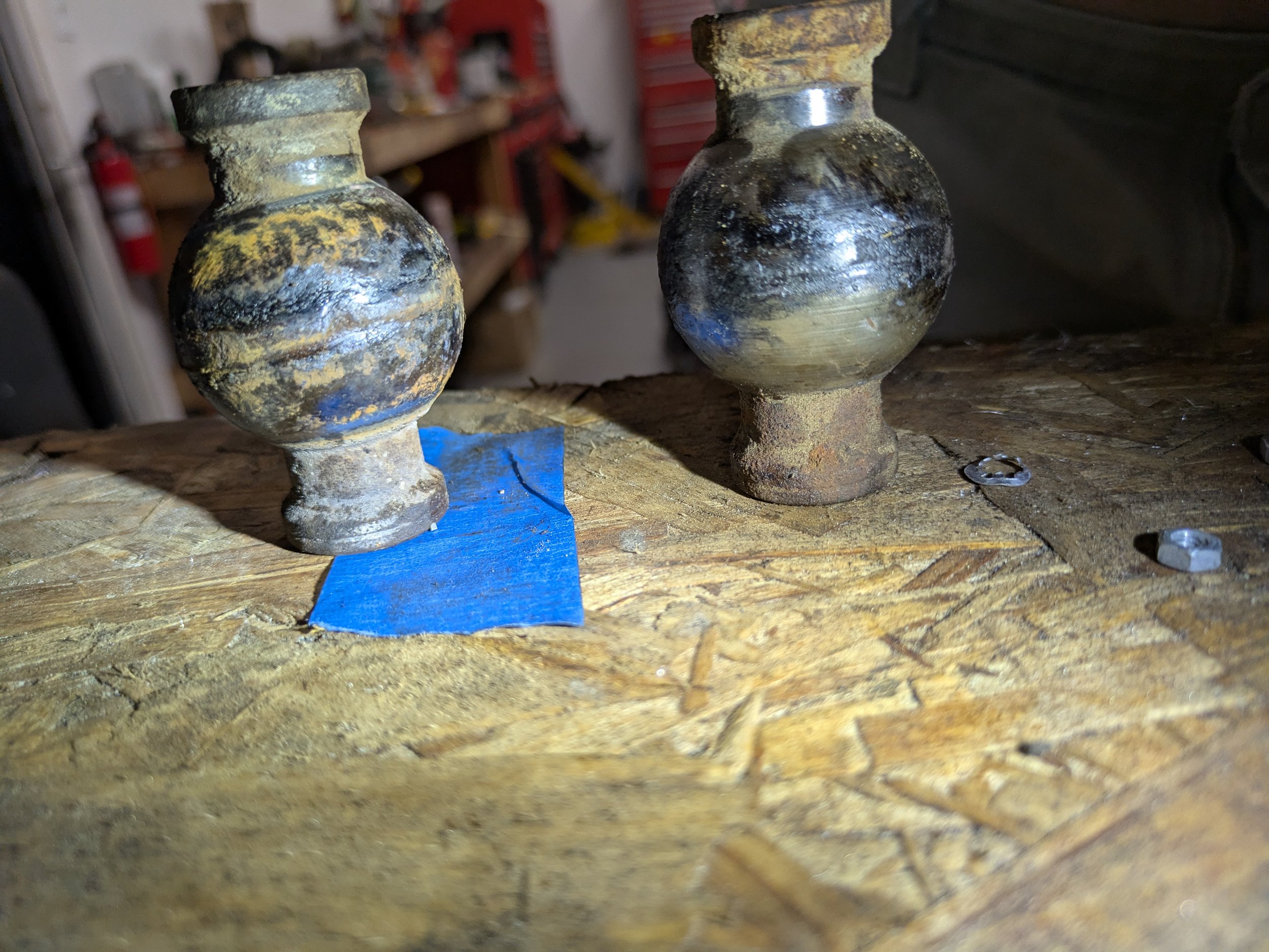

There are 2 different scenarios when I disassembled the joints.
The first scenario, there were very obvious grease remnants. Those balls were also centered in the housing, or went back to center easily. I found remnants of grease in those, or semi a dried remnants. They also (for the most part) had no rust on the ball itself.
Then, there were several, about half, that were so rusted, I could not use the disassembly tool without first soaking them in Kroil. Then after waiting a bit, I was able to force the ball to the center and, could then use the disassembly tool on them.
Those mostly had rust in the cups, and I really could find no evidence of past grease.

It is very easy to find out which one of us is full of shit. Take a new JJ, take it apart, thoroughly clean and remove all the grease from it. Reassemble and go drive it. It will make noise instantly. This has nothing to do with Savvy. They did not assemble the arms, they did not install the suspension, I did and if the joints were dry, I would have fixed that before the rig left here. If it isn't inherently understood, they don't install as they come (the joints) out of the box. We have to manipulate the balls to line up bolts when we install the arms so we know instantly if there is a problem.
If you want to do it right, shorten your maintenance interval to something other than once every 5 years.
