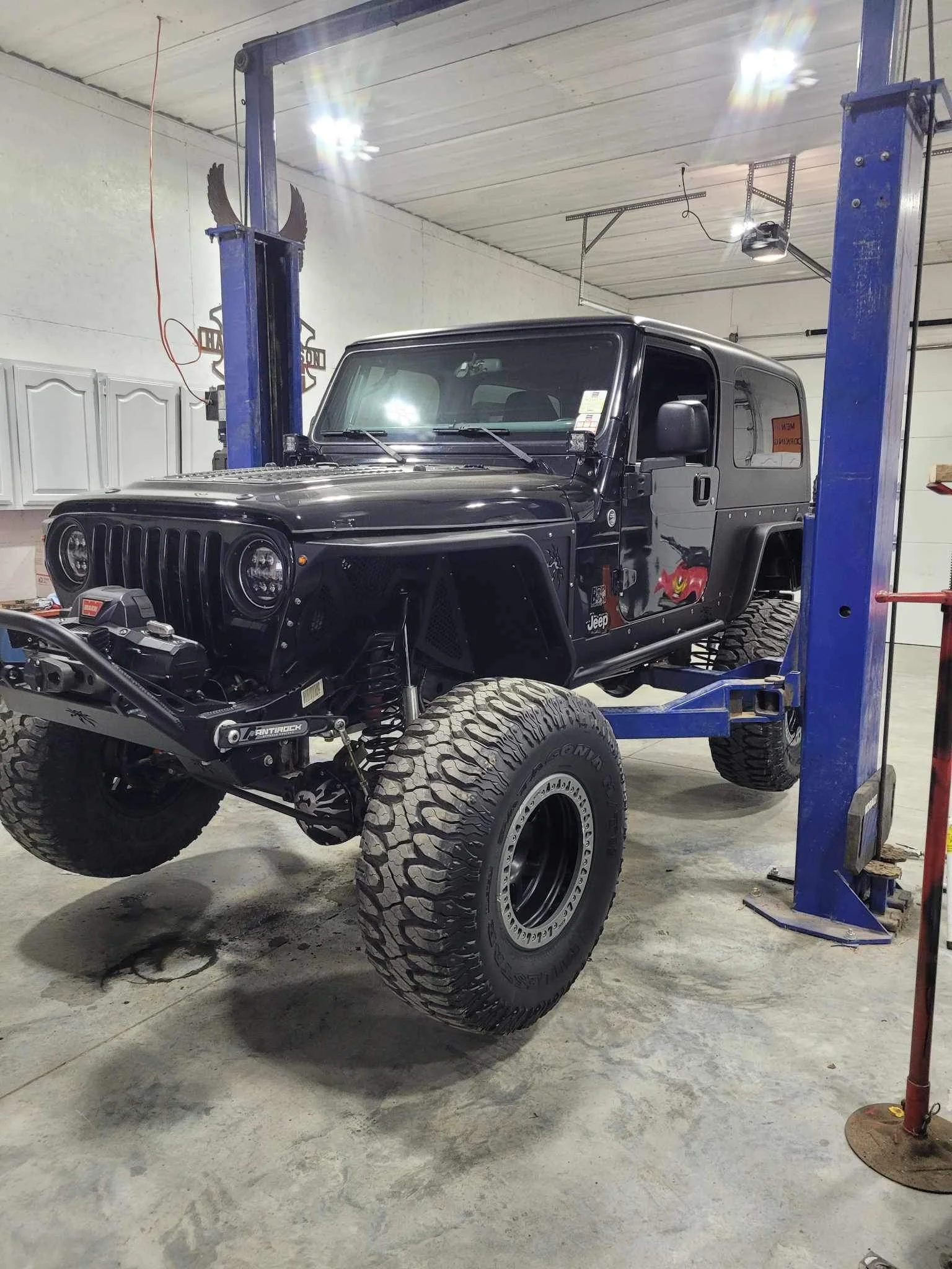

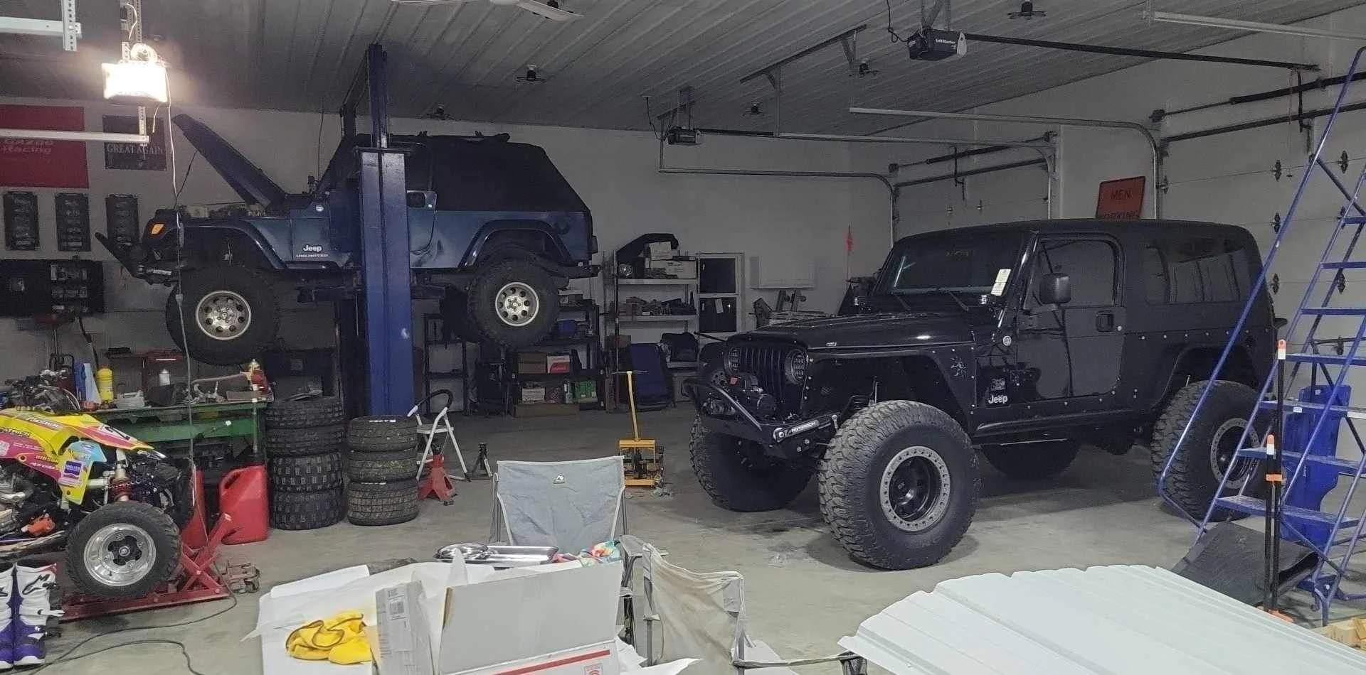

I have no idea if he is member here or not actually. Saw a post on FB group asking about swapping auto to manual reached out said hey I want to do opposite only to find out same year, both have Savvy tuck and not that far from one another. Few conversations later his Jeep is at @LJonloan shop.
@LJonloan shop looks damn good. Too bad all three are having some sort of work done on them and of course black LJ isn’t ours.

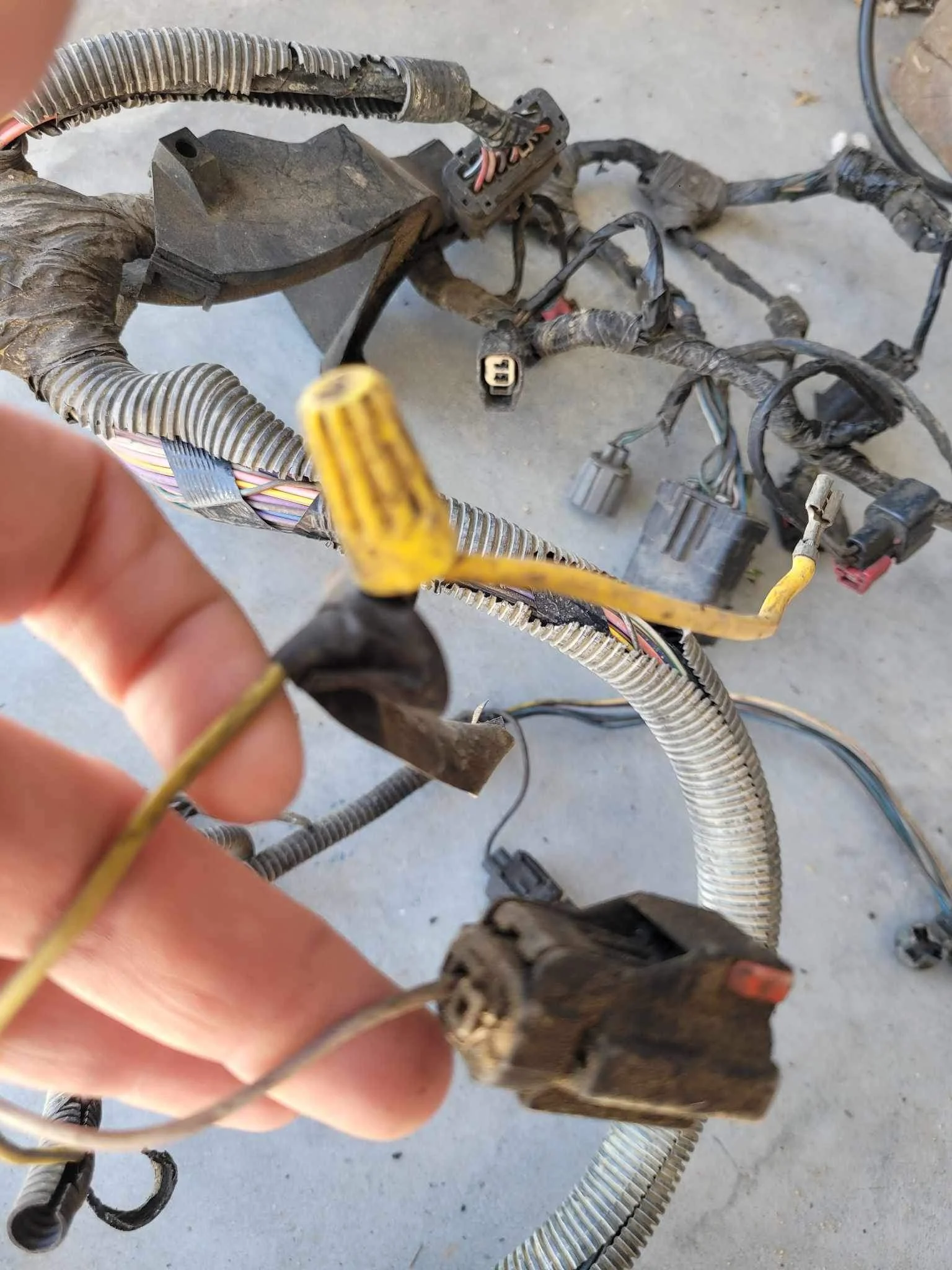

@JMT these are correct parts for splicing the harness right. The joys of buying harness from salvage yard. But overall good shape only like 3 spots that need attention and of course some loom.
Reactions: JMT

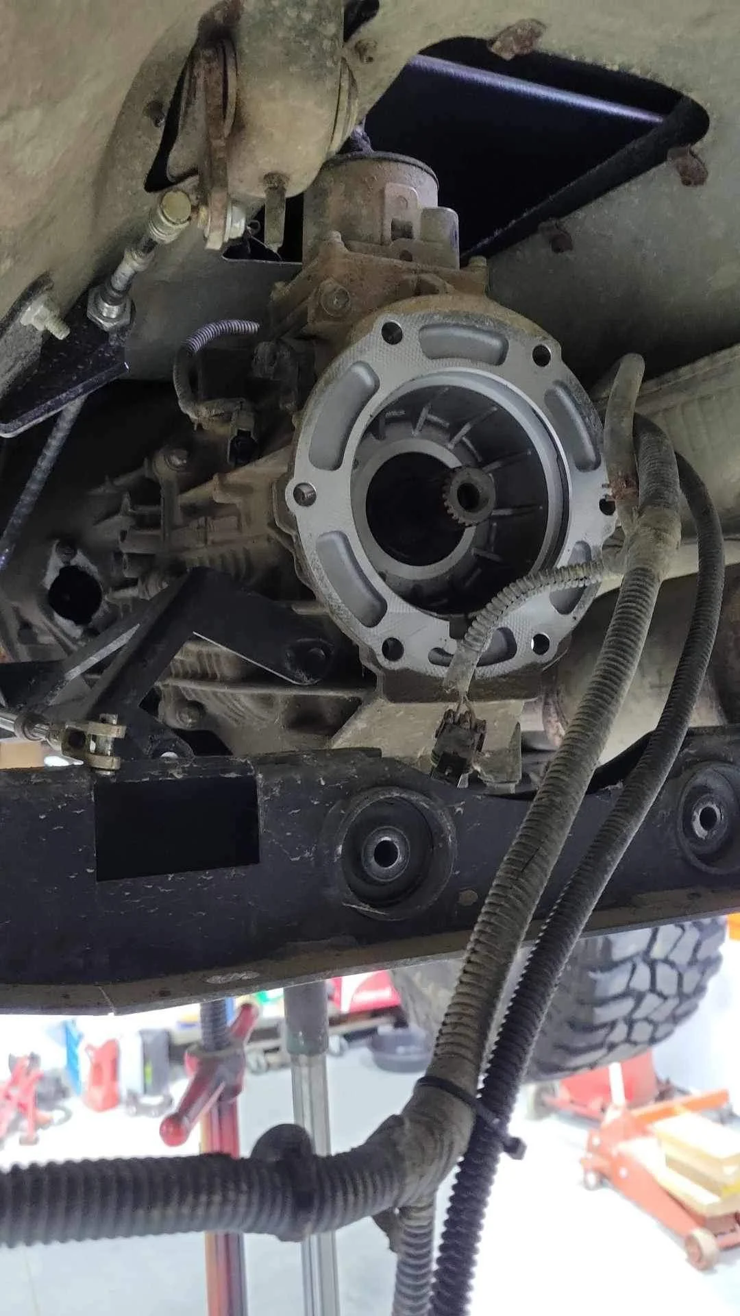

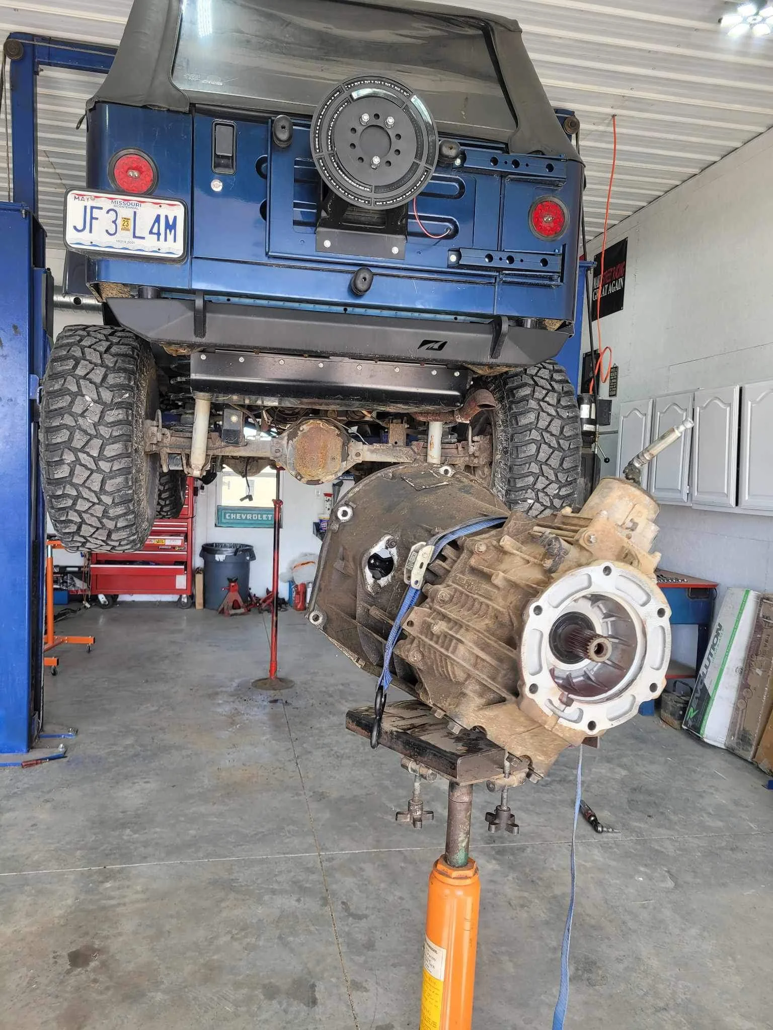

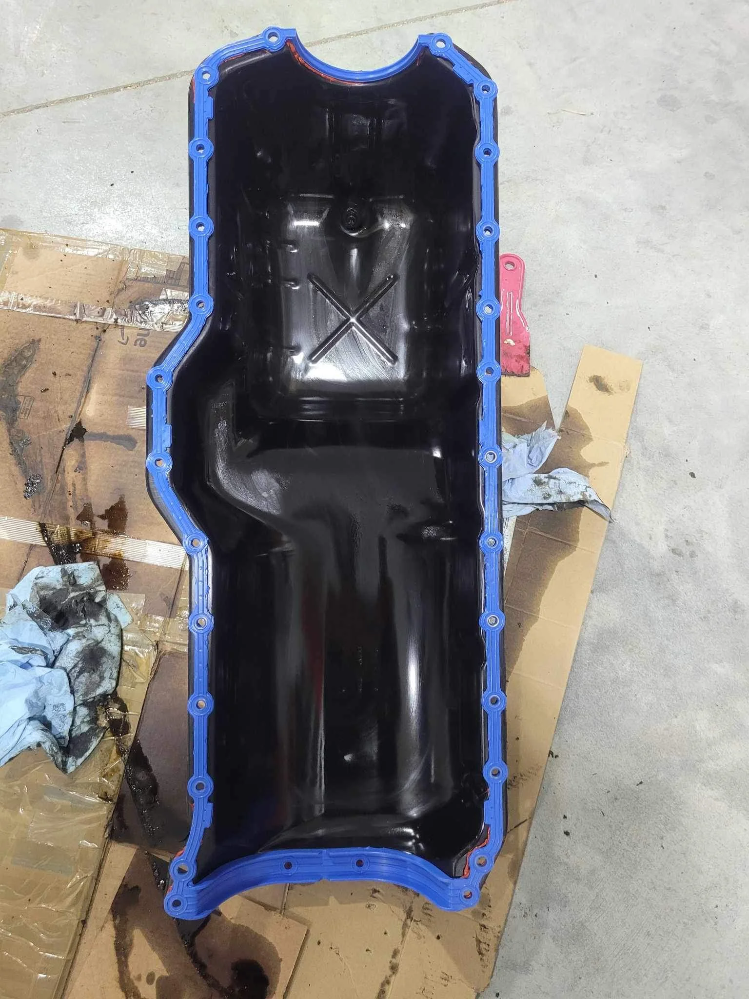

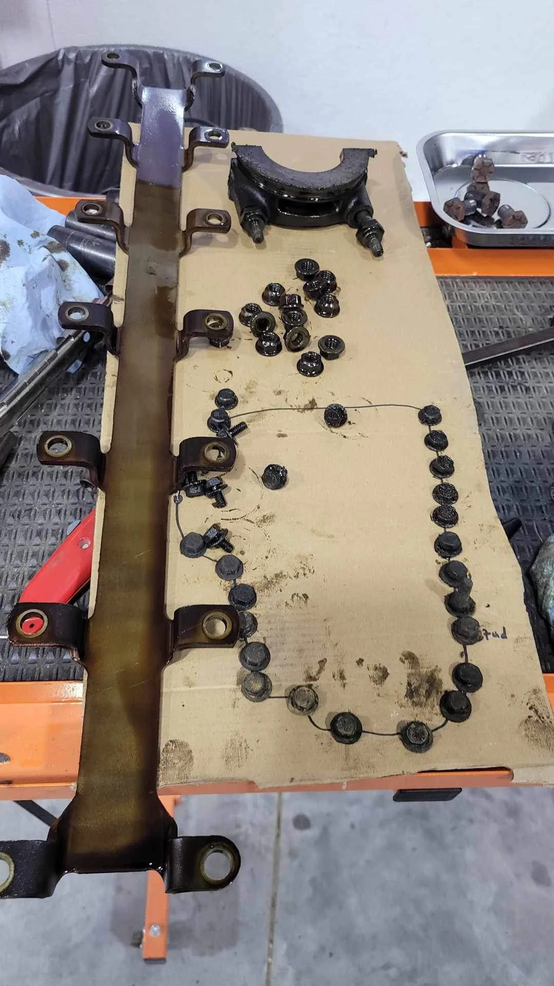

Transmission out cleaned up, RMS and oil pan gasket changed on my LJ so it is off the lift for now.

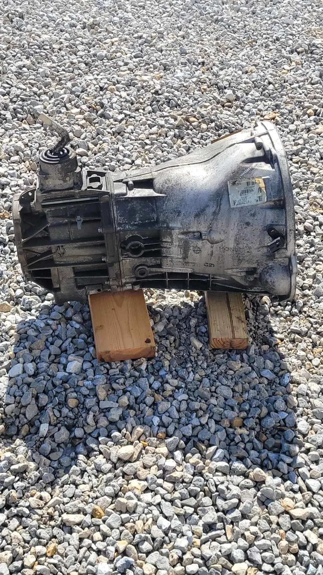

Time for tear down on this LJ to begin so 6spd can get stuffed into it.
Reactions: Wildman and JMT
Reactions: Wildman

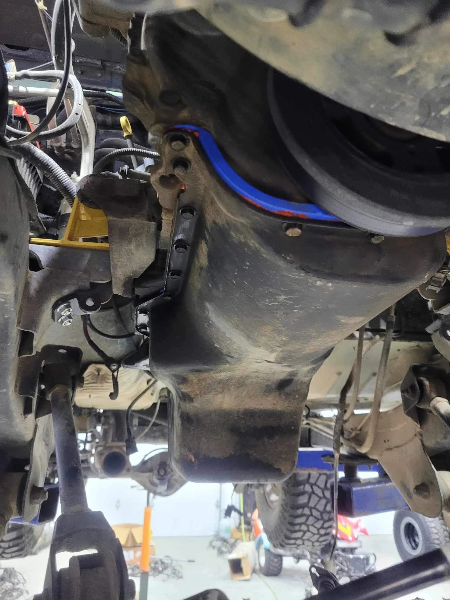

Something looks familiar. Unsolicited advice. Let that anaerobic RMS sealant cure 24 hrs.
Right now it got rolled outside while auto gets pulled, manual stuffed in that LJ and buttoned up. So it should have plenty of time.

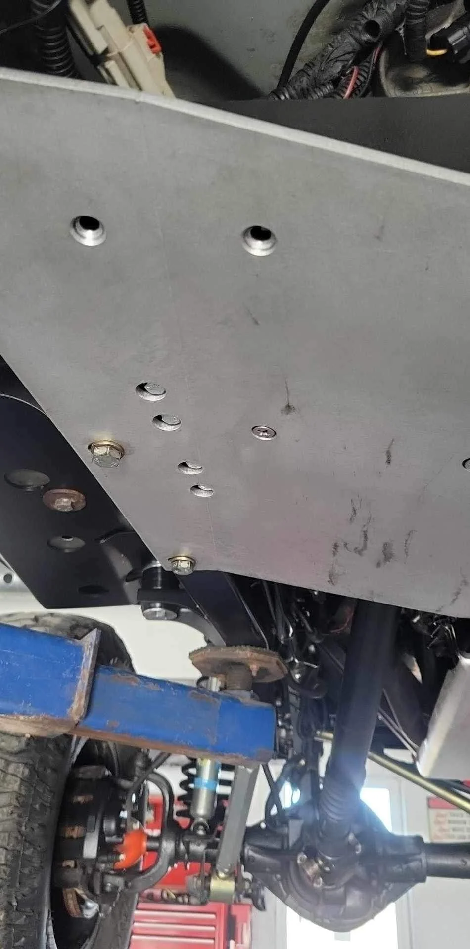

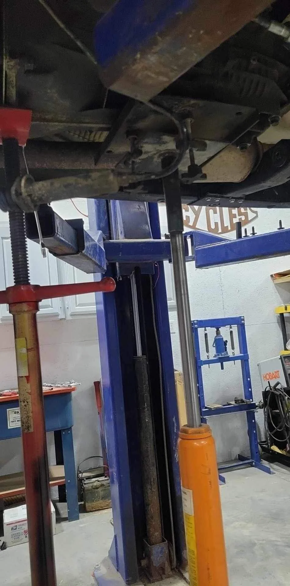

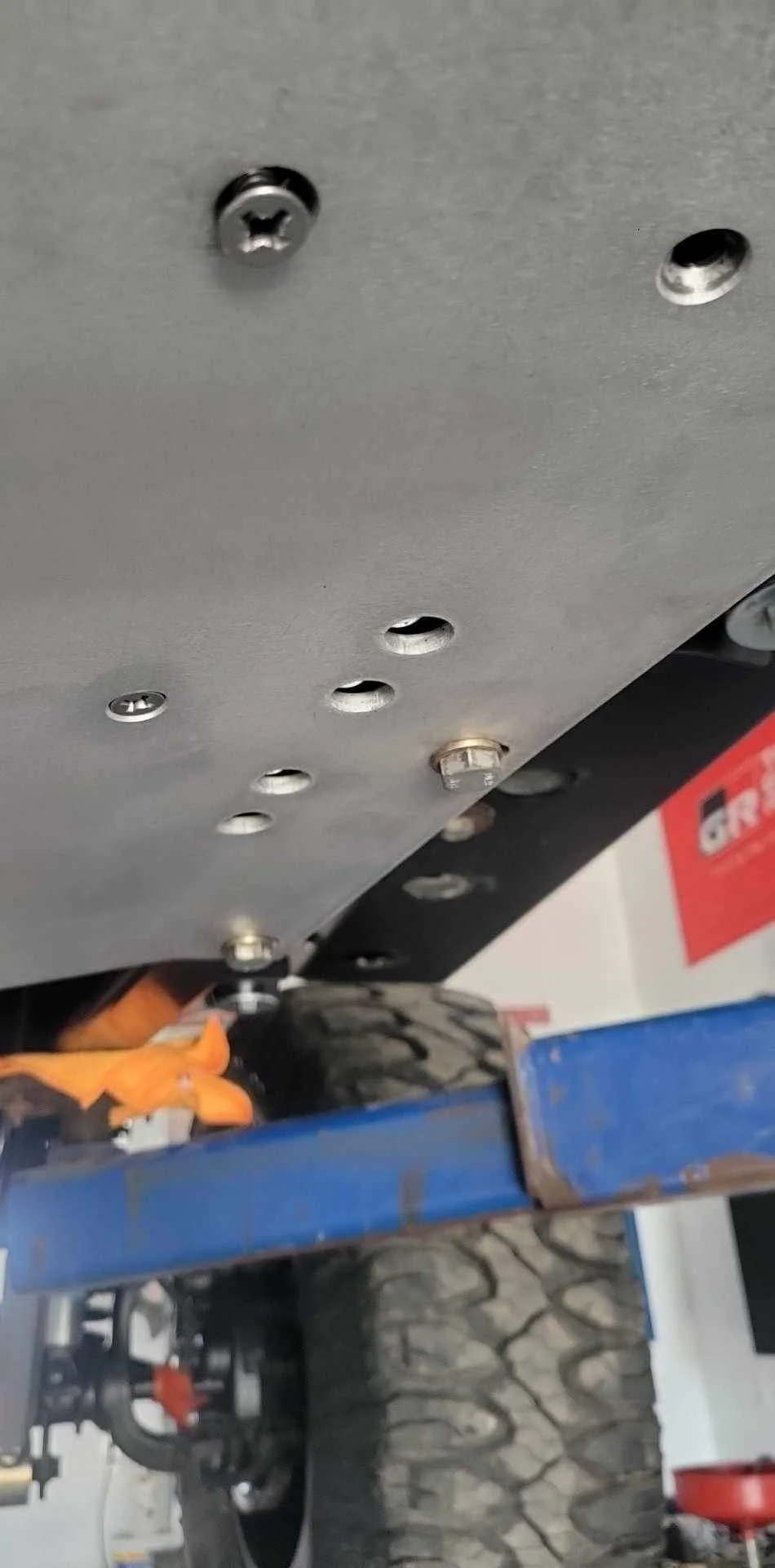

So put the auto LJ on lift to start process and found this. Some missing, some clearly not right. What is the recommended fix here? Link to product or thread greatly appreciated.
  • Wow
Reactions: Wildman
Bolts:
https://www.mcmaster.com/products/b...16-stainless-steel-phillips-flat-head-screws/
scroll down and choose 5/16-18 in 1"
Nuts:
https://www.mcmaster.com/products/locknuts/material~316-stainless-steel/flange-nuts~/
choose 5/16-18
Make sure they are tight. They should hold, but I ended up using blue loctite on mine.
Reactions: Wildman
TY Is there a good tool to use, @LJonloan said had trouble getting them right when i stalled mine and couple were backing out.
No special tool. I put them all in and get them started, then tighten them down. Otherwise you can have trouble lining the others up. 1/2" wrench on top and a 1/2" socket on the bottom. I use the drill with the 1/2" socket first to get them snugged up. Then hand tighten them with a 1/2" socket wrench.
p.s. I haven't re-installed my skid, but it's on the docket today. I've been waiting to ensure no leaks. Now that I'm leak free it's time to put it back on.

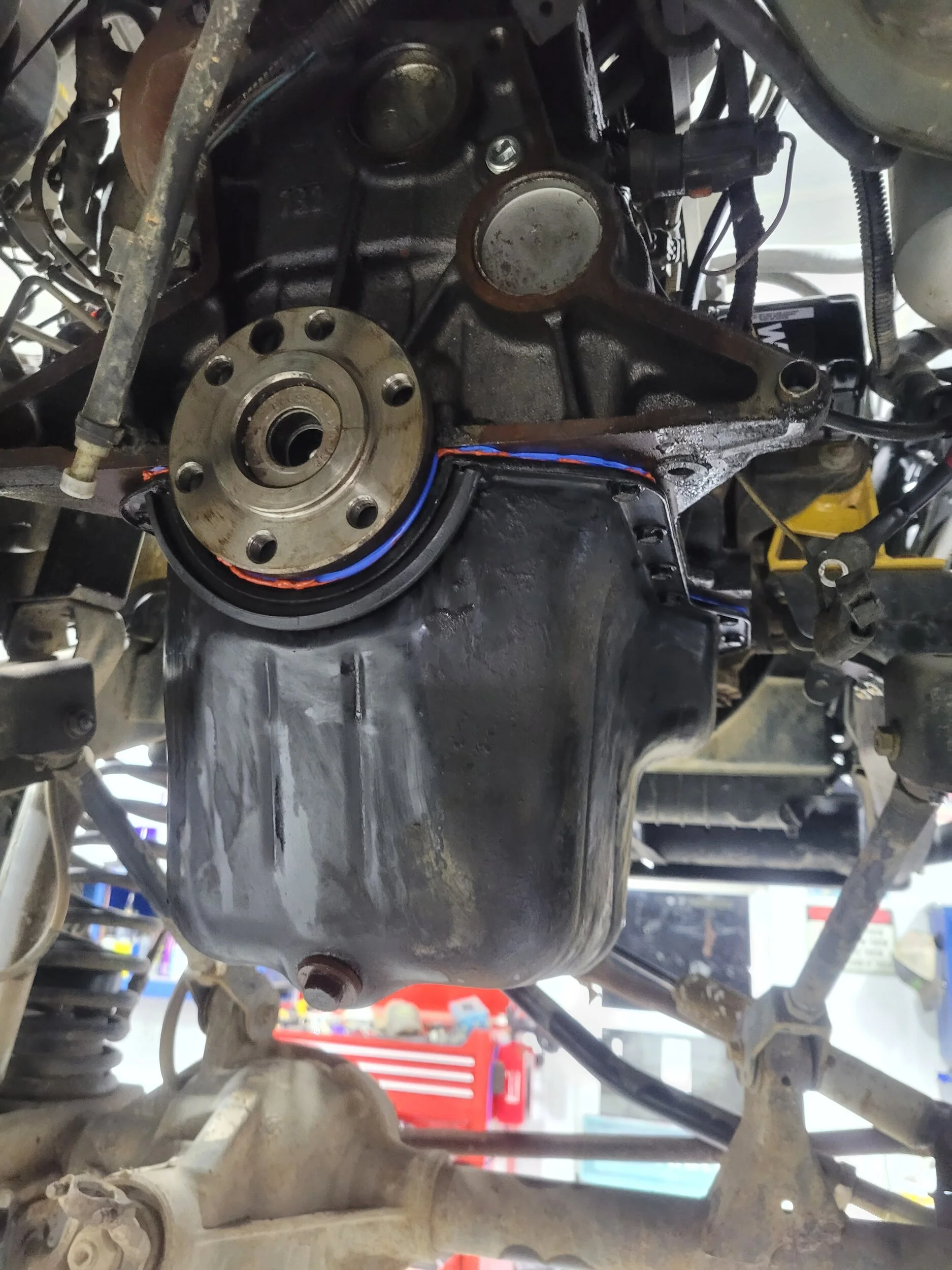

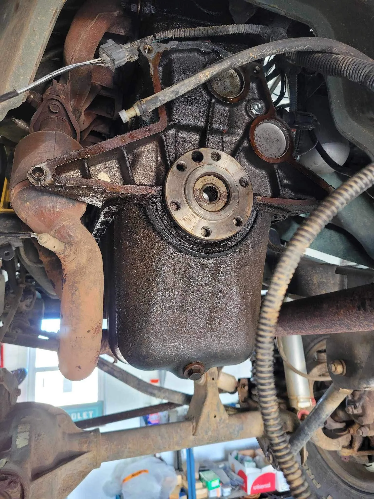

Well damn the black LJ has small but apparent RMS leak. No better time to address it than now I guess. Simple transmission swap LOL

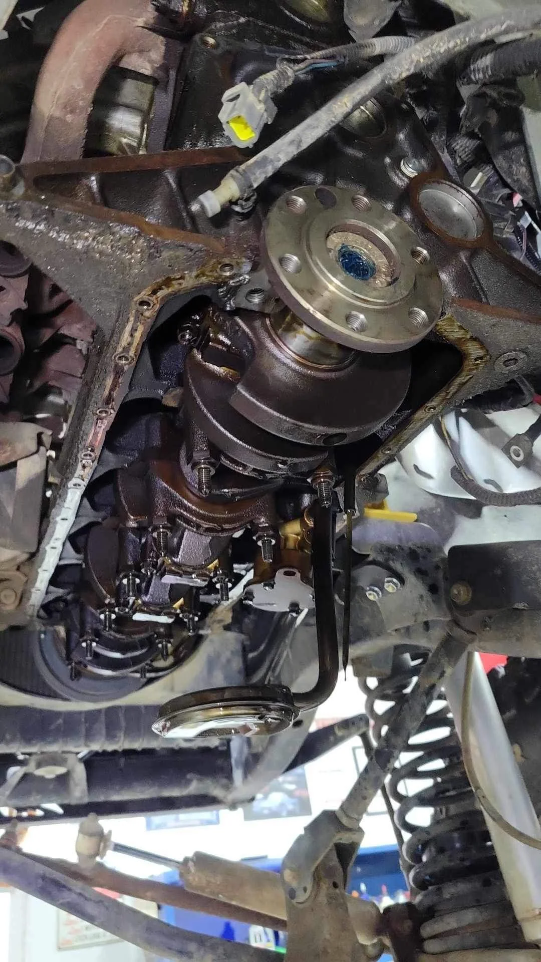

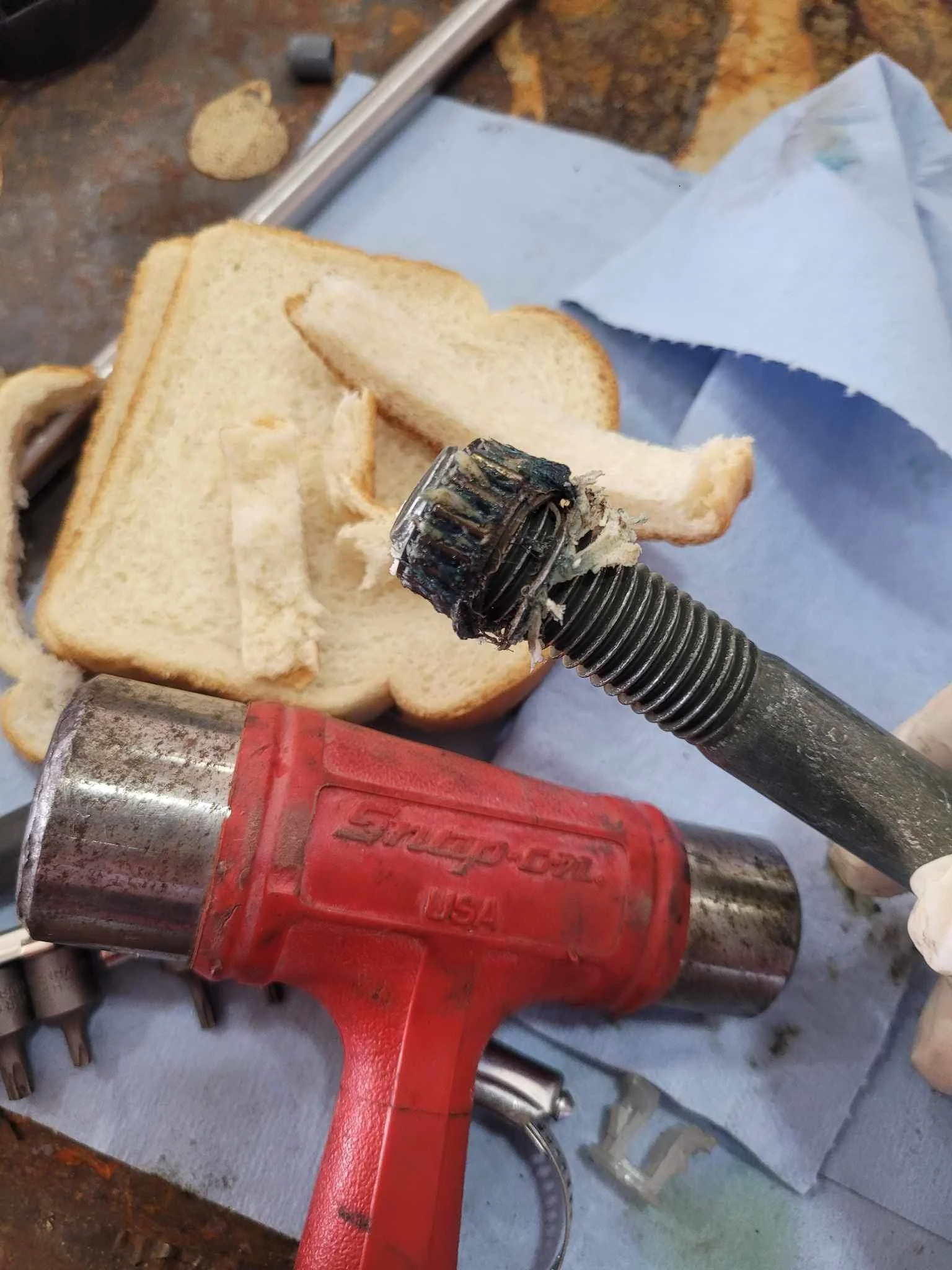

Don't believe I have the right tool for the job here. I got both transmissions out and the pilot bearing but need to replace the crank bushing. I have a blind bearing puller but can not get it to lock had enough to get it to budge. What tool do i need. Thought about welding a nut to it but my welder is inop at the moment.
Grease and a tight fitting punch. I welded a nut to mine. It was Spain in the ass. Maybe @mrblaine will post another picture of the tool he uses. It’s pretty slick.
I have the pilot bearing out but now need to get the bushing out. You think the bread trick will work with the bushing too? I'll have to hunt for a pretty large bolt to push it out.
Yeah, If you can get something that fits tight enough, the grease will push it out. Its a pain...I tried my blind puller and the bushing broke away. I think its some sort of powdered metal. A nut works well, because you can use a bolt to push on the crank and pull the bushing. Maybe some JB weld on the nut and epoxy the two together? Drill and tap couple small holes in it and use like a fully threaded number 6 screw?
