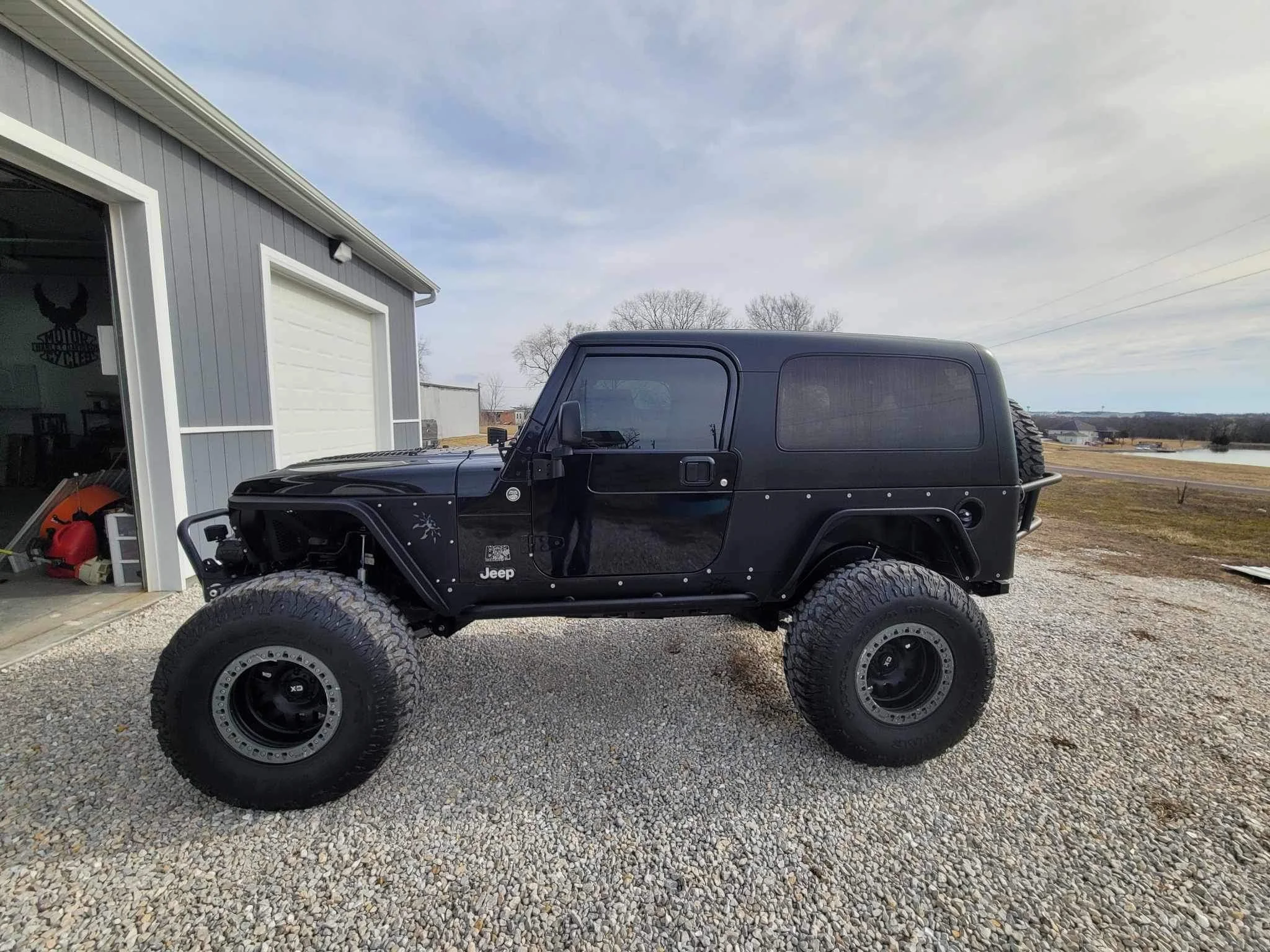

The 42RLE donor has arrived. @LJonloan has started looking things over which means is probably time for the questions to
The 42RLE donor has arrived. @LJonloan has started looking things over which means is probably time for the questions to start.
The manual LJ does not have the AOD harness behind the hvac controls. I assume this means I must pull the dash. Is there another way to adapt the harness to accept the AOD.

His donor is a Rubi auto. These are the 05-06 genre so they have more options in harnesses for some reason that previous. Very few of the 03-04 don't have the OD off switch stored in the bezel in the manual rigs. I have not seen the same in the 05-06 yet.
He doesn't need to swap the dash harness in the Rubi auto donor, he'll just have to add a wire from the clutch safety switch to the PCM to complete the NSS circuit. That and he doesn't want to pull the cage which can be a monster PITA.
He does need the Rubi manual harness to put back and get the locker pump wiring and air lines. His Sport doesn't have that so swapping in his manual harness would require some stripping of the locker stuff out and then checking it to make sure something isn't missing. I am 99% sure that the Rubi harness out of the auto will work in the Sport though. There will just be some unused locker and locker pump bits.
so, he could use my leftover harness for the parts he needs to convert his sport harness to work with the rubicon?
First thank you for taking time to talk with my brother. Heard you had to school him on left vs right. Was a lot of info so he wasn’t sure if got it all down correctly in his notes. Was going to be putting together an email to confirm with you but if you don’t mind doing that here so anyone can use your knowledge.
Is following correct?
I for sure need 05-06 Rubicon manual engine harness Might be able to swap bits around but if can find at reasonable price seems easier
I need 05-06 auto dash harness as won’t be pulling the dash harness buried under PS cage
I can use the engine harness from the 05 Rubicon auto just may have a few rubicon specific connectors to hide ?
What about chassis harness, does anything need to be done there?
Oh and please let me know when get envelope just so I know made it into right hands.
