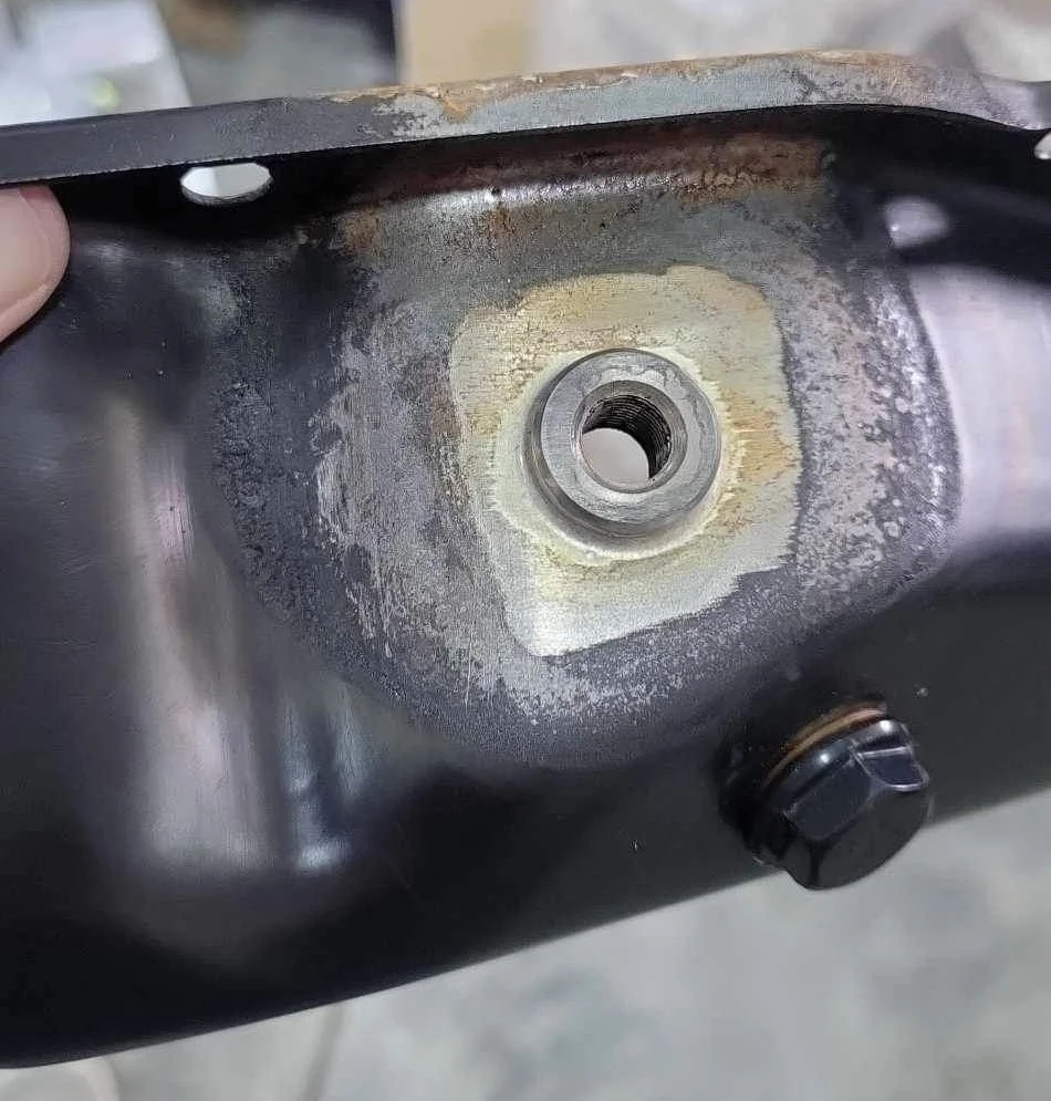

What is recommended for temp sensor and bung if I get the new Dorman 265-818 pan. Need to have that done somewhere as is beyond welding skills or equipment my brother has.

You can drop ship a Dorman pan to Blaine and he’ll braze in a bung for the transmission temperature sensor. EDIT: the sender that threads into the bung in the pan comes with the gauge that you install in the dash area. This is the one I purchased.

Yep, we do 20-30 pans a year now. I keep a couple of dozen stainless steel bungs here along with the silver solder and flux.

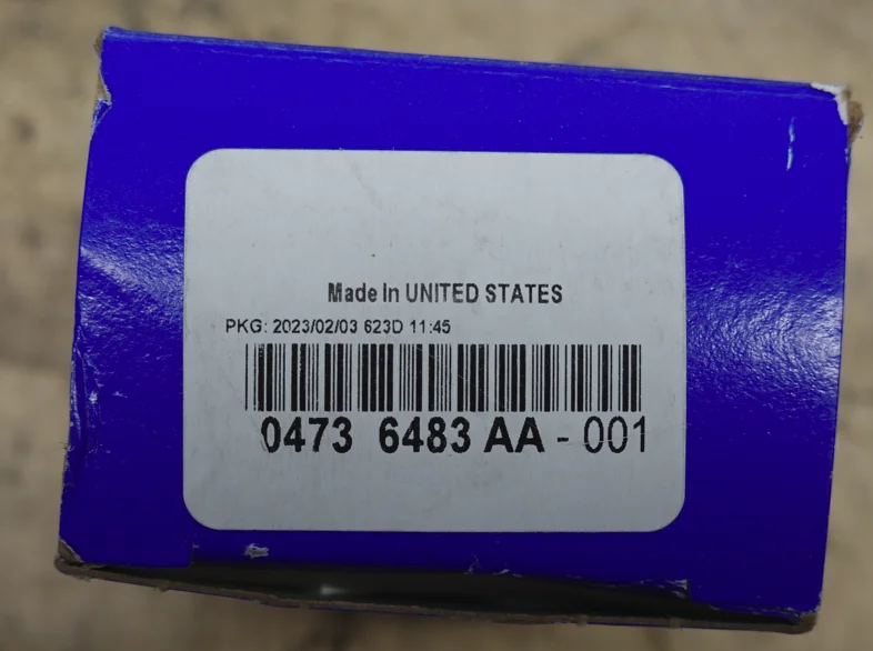

Do you have part numbers for pilot bearing and torque converter bushing? I’m seeing diff numbers and then both say won’t fit ‘05 when try cross reference

I don't know of any of the pilot bearing and bushings that don't work. We use Mopar but it has been awhile since we bought one. I'll dig up the converter bushing number later today.
Do you have part numbers for torque converter bushing?

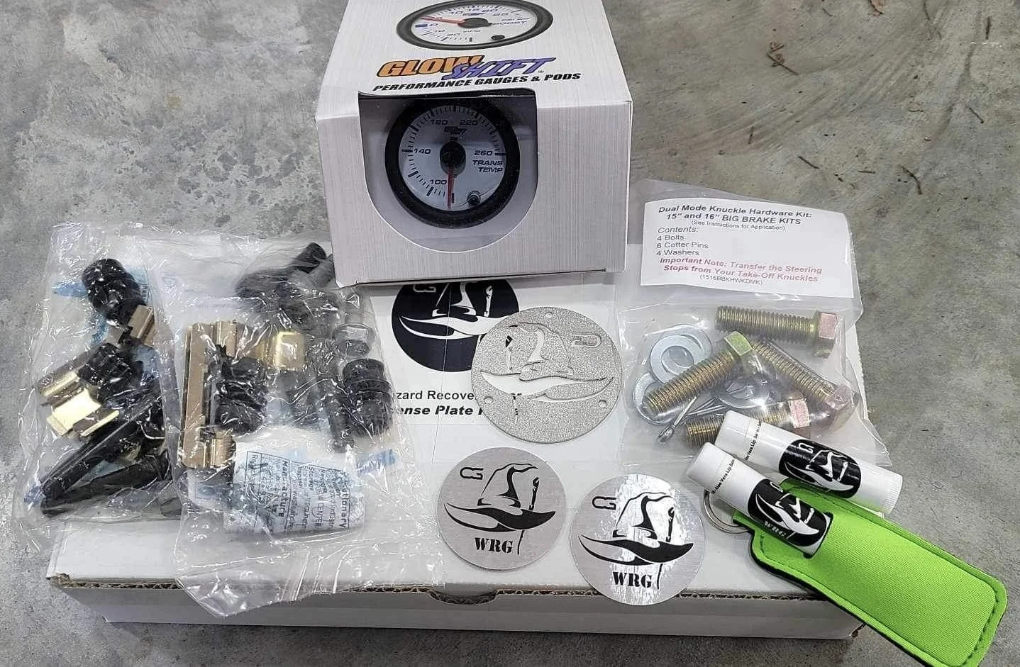

Oh, I made fun of you, I just didn't do it where you could hear me. I trust everything arrived okay? I did not have a box that size so I reused the crappy Amazon box and that's always a bit sketchy. One of these days I'm going to figure out that it takes longer to reuse a crappy box than it takes to buy a good one. If any of our box suppliers would sell samples instead of bundles, I'd be in just great shape.
I would explain that hope the blue option will match what have used for lighting but not sure that would help 😁
No box yet but based on previous orders am confident is well packed. Envelope is on counter ready.
Reactions: mrblaine
May have to give that crappy Amazon box bit more credit. Your box was in brown truck with my deliver from Valvoline. Got an oiled covered box from you and UPS report that my delivery from Valvoline had been ‘damaged’. Was all fluids for oil change and transmission swap. Wonder how many people got oily boxes.
My chapstick thankfully arrived unscathed!
Reactions: CMBD and mrblaine
That is great. I do wish folks would keep it when they do a return. I don't trust that they haven't been messed with so I just throw them away.
I wish I could get them uncoated so we could send a batch out for powder coat after the soldering.
I trust the lip balm holder matches at least one of the colors on that silly gauge.
