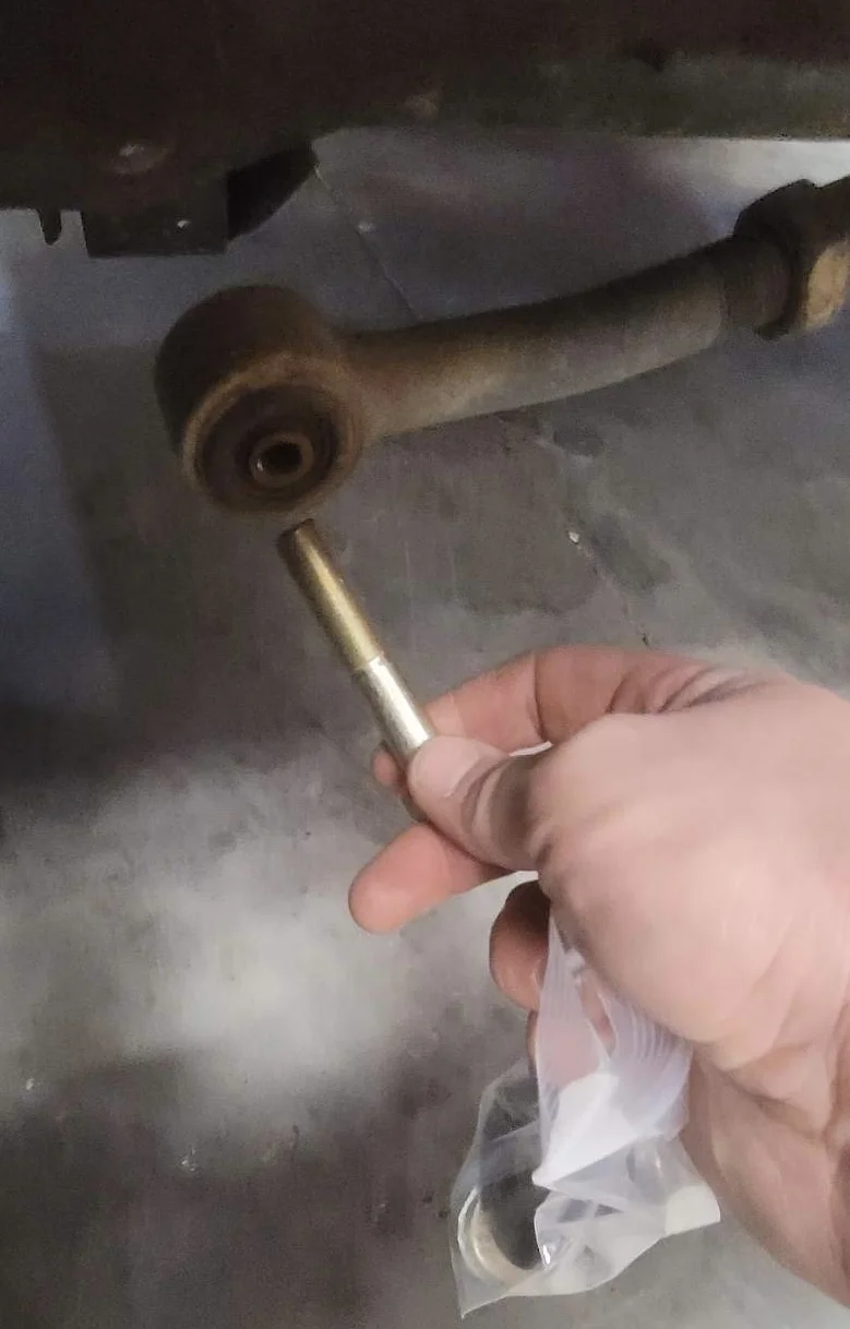

Wow has this thread been neglected. Just like the LJ 😢. After the under armor had a bit of front end wobble. Not full blown but noticeable at around 40. My brother chased it down to like frame side attachment for trac bar. No flag nut and bit loose. So I hop on RockJock website ordered up bolt and flag nut for current rod end. Initial quote shipping is more than the parts. Quick email to sales team got that fixed.
Get message from my brother “umm this bolt you ordered is to big for the johhny joint”.
Yeah that won’t fit
Back to WTJF and figure out I have older style rod end. Ok guess are doing a full upgrade and will have a spare. Talked with same sales guy for RockJock who knocked some off the order and had joint assembled before shipping to save me the trouble. Great customer service and quick shipping both times.

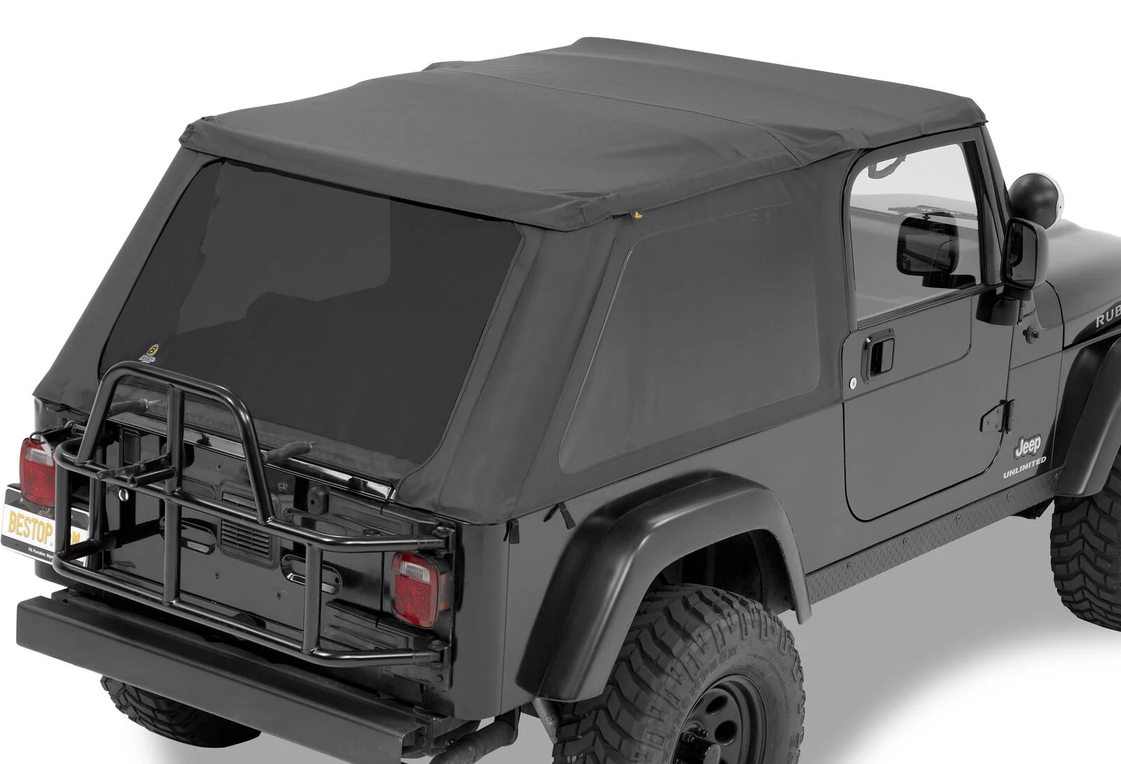

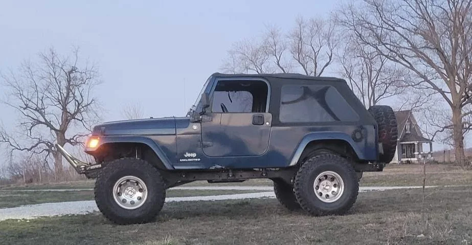

Yeah Trektop. Window storage is kinda pain and looks bit goofy if try lay it down all way. But other than that really like it. And despite what others have said got great service from Bestop when had pin hole near seam.

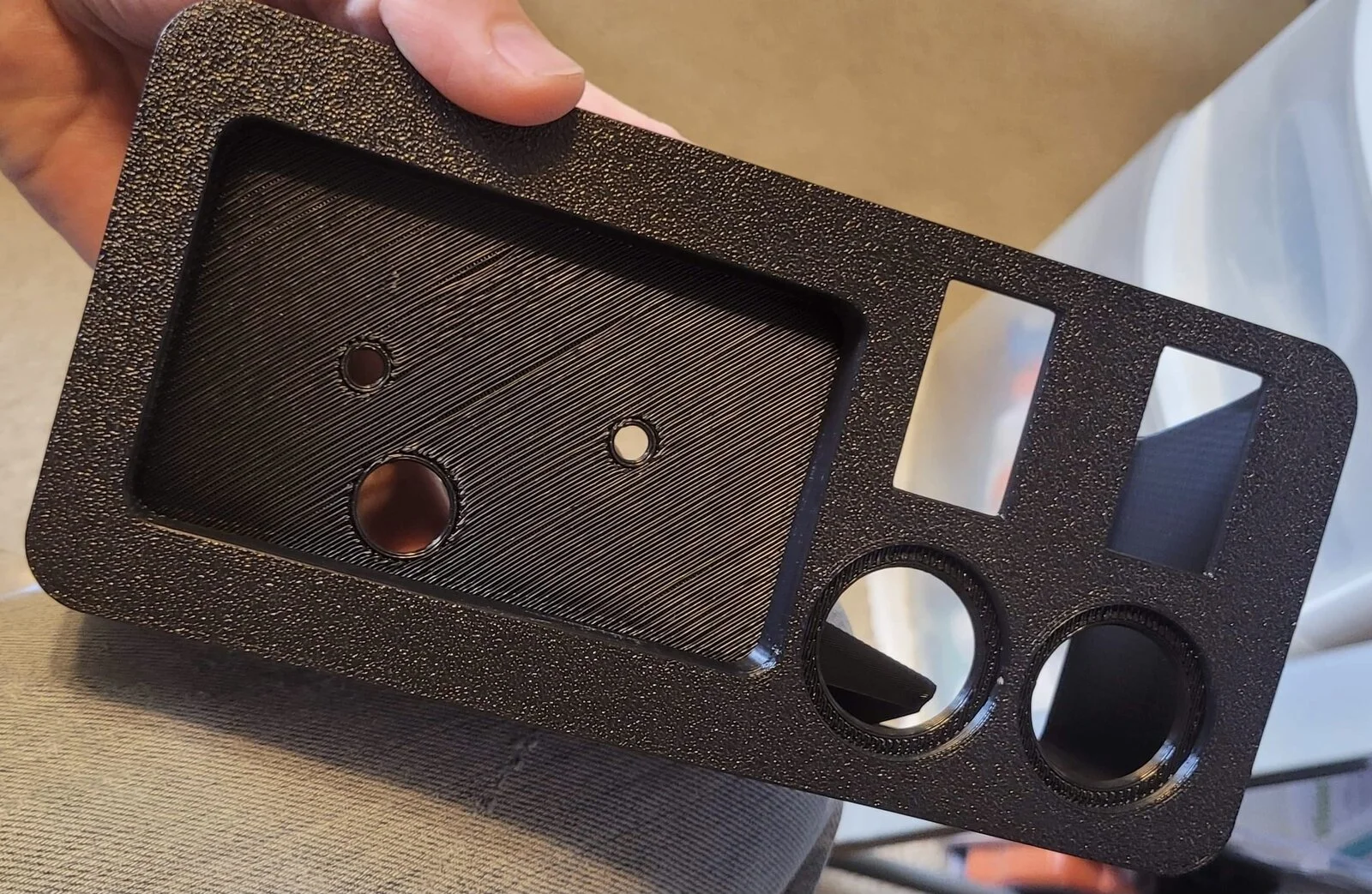

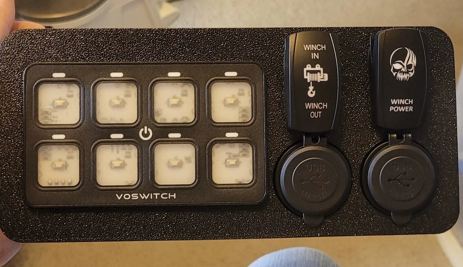

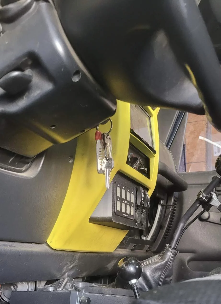

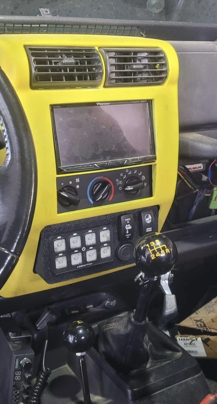

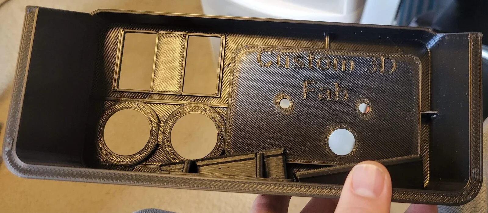

In Apr ‘21 purchased a custom switch panel from https://www.custom3dfab.com/ Figure 2 years is long enough should probably get it installed 😉. Actually not lot has been done as my brother moved and has been building a shop that he now has to point that can work comfortably in. It will hold a Voswitch, couple switches and charging ports (sent to vendor so could configure panel to them). Very happy with quality of product and how looks now that finally have it installed.
